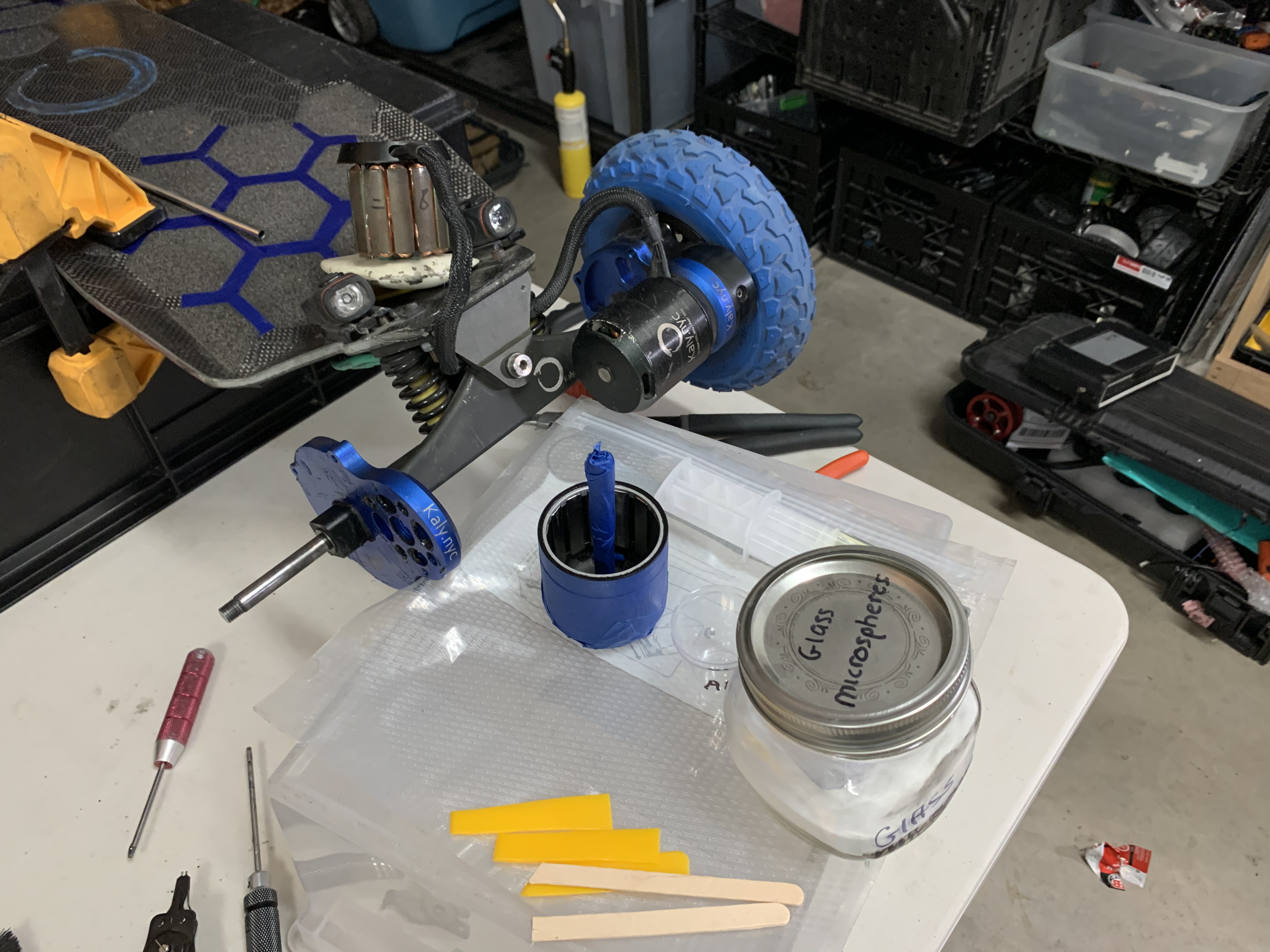

First I remove carefully most of the shrink tube
Then I glue the wires inside and outside, each wire is in touch with the epoxy putty and can’t move or twist anymore. From my experience this is the most important modification beside battle hardening.
I am thinking of battle hardening my maytechs with milliput at some point, which milliput variant is best?
I used superfine but it’s only available in white. The hardener is also white so you don’t see when it’s mixed properly, therefore it should be mixed for at least 7 minutes which sucks. I guess standard milliput is “fine” enough for battle hardening and it’s available in different colors. I’ll order the black one.

hi i’ve never batle hardened a motor, which epoxy would you recommend
Generic 5 minute epoxy such as Locktite or any other local brand.
@mmaner has a good video(Very informative video) he adds glass micro spheres to the epoxy in this case to thicken it up. But that depends on the viscosity of the epoxy.
