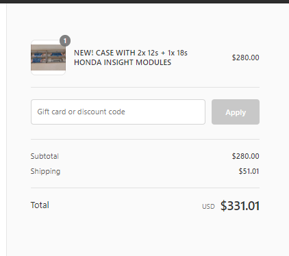

Except when you have $80 in shipping :smiling_face_with_three_hearts::heart_eyes: and most likely import taxes on top of it

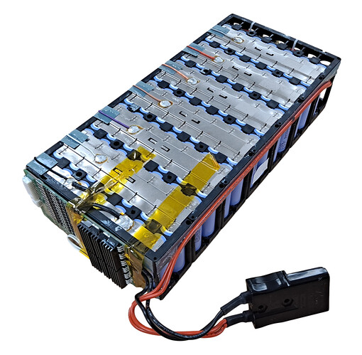

this looks very interesting, if you bypass discharge on that bms you could get 70 amps continues out of that battery and its just about prefect size for most top mount situations
Honestly that BMS looks pretty standard, I bet bypass would be easy.
22p cells are pretty old though and not great capacity. $100 though
Probably $50+ of shipping
yeah its not the best, but for 100 bucks…that’s a really good budget option. would probably get you close to 15miles on AT tires
True, 12" by 5" isn’t bad either

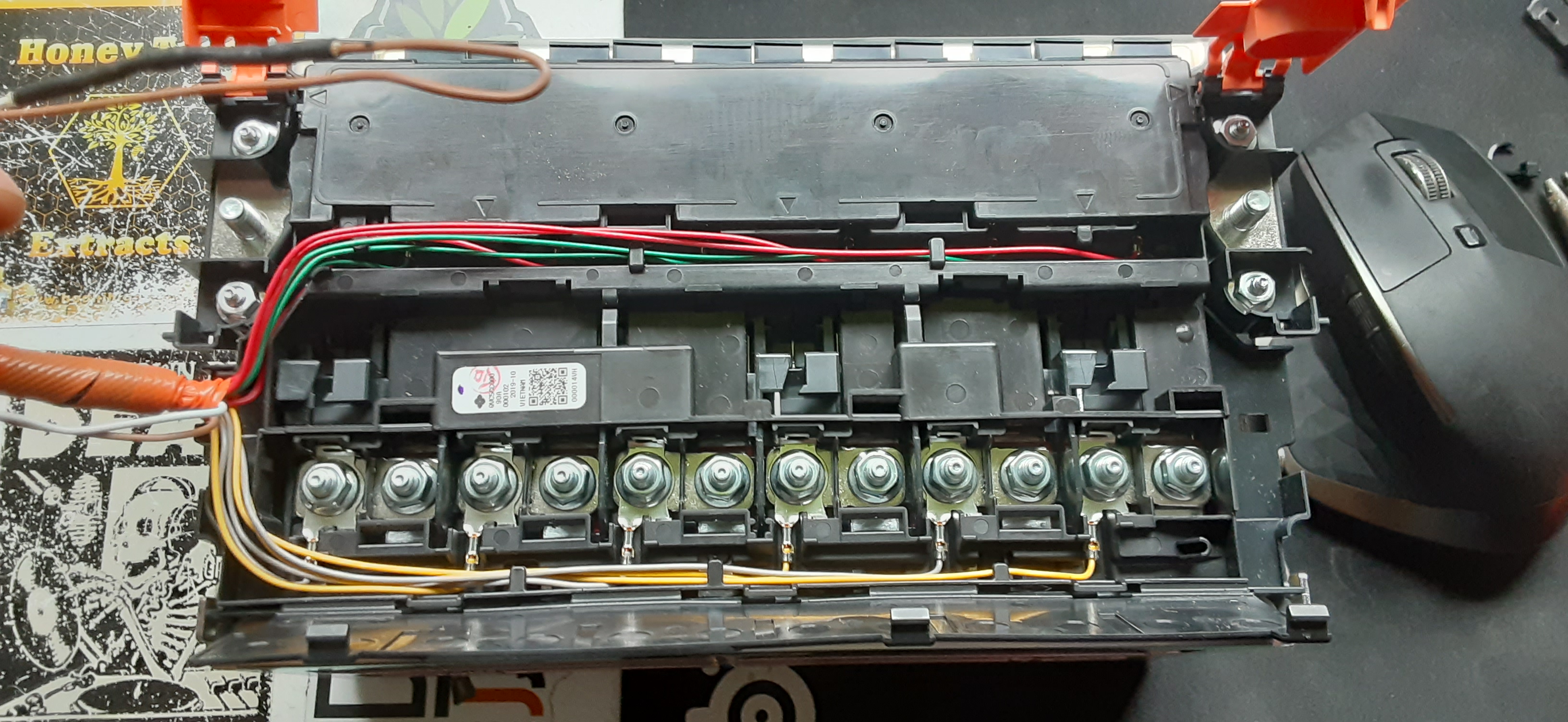

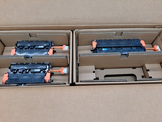

12S honda insight modules are pretty cool and tiny.
13 wires coming out that’s nice and easy.
5Ah is a little small I guess, they don’t weight a ton though.
the discharge rate compensate for it tho 60c right? You could use them as a spot welder battery even tho you can have lipos for cheaper and the same ratings.
edit: power wheel mod :crazy_face: :joy:?
yeah they can disassemble apparently but their construction is really nice so I would want to use one intact at least. Made in vietnam apparently.
Seem good for an ebike maybe.
Would be nice if they color coded the wires instead of using 3 gray, yellow red and green.
bet they are super well matched so I could use without a BMS.

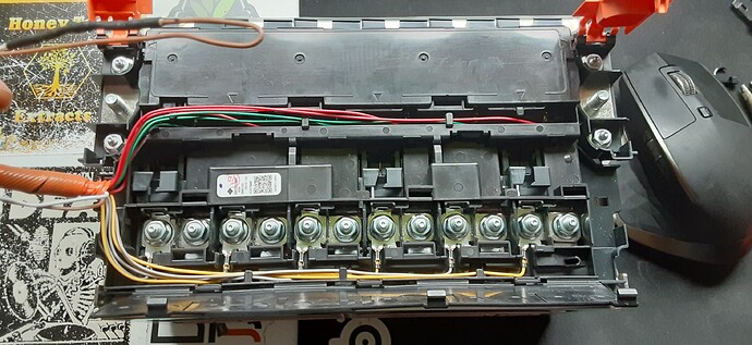

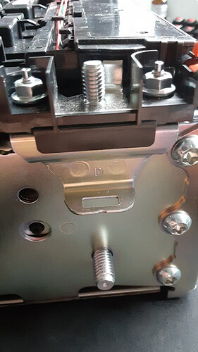

almost looks like the main + - terminals get attached to the case by this weird bent piece.
huh yeah guess the screws on either side are not connected to the center terminal
wonder what thread that post is too maybe m6?
yeaaaah seems more like they might hold the battery together/ be part of the case.
and you can mesure the threads with a caliper top of one thread to the top of the one right after it if it’s metric (wich it should be because ahem ahem international mesurements lol) then easy you should get 1.00 up to 2.75 mm in this case at least, my guess is 1.00mm threads.
good idea I measured it, seems to be m6x1mm pitch
