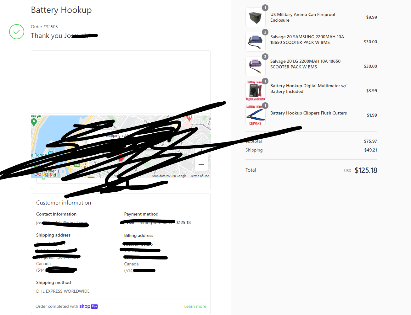

BatteryHookup.com are we talking about this?
Oof lol it will be very soon.
Hopefully you didn’t miss the deal while I didn’t have service.
I’m excited because now I’ll have a second one of these 880Wh batteries. I’ll strip one down to minimal weight and size, the other leave intact with the watercooling loop.
Gonna make a proper watercooled ESK8 once I get the right motor.
Might have to end up being an Ebike…
