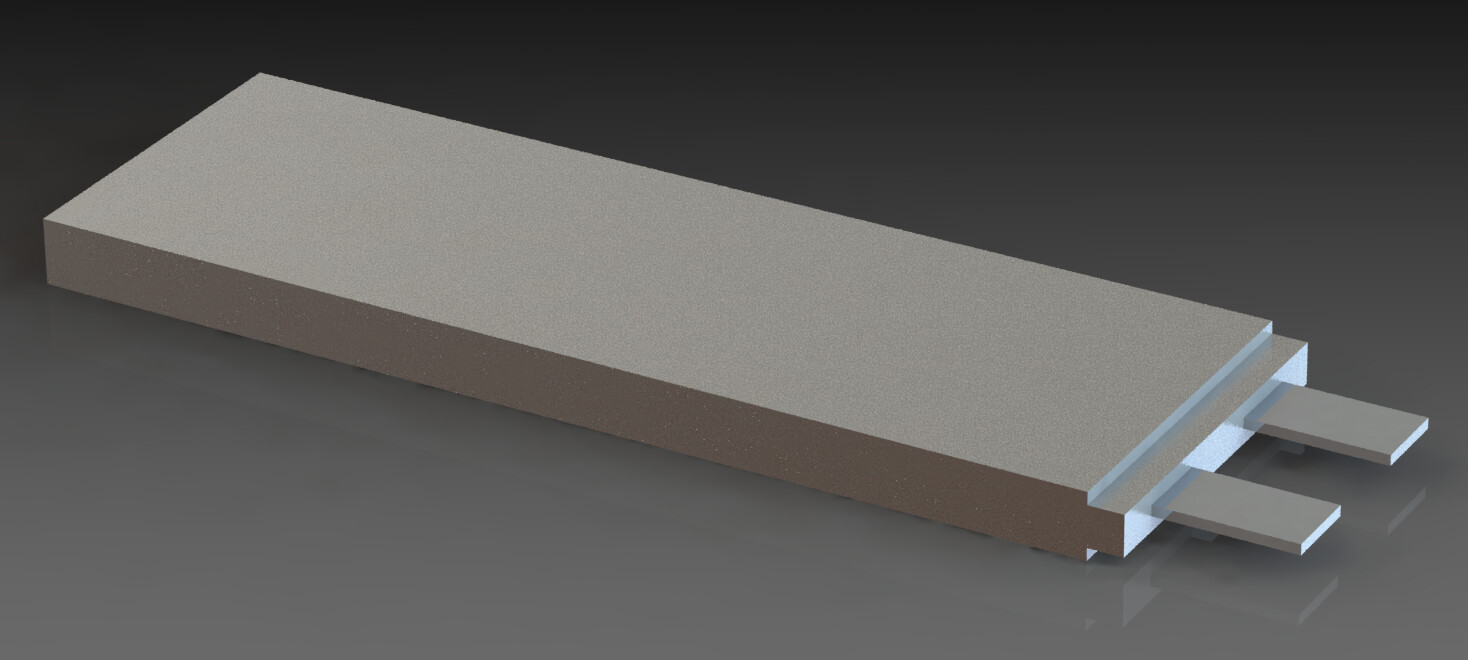

200A discharge 3.7V 8AH flat pouch lithium ion cells
I made some guides for using the TE foil crimps here, just select to show only my posts you will see.
Thanks for the link, that circuit board will hopefully be a good way to use these cells.
50C is over 300A and, IMO, is a spectacularly exaggerated rating but you can probably pulse them pretty darn hard and not have to deal with too much voltage sag and heating.
Would love to know what their cycle life is. LOL…no one ever seems to care about that. I guess as long as the pack runs for a while it’s not a big issue for the price. Personally, I rather pay more and not need to replace the pack for years but I think I am in the minority regarding that. …end whining…
I love the idea of using those TERMI-FOIL connectors but I’m not sure how they can be nicely isolated from bouncing around in use and snapping the tabs. I guess lots of foam would need to be involved.
Hmm…or a clever little PCB with tabs the barrels can slide onto and then get soldered? Probably too hard to get a good current rating that way though without a silly large PCB.
