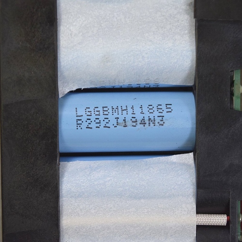

Lol we decided to go 12s due to space constraints
Got the cells today:
I also made a disassembly guide for them:
