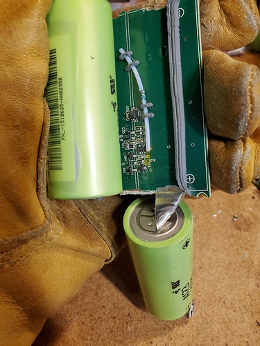

The next part is a bit more difficult and takes some more precise maneuvers. Start by picking one of the sets of cells. Essentially what you want to do is break the nickel off of the battery pcb at one end of the two batteries.
You can see that right where the board broke, the end of the nickel can easily be grabbed with pliers and peeled off the board. Don’t peel the nickel off the battery terminal yet. See below:
After peeling the strips out of the battery pcb, you can lift each cell up individually to pull it off the other side. This is where caution needs to be used. On A123 cells, the large flat side (positive, they’re opposite of 18650’s) is VEERY thin. You must be extremely careful because if you pull off the nickel incorrectly, it will tear through the metal and put a pinhole into the cell. Because A123 cells are so safe, nothing will happen, but it isn’t recommended to use a cell if you put a pinhole in the positive terminal.
On the smaller side with the center terminal, you don’t need to be as careful because the metal is thicker. On the smaller side, you can usually use the pcb to rip the nickel off the end of the cell, however, if the nickel breaks off the board, no worries because it is easy to remove later.
On the larger flat side, you MUST use a twisting motion to create horizontal shear forces in the nickel spot weld. By using this method and twisting slowly, you can break off the nickel attachment without puncturing the cell. If you pull away from the cell, causing tension in the metal, it will likely rip through. Out of the 32 cells I’ve taken out so far, I accidentally tore 4 of them. The first two were in the first pack as I was learning, the others were because I tried to do it too quickly.

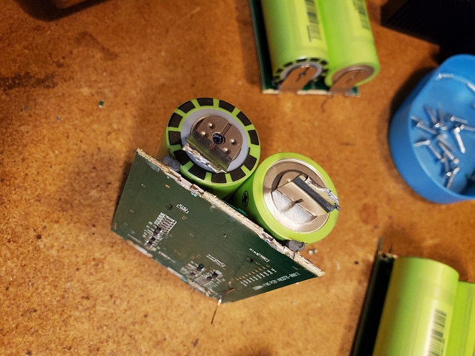

Repeat this same process with the other three sets of two cells. At this point, you’ll have a bunch of free cells, some of which will still have nickel on the ends. These are the ends that you pulled off the pcb earlier. It turns out that this part is actually easier. Using a set of normal pliers, the rest of the nickel can pretty easily be removed.
For the large side, again, you want to use a twisting motion to remove the nickel. Grip the strip as close to the cell as possible, and slowly twist it left and right, with the axis of the cell. You should be able to pop off all four of the connections.
On the smaller end, grip extremely close to the cell on the nickel. Now, holding firmly, use the cell top as a lever to rip the nickel off. In the picture, imagine the pliers traveling to the left and down. It is pretty simple once you do it a few times. After you break off the first two spot welds, re-grip close to the metal again and lever the last two off. The motion is kind of like a roll-peel action.
