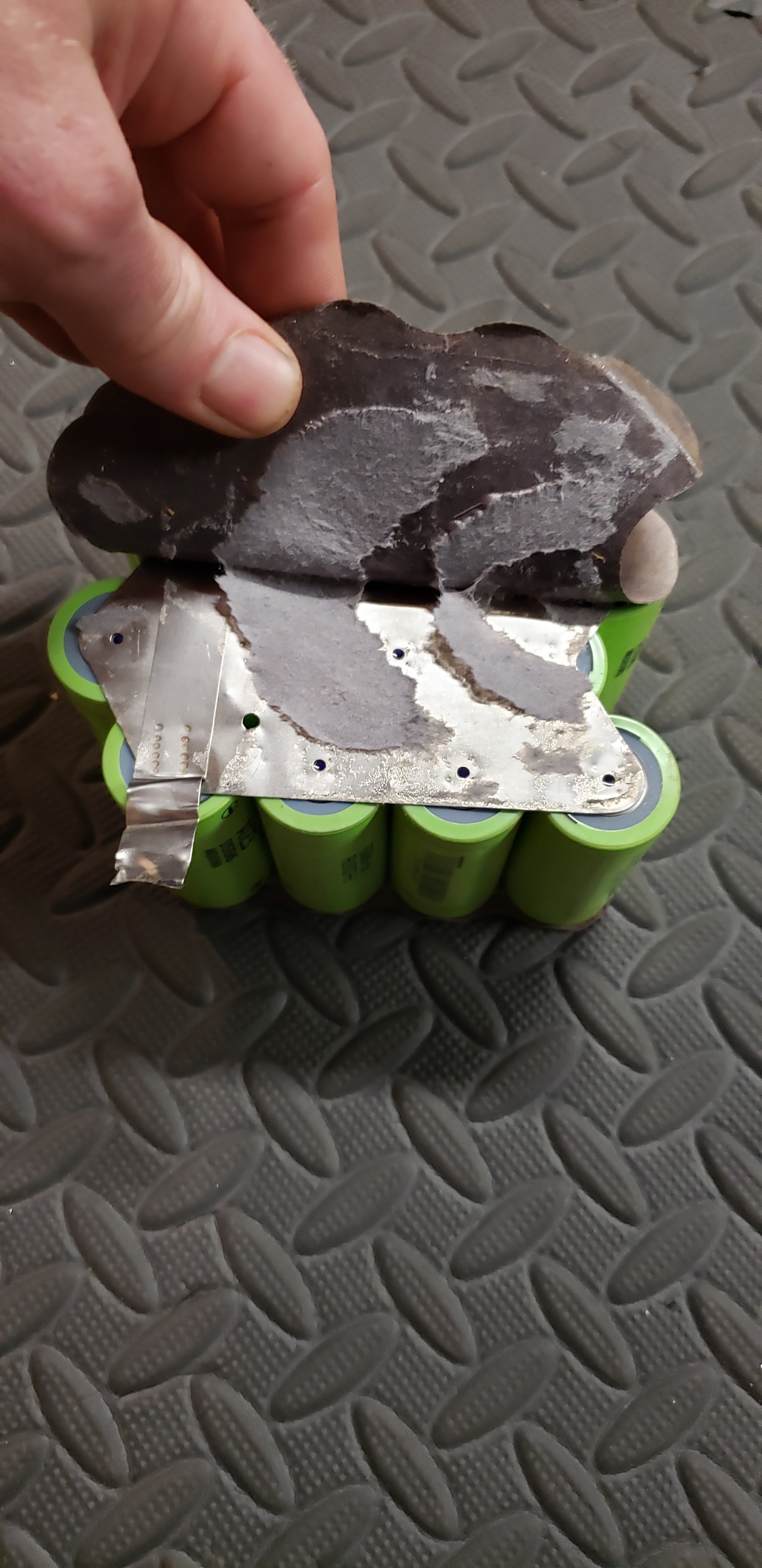

I’m sure you guys figured this out by now, and apologies if I’m repeating (just sort of skim read the OP), but at least with the A model cells (I’ve got lots of those on hand) the positive side is connected to the case of these cells and the wrappers are pretty fragile. It’s easy when prying nickel on the negative side to short against the corner of the case if you lever against it, and these things can dump crazy amps, so keep that in mind when the sparks fly!
I’ve reclaimed these from packs in 12 and 16p groups with continuous nickel, gotta be carefull to peel the nickel back rolling up on itself on the neg side first then stripping the positive side is easy.
I haven’t run into too much of the end perforation probs, EMC must have welded the shit out of these? Did you guys consider just cutting the tabs an leaving the nickel on? Would give you something easy to weld/solder too anyway since you can get at them pretty easy it looks like with side-arm cutters?

With the method I suggested, you don’t pry against the case. I didn’t have any issues with breaking the wrapping on the cells.

Yeah man, I was describing the packs I disassembled in terms of rolling the nickel back on itself prying away, they were in large tightly packed P groups, no boards. Just adding to the A123 info here is all. Not critiquing your methods bro!

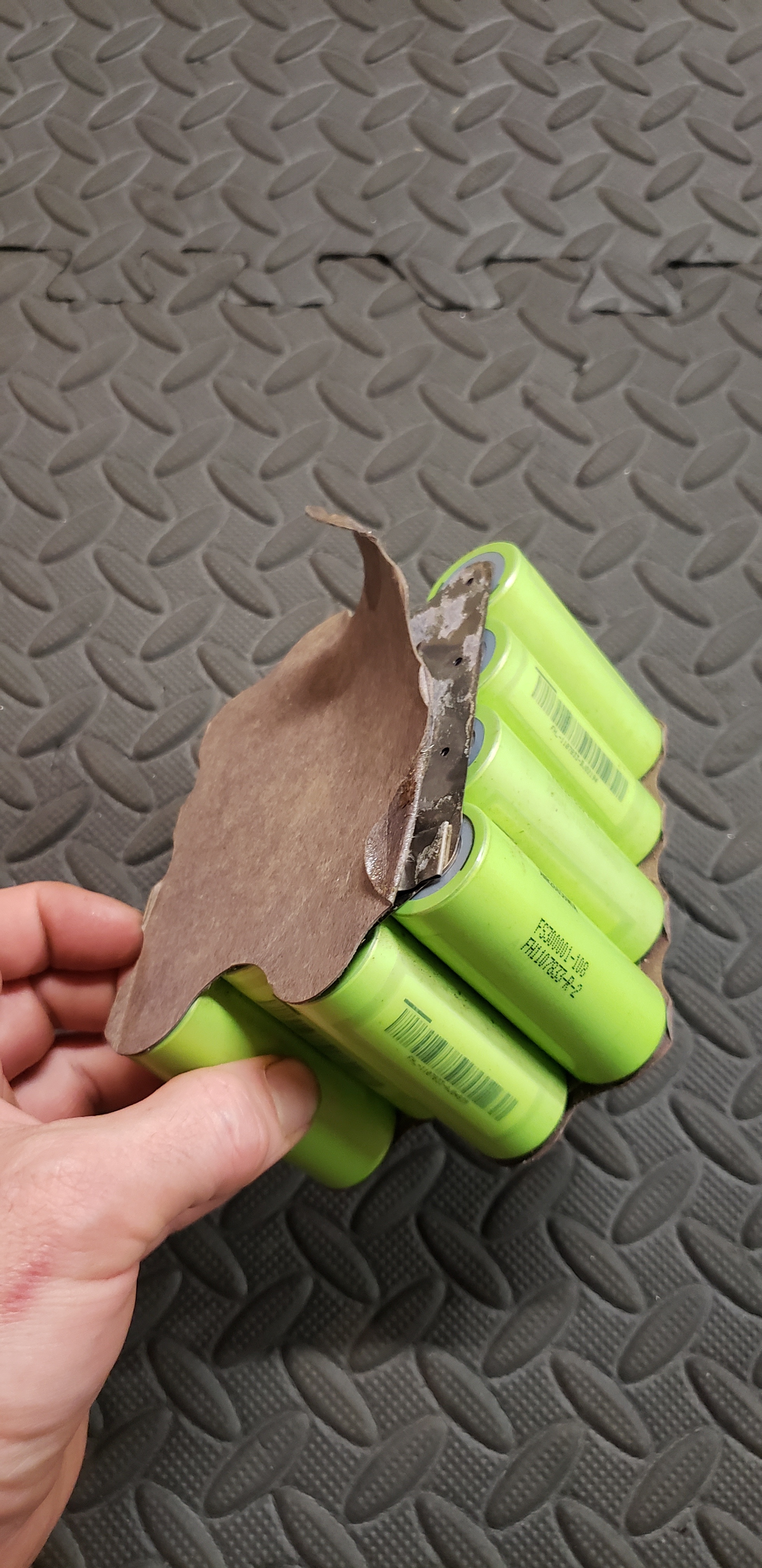

Here’s what the groups I’m talking about look like, these are from EON packs.

Oh boy haha that’s a different animal

I found it really hard to break the tab off the pcb without shorting the tool on the outside of the cell. had it happen with like 3/8 of the first pack I just did. The solution is to reall tear up the PCB carefully just enough to be able to rip the tab the not too much where the side cutters touch the cell.
Great to hear it helped someone! Yeah it was always easiest when you break it right against the tab so the tab basically falls off of it. Exactly what tool you use makes a difference too, one of the pliers I had worked way worse than another pair
