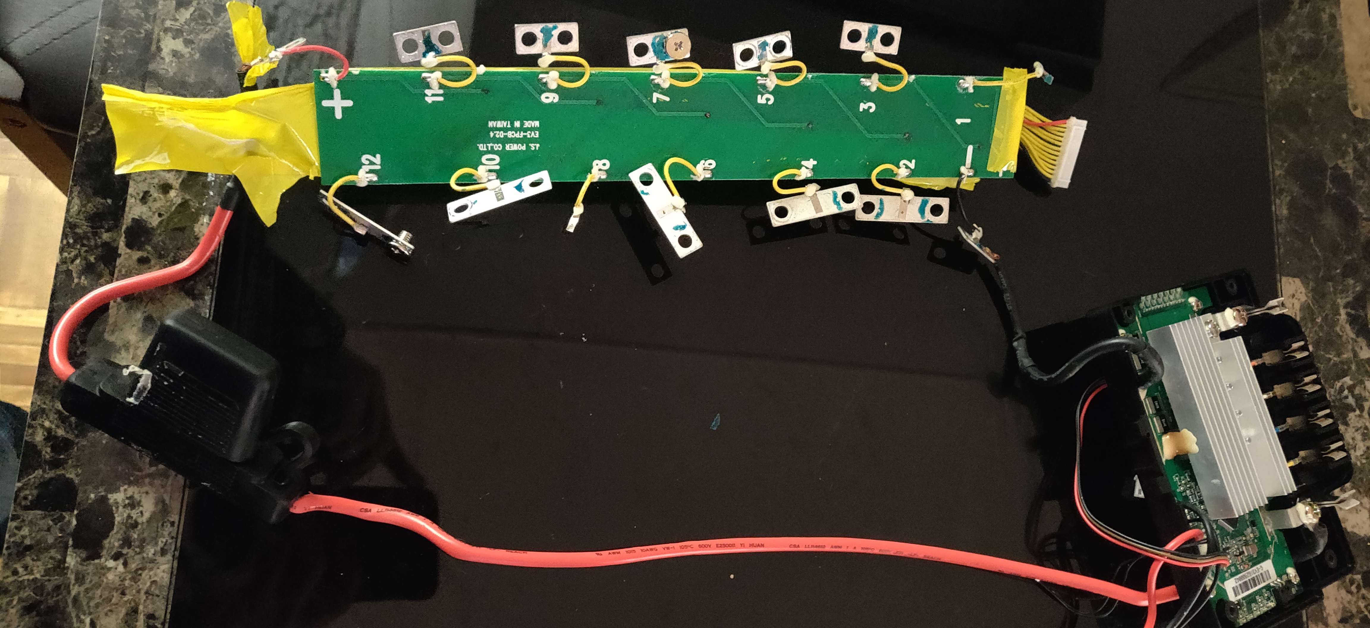

this is the chip on the BMS if anyone is interested or familiar with it

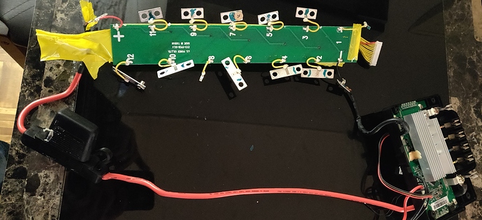

Talked my buddy into buying one of these last night for an ebike. @Scepterr from what you can tell, will I be good just tapping into the pack+ and pack- pins, and ignoring the pins in the middle? Or should I plan on busting this bad boy open and wiring my own BMS in?
I’m not sure if full current discharge is possible directly, there’s something on the machine side it plugs into that ā€œactivatesā€ discharge on the BMS, might just need a resistor across 2 pins
to plug in another BMS is SUPER simple, just plug in balance lead to new BMS and transfer B-, B+
assuming pin direction and pitch is the same,if not just repin
Gotchya, thanks for the pictures! Do you have any plans to poke around and test the built in BMS for us lazy folks? :joy:
yeah when the next batch of these come I’ll play with the bms

so after glancing at the BMS IC schematics, I’m pretty sure I know how to enable discharge😁
