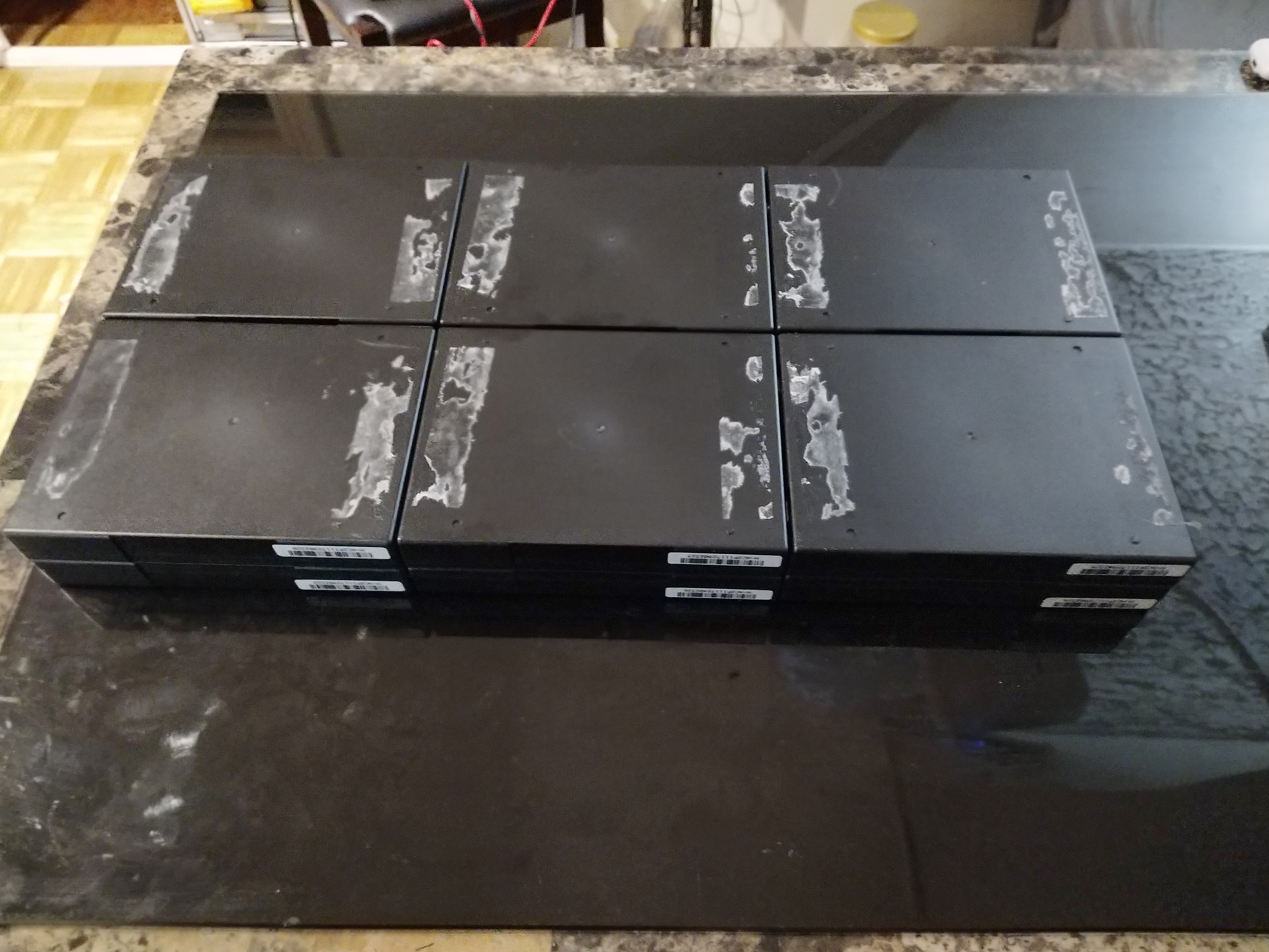

Battery Clearing House SV-BA10 13s 20Ah Battery
I was planning on using a DC to dc booster to charge mine.
I have one that goes up to “120V”
I could do that too but for the purposes of testing I wanna be able to monitor usage and that’ll screw it up

Cell @3.72V , 7.4Ah in
thats alot of capacity…
I won’t be surprised if it’s 18-19Ah
That is actually really impressive if this cell really can prove itself 2p would be awesome
indeed, size is really the issue with using them on boards unless you’re making a brick or lining the bottom of a trampa
For a large top mounted board could be good or for someone who want to take the parallel groups apart and rearrange it
How tall is each parallel group
that’s each cell
K could be arranged to be an under board battery in something like a lacroix or something else like an evo enclosure
you would want 12s2p to get 90A discharge, it’s gonna be heavy
12s1p weighs 13.6lbs
just the cells
Still awesome
Maybe 3p/4p half bottom mounted and half top mounted
