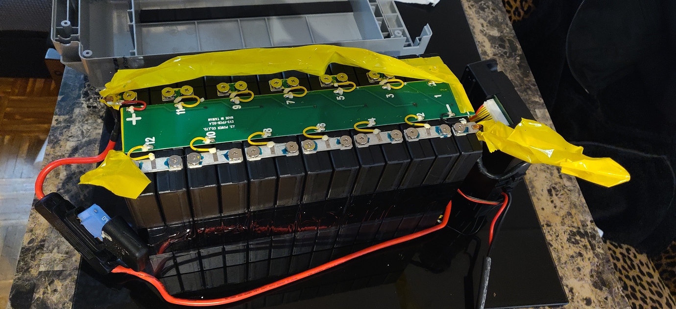

Seems like shorting the two other pins limits the current to something super low. Seems like it’s time to bypass discharge.
Hmm at least we know these things were really just barely used.
I do really wish I got two instead of just one. 2KWh easy top mount + 1500Wh internal would be insane.
I believe the discharge works if it’s plugged in after it’s turned on
if anybody needs a stoba shell or BMS or both, let me now I’ve got a few spares, $20 + ship
I tried both combinations, but even though it worked, it was throttling the current (BMS made a clicking sound). I now just bypassed discharge and it works just fine. These ebike controllers have fairly conservative LVC anyways.
what current were you trying to pull?
Close to nothing. I was using a 26A rated ebike kit controller (AFAIK their ratings are for peak :rofl:)
And just spinning the wheel with no load.

For me It only shut off when it was connected to any load on startup. If you turn the battery on with your switch, and then connect it to your load it’ll remain on.
I did that. And it remained on, but heavily current-limiting. It’s now bypassed, but the switch for charge-activation is still neat. :slight_smile:

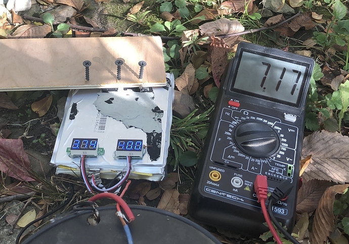

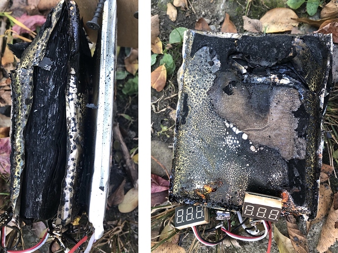

I just did a puncture test with 2 charged cells (one 4.2v top and the other 3.8v bottom)and Stoba doesn’t mean safe lol. Kinda blew up in my face.
Tested with a 0.8 Ohm load to show how they react when punctured under load. I also re-wired the module in series so the load was double what the cells would see in the normal configuration.
At 7.2v ; (7.2V)/0.8010Ohms = 8.98 amps
At 5v it’s still running 6 amps through the cells.
The bottom cell doesn’t seem to have ruptured but it didn’t react when I punctured it after.
When the cell stopped smoking I temped it at 545F (285C)
