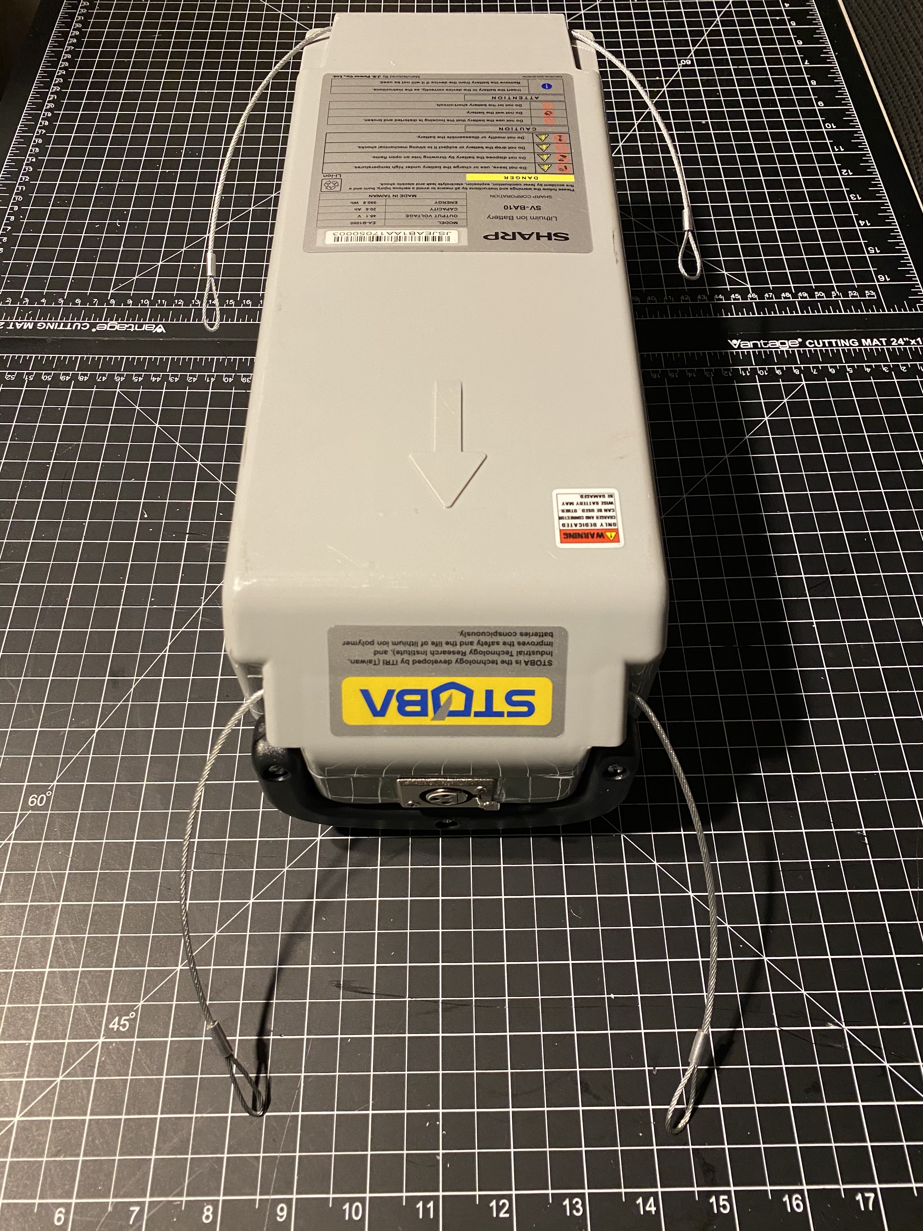

Still need to make this giant battery usable…

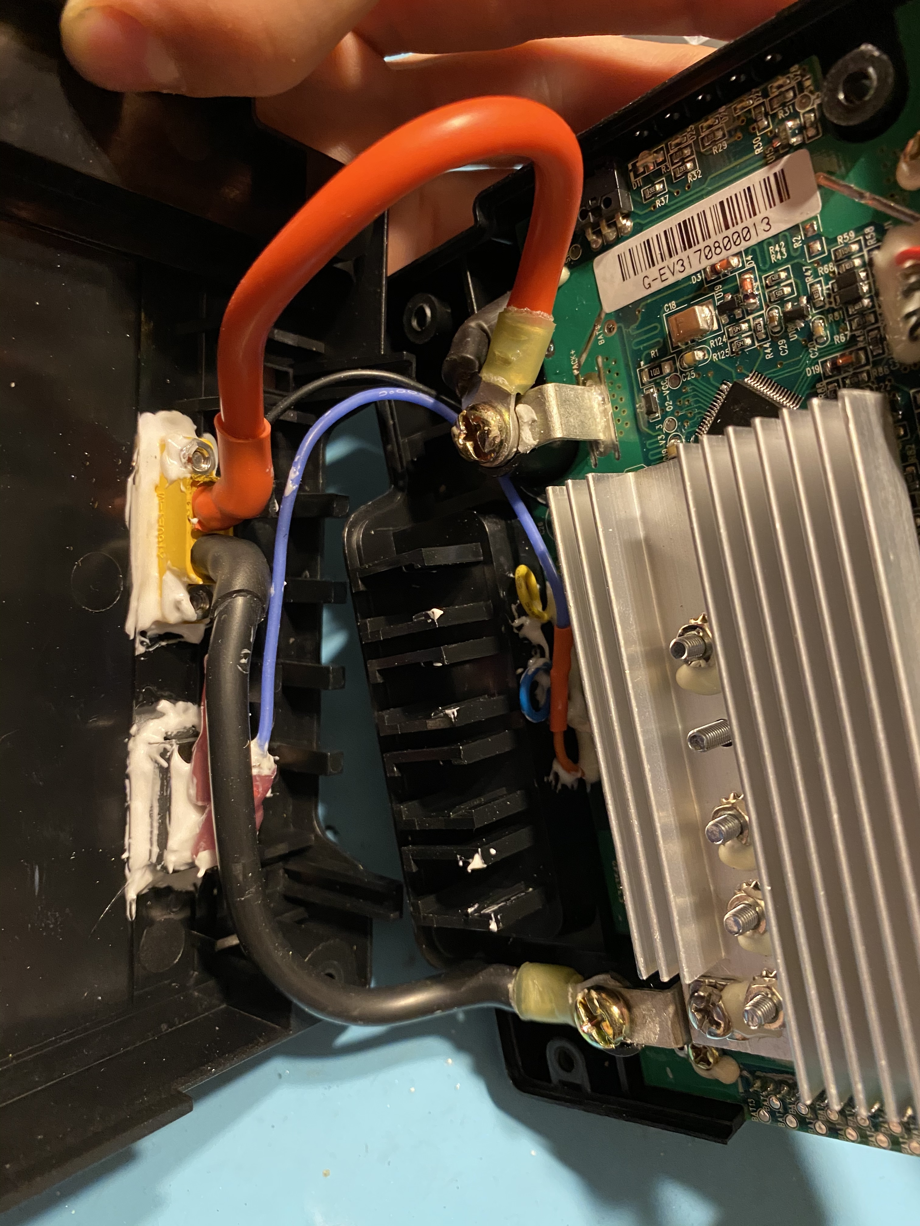

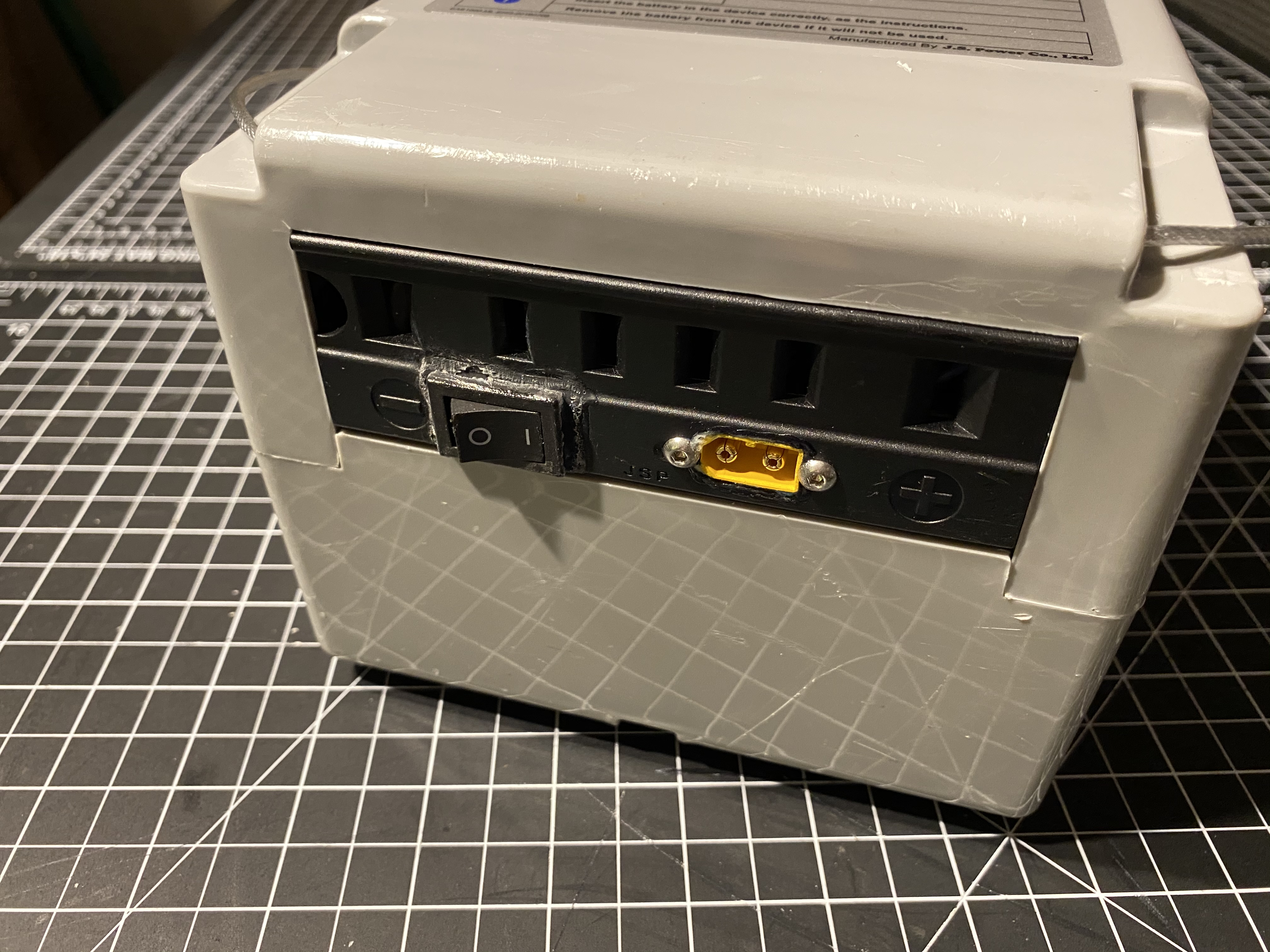

@Scepterr you were correct on the pins to enable charge/discharge. But there must be a overly sensitive short circuit sensing circuit, because if a single VESC is connected when you turn it on, it immediately turns back off. But if you turn it on and then connect it to the vesc it works fine.

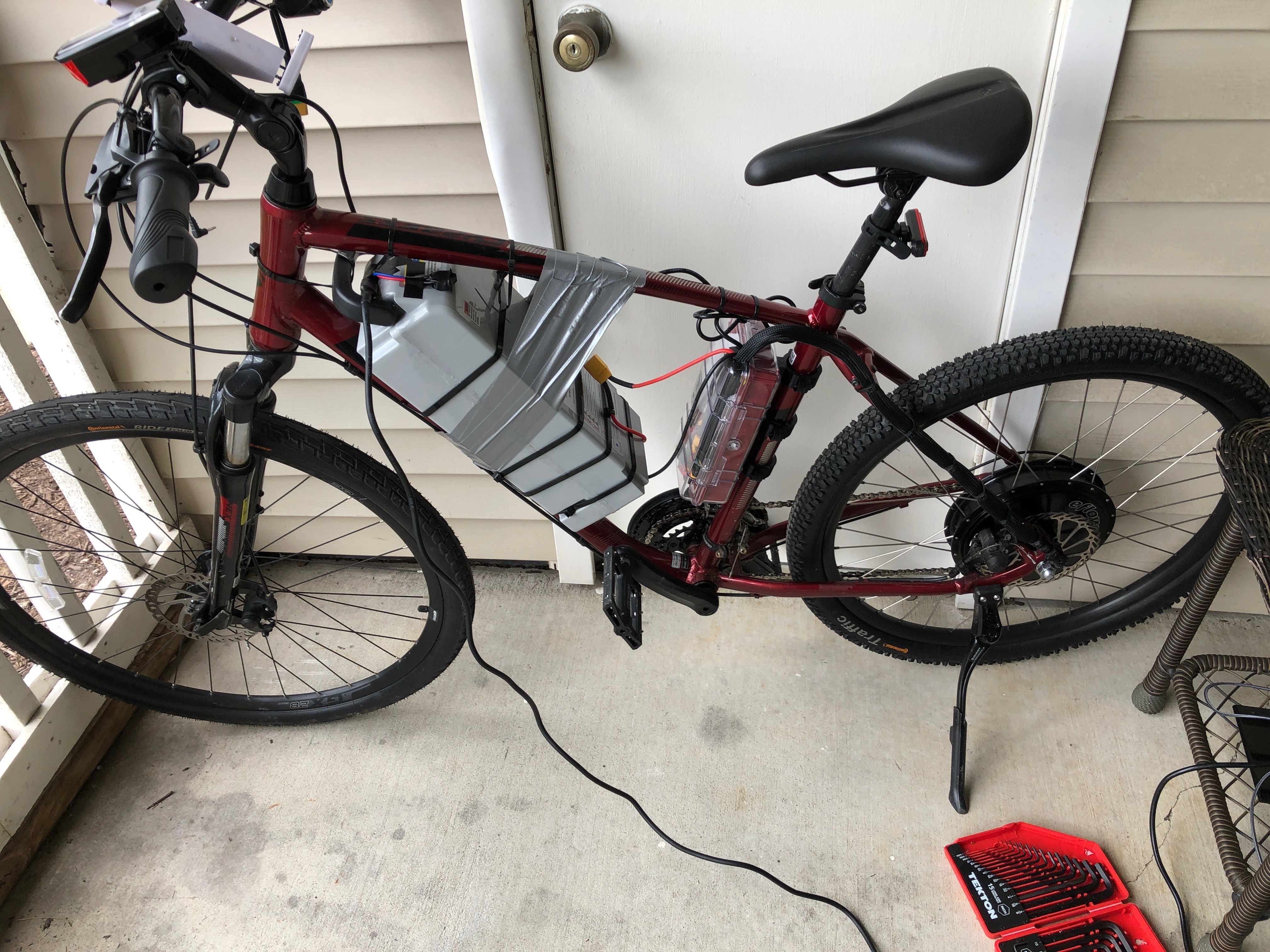

Was able to remove the XLR port, and wire a switch and charge plug to the hole, and Bypassed the BMS for the output leads. Then tossed it on my brothers ebike and it’s been working great. He was able to get a nice 40 mile range out of the pack.

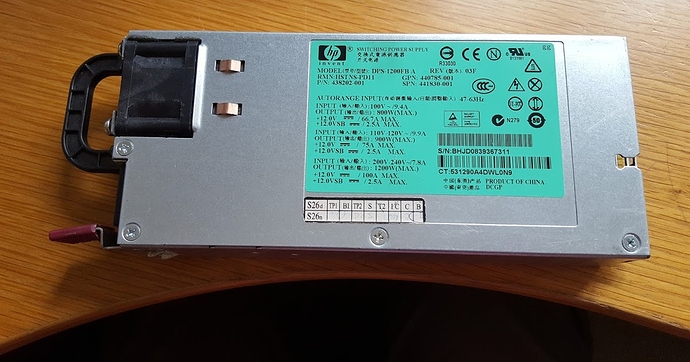

Get an HP dps-1200 server PSU and a boost Converter:
Details on the psu:

I just hacked mine:
But now I have the same issue as you had - Controller switching off after a second or two.
I wish I had read your post before doing all this work.
Now I wonder if I am better off bypassing the BMS or trying to add a second switch. How many amps were you able to pull through the BMS?
Did @Scepterr have success with discharge through the BMS?
