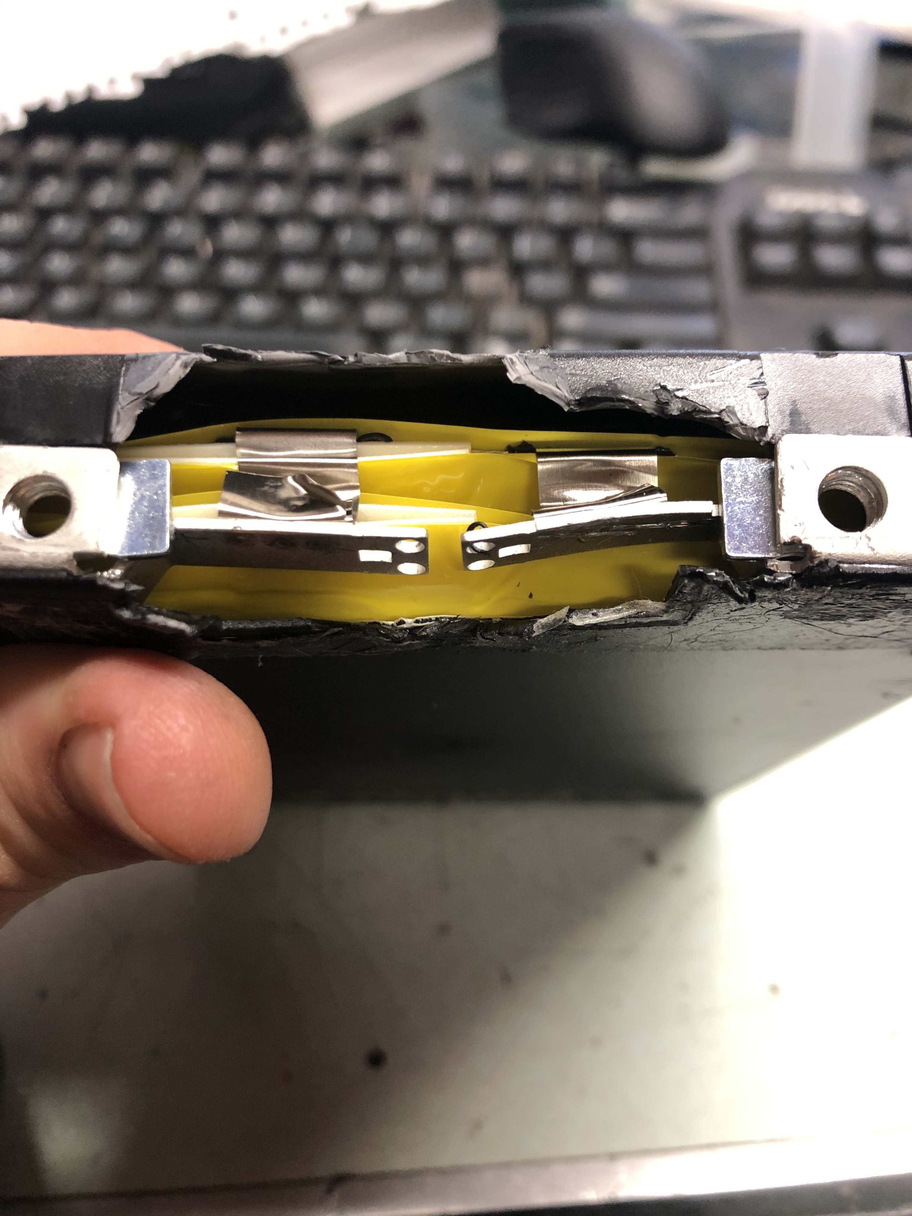

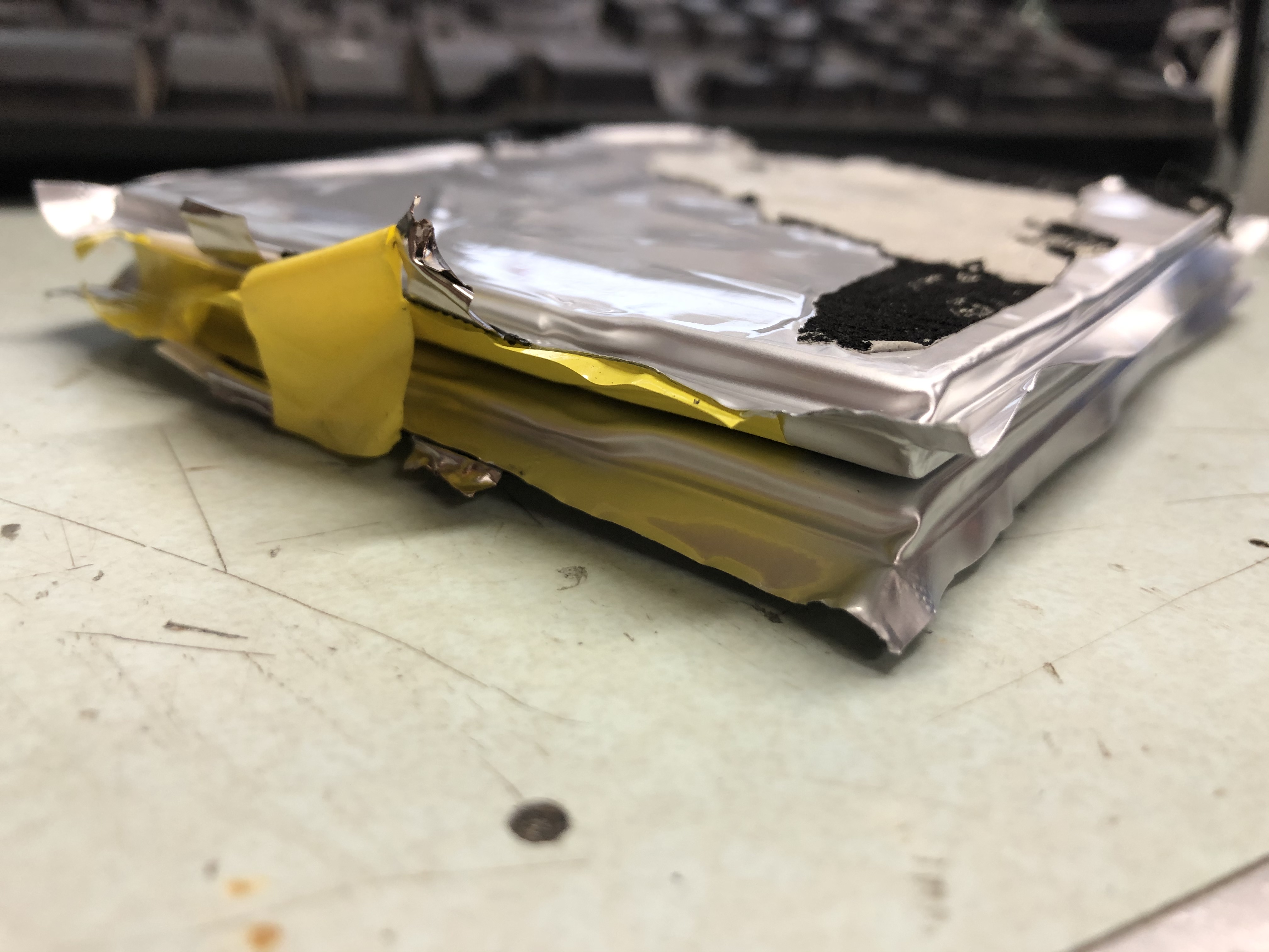

Just took apart one of the cells today. So there are two pouches in each black box making it a 13s 2p configuration.
how was the process to take em out? how destructive is it?
Very destructive, I definitely damaged the internal laminations getting them out. They have double sided tape on both sides of each cell, and the black plastic seemed to be either glued or plastic welded together so It doesn’t open easily. It might be easier if you warm them up before but not worth the effort.
Now i think I’m going to over charge them and see what this STOBA can do when punctured :sunglasses:.
