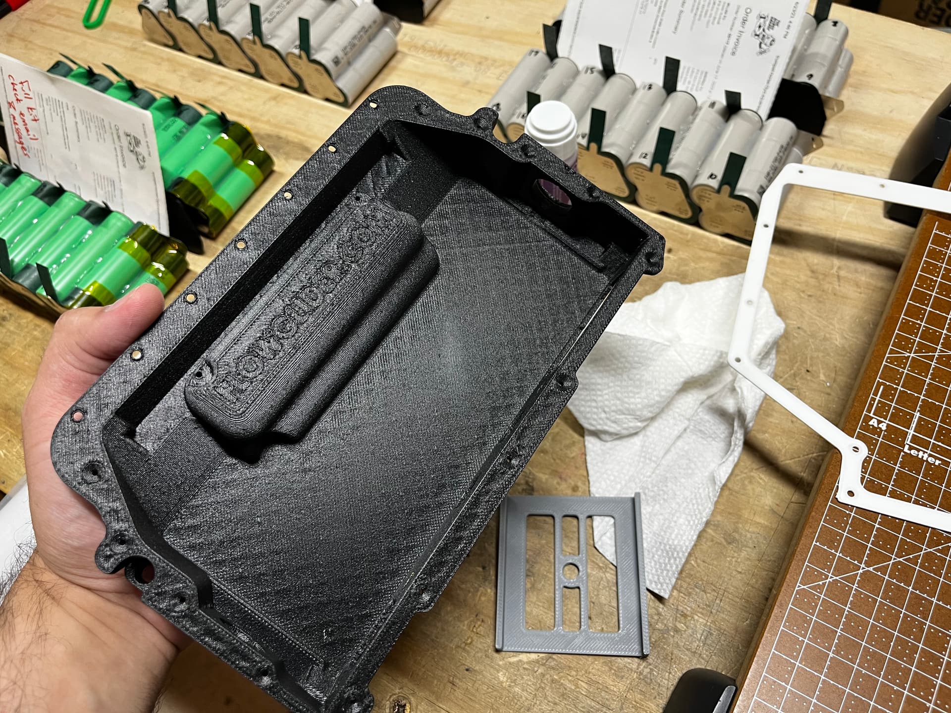

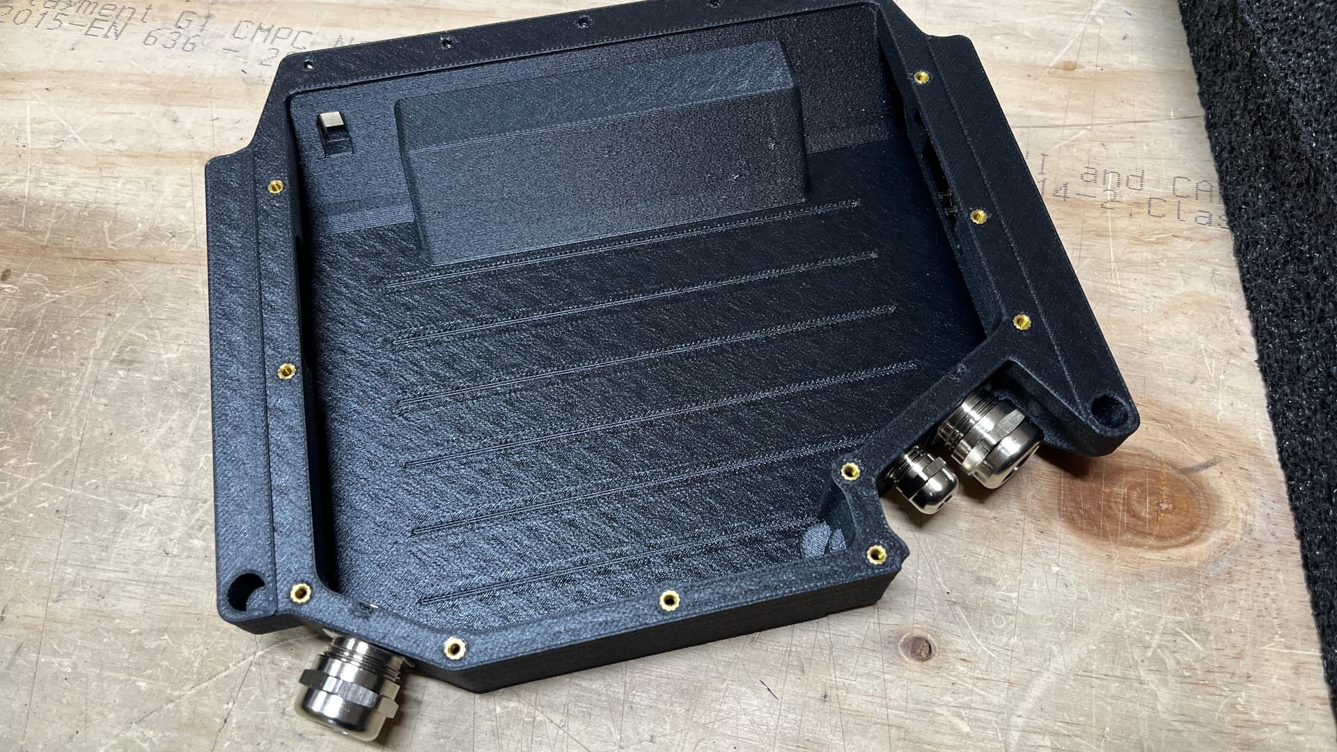

I keep the PAHT-CF and the Support for PA materials in the dryer at 70C for days before using it. Usually, it just stays in there until I need to print with it. So it can be drying for a week sometimes.
The PAHT takes on water more slowly than the older PA-CF, since it’s Nylon 12.

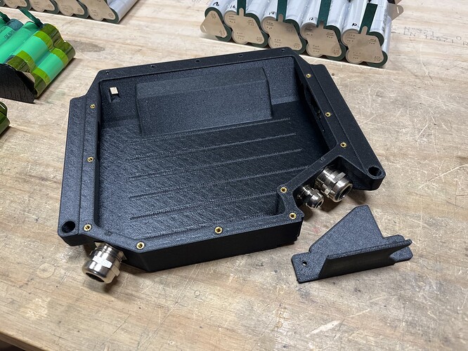

I like it, it prints well enough, and works for the enclosures I make with it.
@TheBoardGarage, thanks for sharing. Some nice results there.
I’ve been studying a lot of PA results from the X1 vs other printers and I think that while the X1 can do it, the results are not as good as other printers with actively heated chambers. There is a rumour/hope that BL will have active chamber heating in some future printer. The PA results from the Qidi printers, for example, look really nice.
Wow! That print looks really nice. I would love to see an entire enclosure made like that!
My assumption is that the PAHT-CF replaced the PA-CF specifically because of how it prints. Nylon 12 I’ve read is generally easier, and the CF fill is coincidentally a convenient thing to stiffen the print up.
Others may do it better, but the enclosure stays at 48-50C during these prints (11-14 hours), and the Bambu is the only one that can print with both the PAHT-CF and a support material, which these things need. There are large flat overhangs, and the support material comes off very nicely in most cases.
