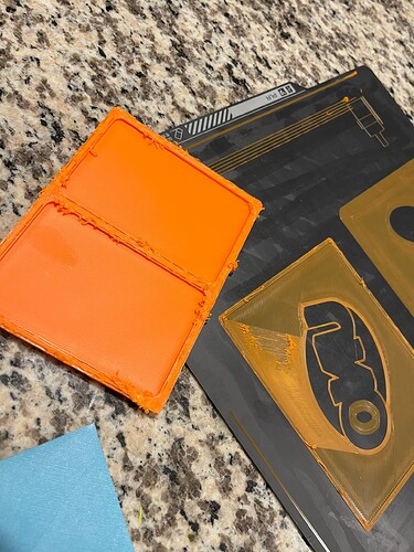

Blobs, anyone know what’s going on here?
What filament is that?
Bambu brand pla
Did you dry this filament before using it?
You using the bambu pla profile? What temperature? I had this happen one time with silk PLA
Yes, I had a solid print with the same stuff.
220 temp
Pla plate
It just globs up at the start of a run and fucks everything
Are you running bed leveling and calibration before print? Almost looks like the z offset is too low but first layers look ok. I’ve got a roll of bambu PETG that’s being a little bitchy too right now
Is your build plate completely flat? I’ve got a couple bubbles in my cool sheet that cause issues.
Yeah I read up on all that too. The answer ended up being that pla will eventually clog nozzles sometimes because some filaments leave behinds small particles in the nozzle. I replaced the nozzle and it was good as new. Next time this happens, I’ll know what’s going on so I’ll just attempt to clean the nozzle.
