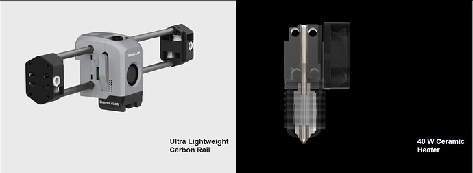

Can you post a picture of what the mounting interface with hot end unit and the extruder looks like?
What does this interface look like.
34$ for a complete all metal hotend with thermistors installed is unreal.
https://us.store.bambulab.com/products/all-metal-hot-end-with-hardened-steel-nozzle-0-4mm
This what you wanted to see?
Yeah I don’t even mind the proprietary part at such a low price.
