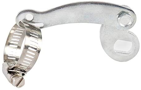

Did we ever find a good torque arm solution? There was a lot of confusion at one point…
I just got a super crap one. the ebikeling one on amazon is good I bet
Forgot to get a refund… Not my amazon account so kinda hard
I just got mine in. This is the link. Seems decent quality, fit is a little loose, but it will work. I wouldn’t run a 3000w motor with it, but for a 500w hub it’s fiiiiiine. I got it pretty fast.
Edit: amazon reviews confirm that the material is suited only for 1000w or less. It seems like stainless steel to me, so that makes sense. If you need an arm for 1000w or more, you should use two or make something custom from carbon steel or titanium.

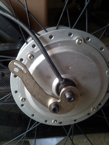

I got the EBikeling one, easy to drill if needed,

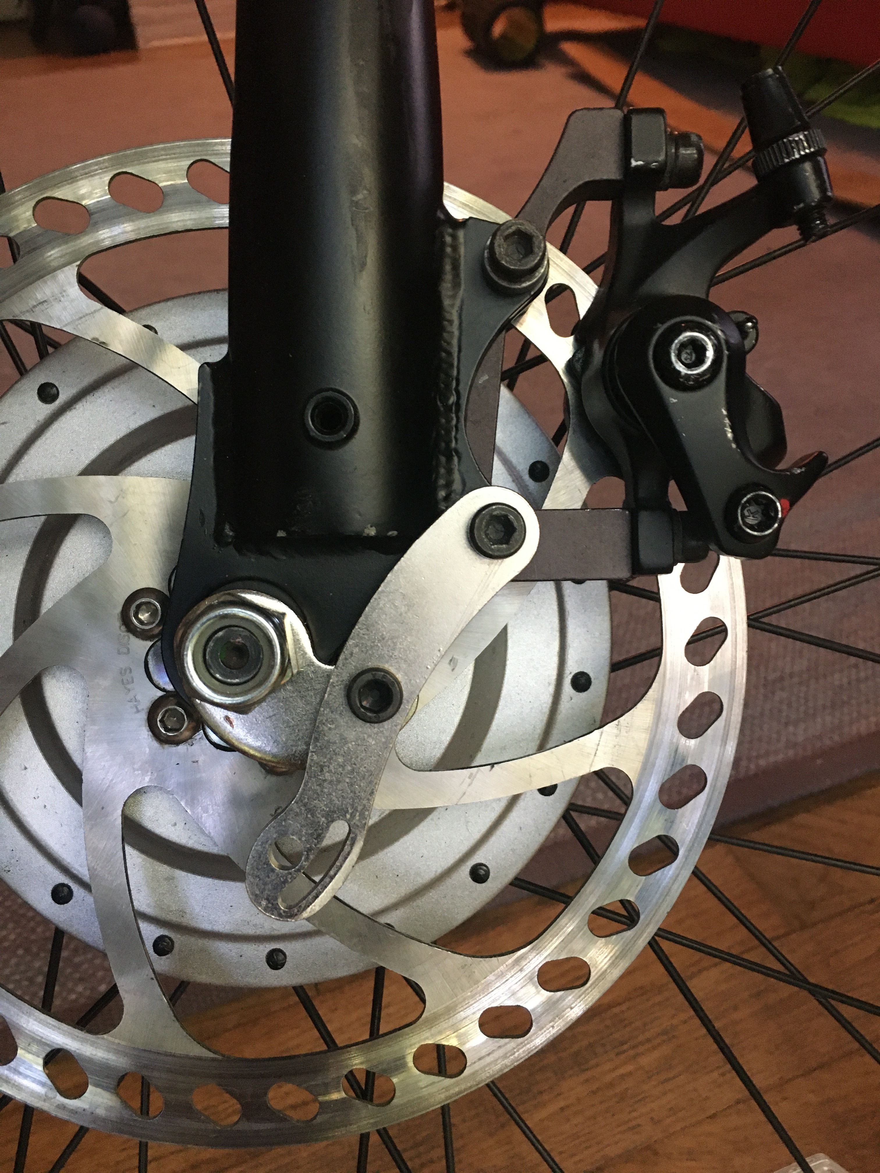

ooh, I like the shorter arm mod. I might have to pony up for a fork like that . I’m really trying not to use the hose clamp :joy:
yeh, I couldn’t get the forks I had to work so got these ones, was stoked that I could use the disk mount hole instead of the hose clamp, this is not a hose!

I finally finished converting 4 different bikes. 2 of my bikes were converted using the BCH hub wheels with parts from PSWPower, and the other 2 of my bikes were converted with full conversion kits from EBikeling. All of them works good, but I do like the rear-wheel hub drive feel better than front wheel drive BCH hubs.
Of course the BCH hubs with parts from PSWPower were half price, but my other two bikes didn’t have front disc breaks (and one of the bike was a 20" folding bike, so didn’t want to re-lace the motor into smaller wheels either), and I didn’t feel like changing out the front forks. Wish the BCH hubs has dual wall rim compatible with rim brakes also, but hey, it’s a cheap enough price to play around with to convert. It got me interested in EBikes finally.

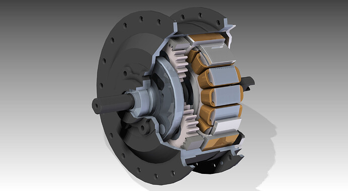

I will check how close this model is. Looks good, gears/clutch looks the same.
nope, not the same at at.
