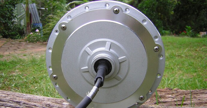

Bafang 350W 26in hubs from Jag35 / Battery Clearing House
The BCH hubs has a warning label on it that it’s compatible only with disc brakes. If you look at the rims carefully, you will see that they are not rim v-brakes compatible. I actually removed the discs and installed on my bike with front rim brakes only, got the brakes all adjusted, before I realize the BCH Hubs aren’t for rim brakes. The motor weren’t laced into the right type of RIM, so you either change out the front fork, or get the hub motor re-lace into a different rim.

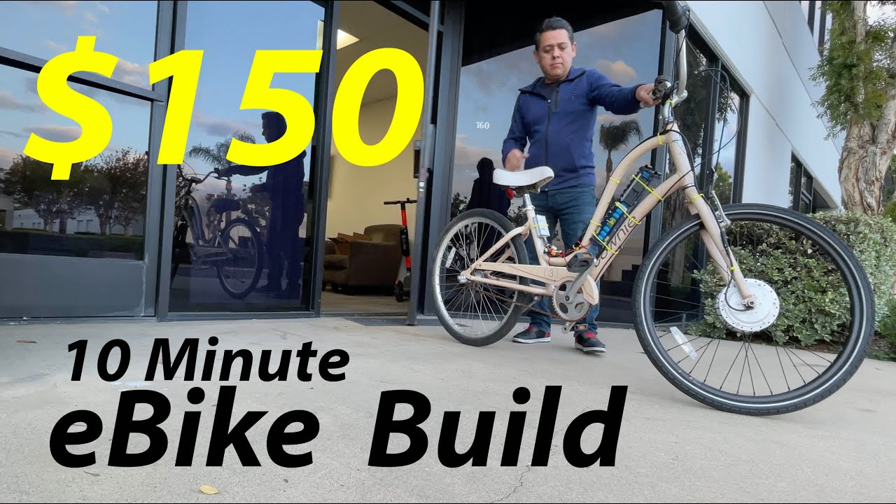

Well, that guy seems to be having fun. And likes to live dangerously. No torque arm, no helmet, no bueno. :grimacing: Other than that, nice to see how easily it can be done, if you have all the proper bits and pieces. Looks like he got up over 30mph, which is faster than I thought it would go. Guess it just depends on how much voltage you’re willing or able to give it.
I couldn’t tell if that meter said kmh or mph. I left a comment about the lack of torque arm but pulled the trigger on the controller kit. Need to put these hubs to work!
Good point. I just assumed mph cause 'murica, but the display probably comes set to kph. Video is just blurry enough to be hard to tell conclusively, but kph seems more likely.
Keep us posted on that controller when you get it. :+1:t3:

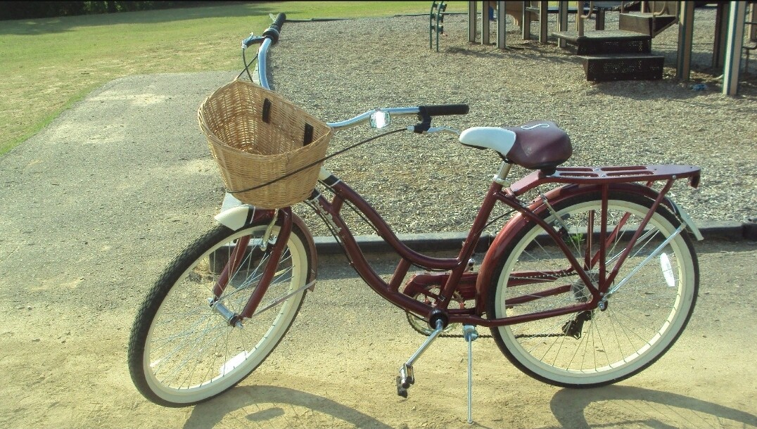

No cute front basket but I’m hoping the controller brick will fit in that nice little square cutout. If not, plenty of room for junk in that trunk.
