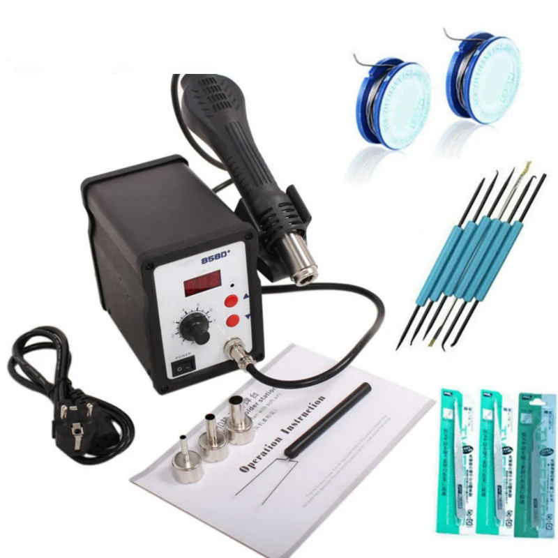

I’m currently on the hunt for a SMD soldering hot air gun and I’ve been specifically looking on this.
Before I buy it, I would appreciate if anyone had any experiences with it, or if it’s a go or no-go.
