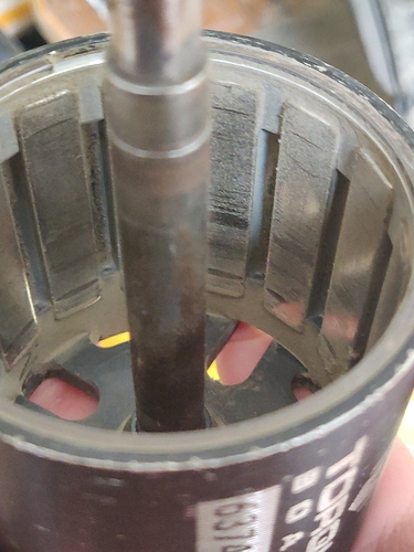

The dust free spots generally mean contact to the stator right?
Is there any shop to buy a new motor shaft? tb 6374
Hobbyking has some for 6374. Maybe it will fit
edit:
My bad, it says that they dont have them now, but turn on alert, they are showing up from time to time
That probably won’t work. The shaft is 8mm.
The tb one is 8mm on the pulley and ~10 on the rest.

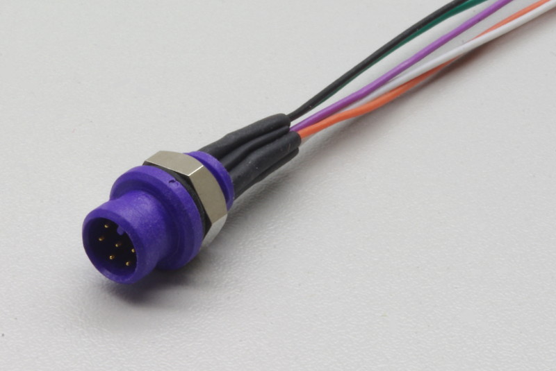

Currently looking for Higo panel connectors for the sensor wires, but not sure which one to choose:
A
https://www.e-bike-technologies.de/index.php/en/connectors/connectors-signal/connectors-higo-mini-b-series/higo-mini-b-panelmount-connectors/higo-b6-bpt-200-detail
B
https://www.e-bike-technologies.de/index.php/en/connectors/connectors-signal/connectors-higo-mini-b-series/higo-mini-b-panelmount-connectors/higo-s6-bpt-200-detail
I’m planning on attaching then to the side of the ESC enclosure, like in the picture below. I think A would put less strain on the hanging connector and less prominent to detach but wanted to hear your thoughts.
