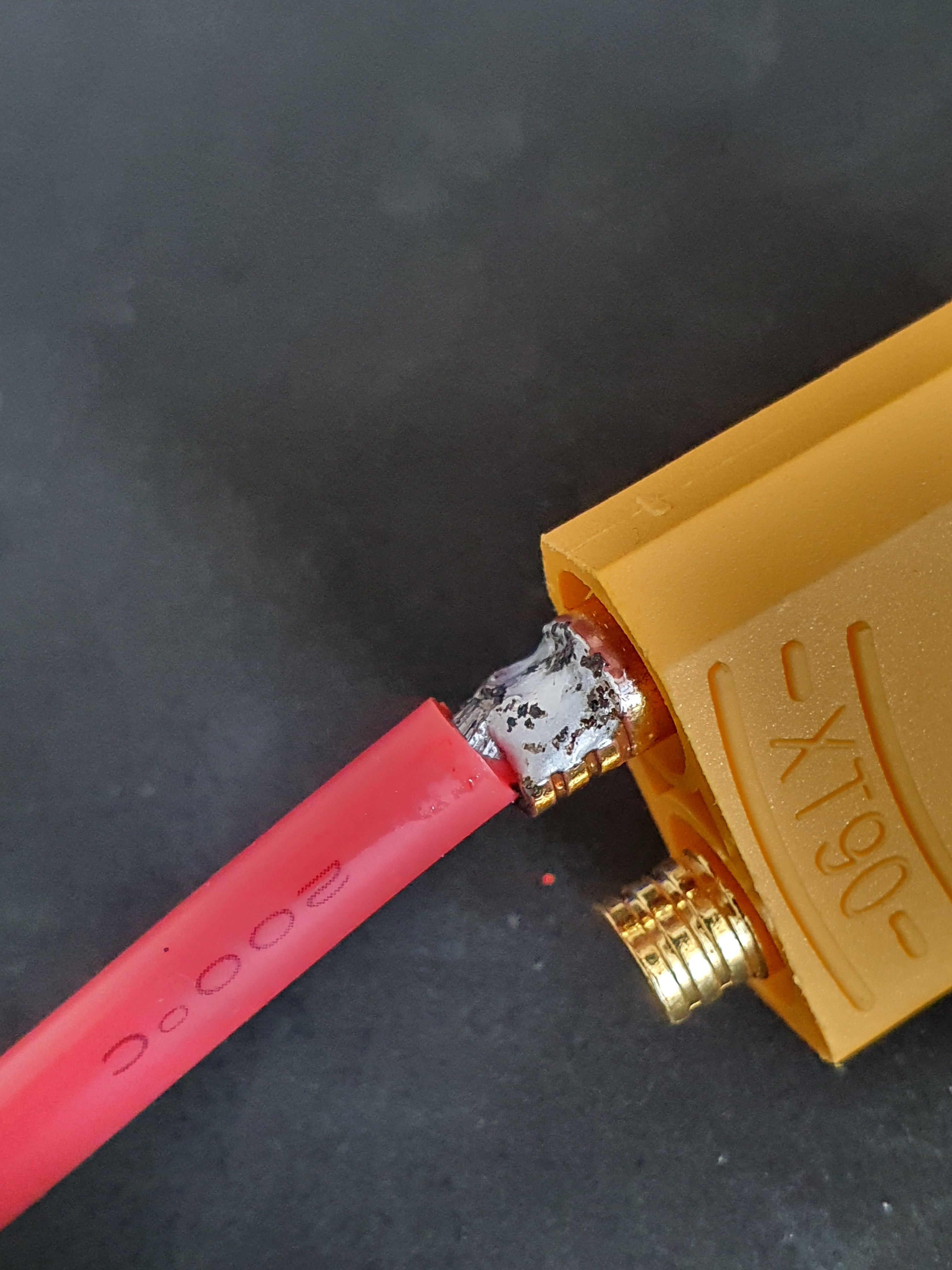

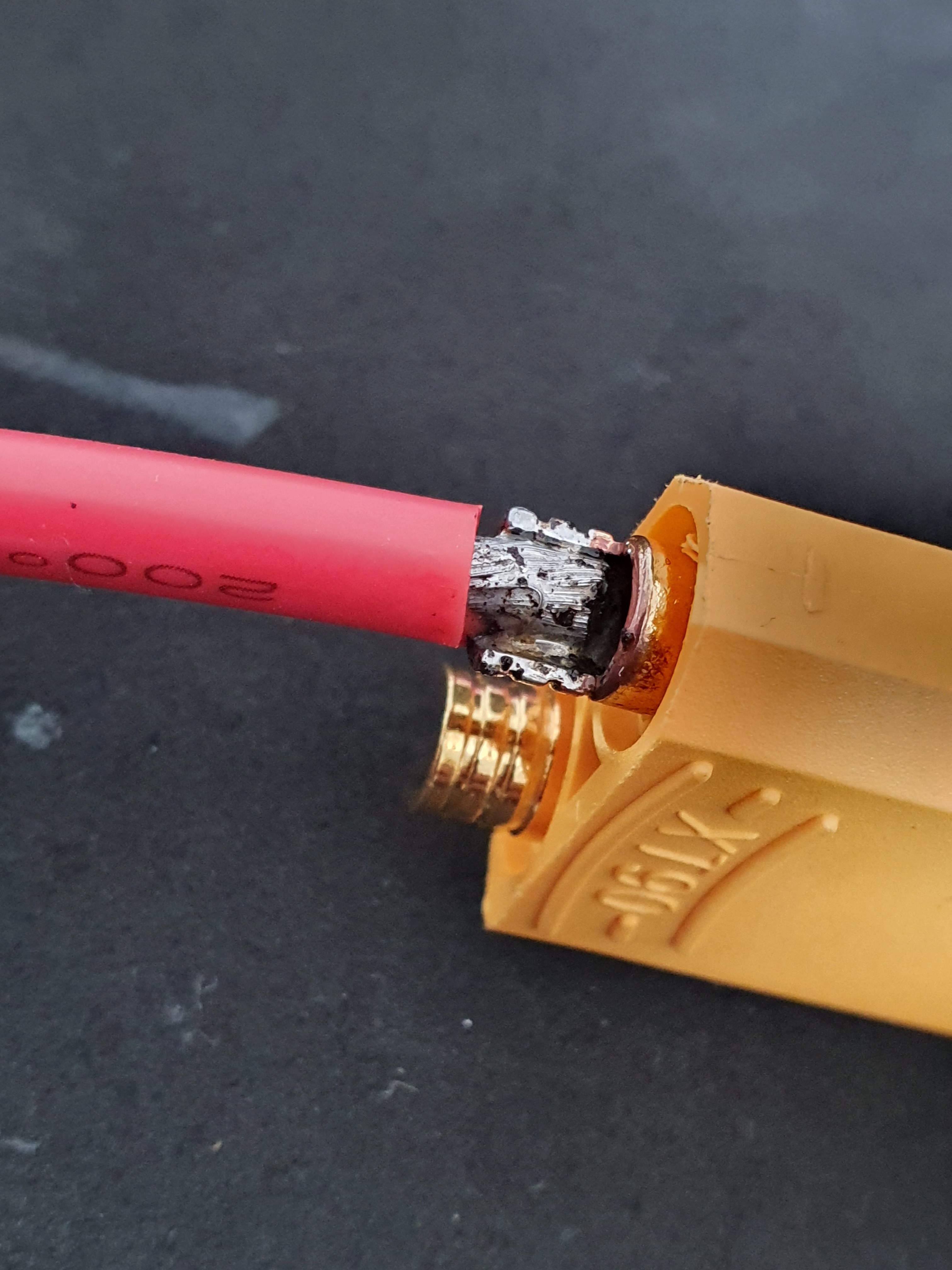

For the connector alone, it should be instant with flux. For the thick cable, depends on the soldering iron. I have a shitty one and have to put it around “400°c” to realistically have solder flow in 10 seconds, and it freezes again for another good 10 seconds when it meets the xt connector
@brendan
[Serious] How To Solder-The Complete Tutorial From A>Z
I didn’t spen hours on this for nothing :grin:
Tin:
Solder:
Fill gaps:
If it doesn’t melt use higher temperature
