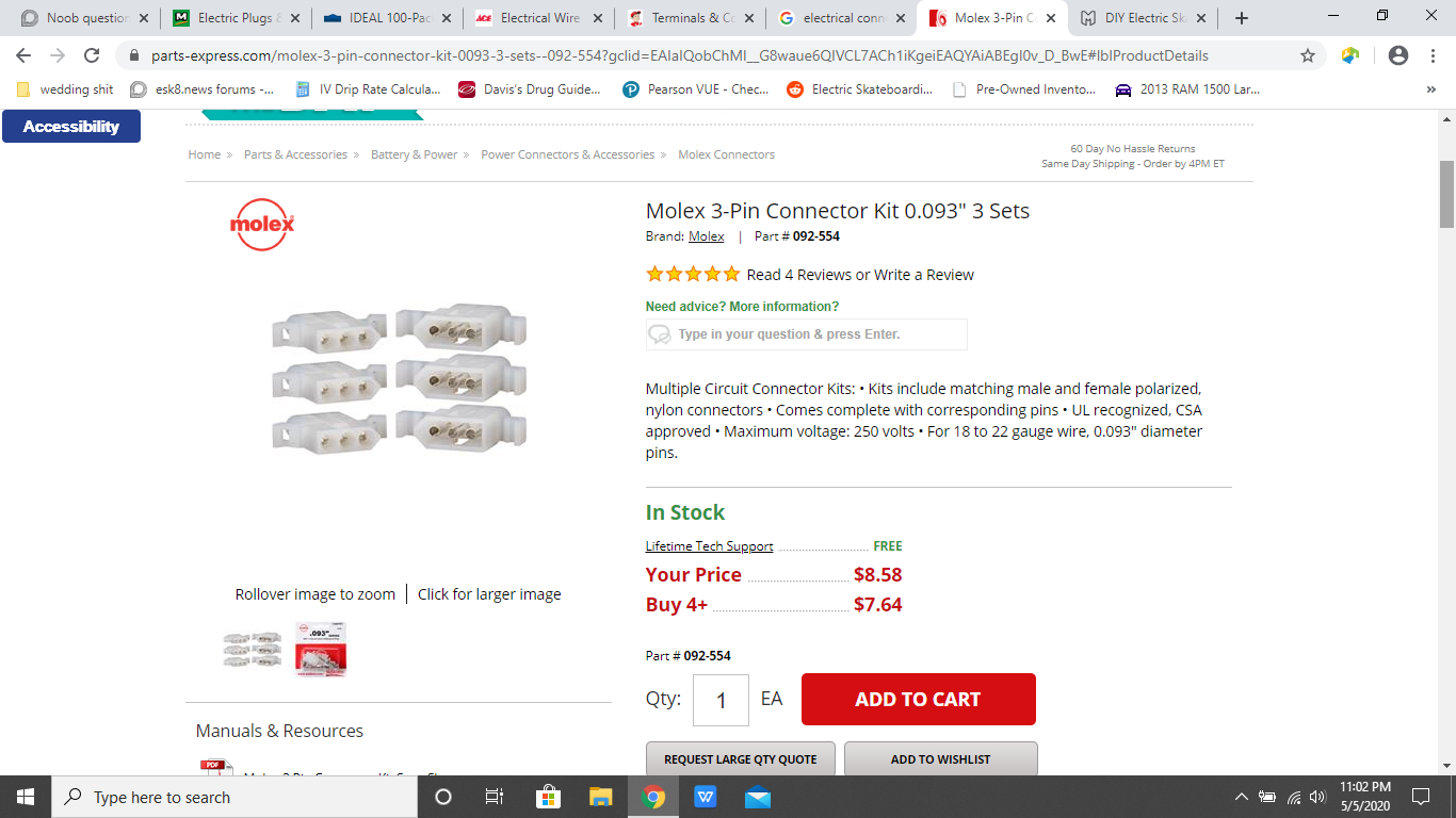

Would this work for a connect and disconnect instead of bullet connectors? would I have to go up in gauge size.

Why this instead of an MR-30?
Cause I had no clue about MR30 connector. I liked the wings that hold it together seems a bit more secure then friction based connector.

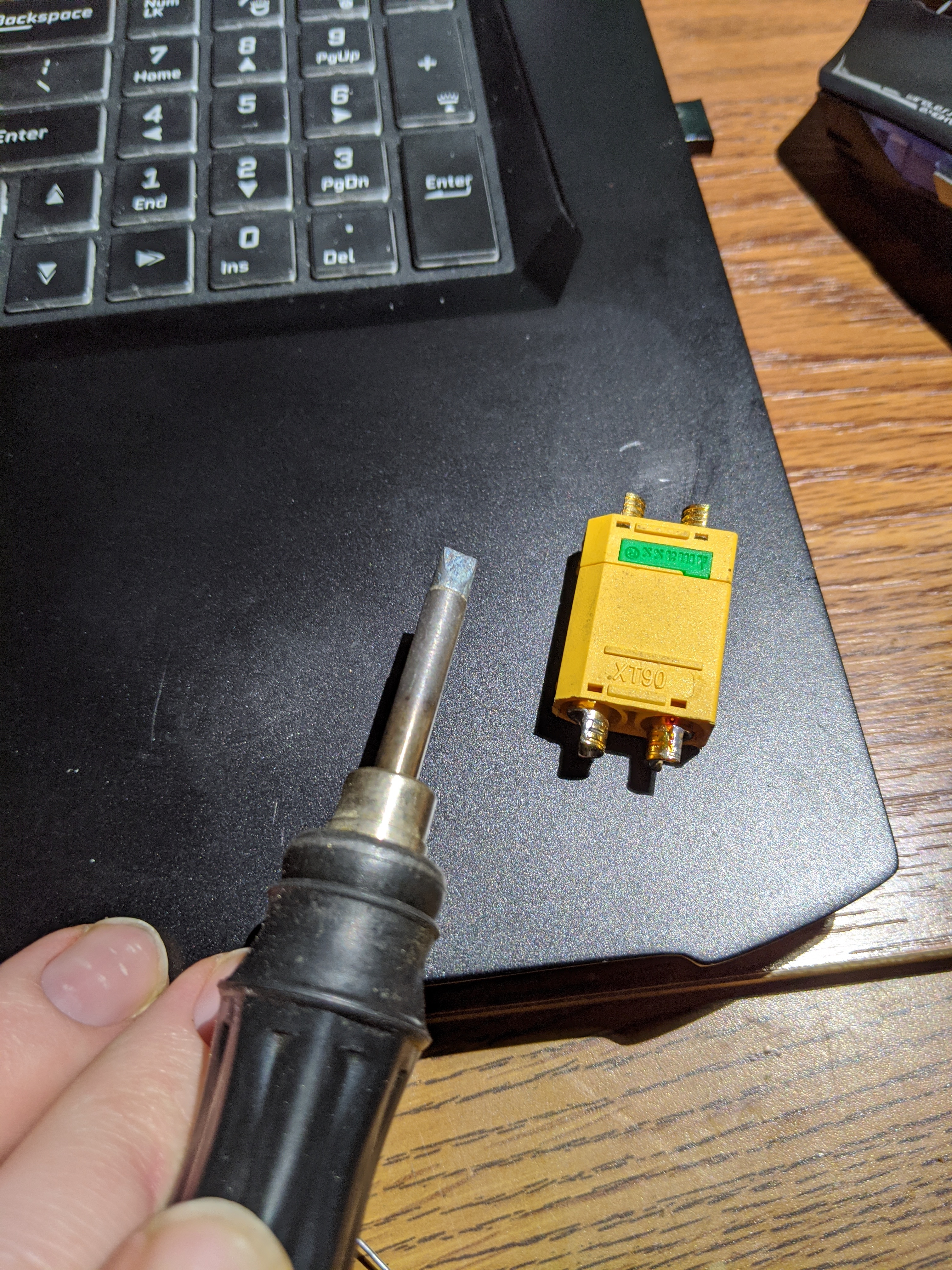

Holding a dry iron on the connector will take forever to transfer enough heat to bring the connector up to temp. You’ve gotta have a small amount of solder on the iron tip already to act as a thermal transfer medium. Basically mash some solder between the iron and the connector and let the melted blob conduct the heat into the connector.
For me, with an 80W directly-heated iron tip at 450C, I can solder a piece of 10AWG wire to an XT90 in about 30 seconds from touching the iron to it being done.
Pic of the iron for reference.

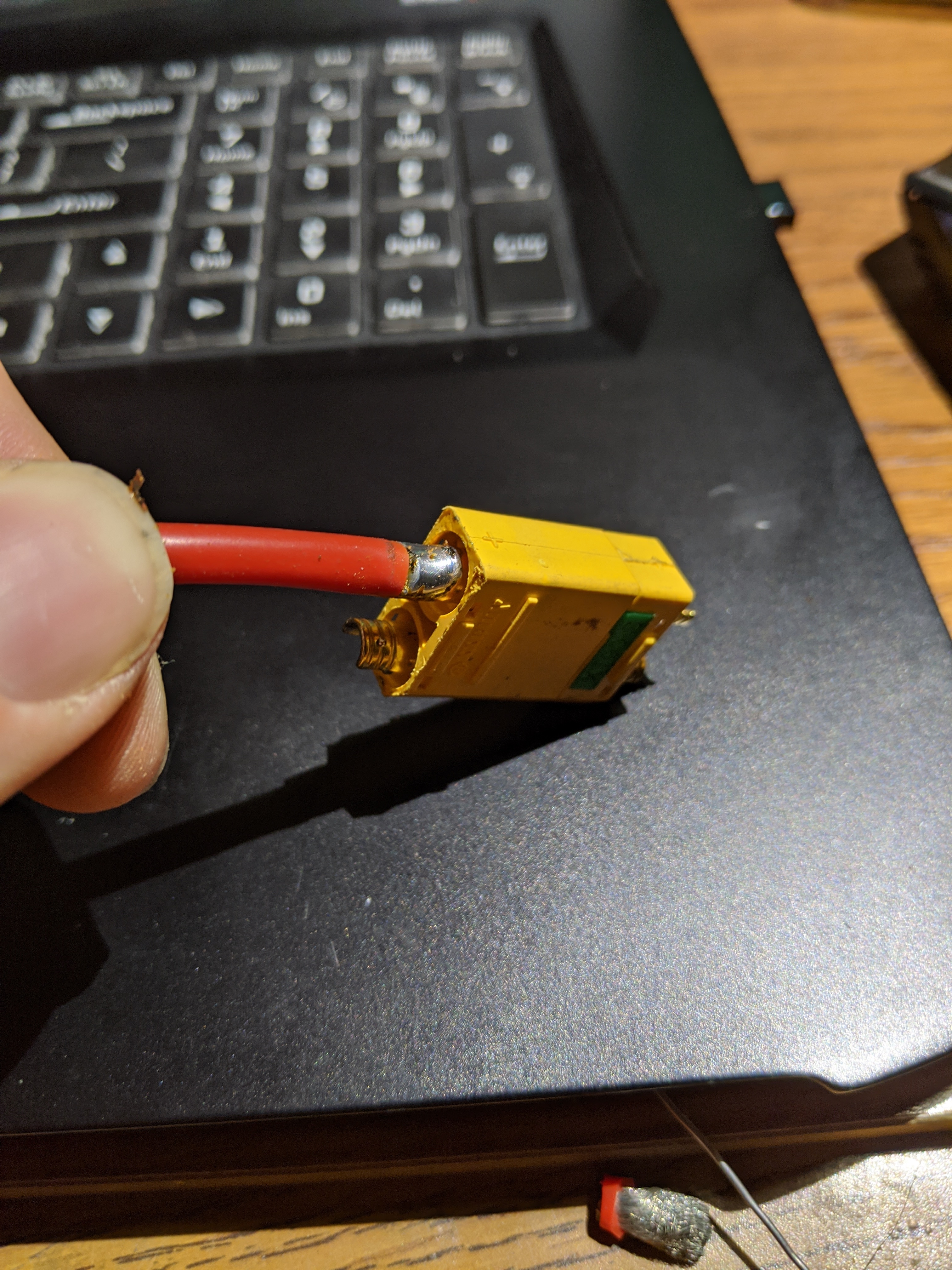

Sweet thanks, let me just back brief you on this to see if I have it straight:
Basically I get a little bead of solder on the tip, press that bead to the bottom of the connector to heat the whole thing, then apply solder to the open top to tin it.
What I did for that demo photo was:
A: Tin the wire.
B: Tin the connector. Leave some solder on the iron (E.G. don’t wipe it off.)
C: Put the wire in the connector, add a little extra flux.
D: Start stopwatch, mash iron against wire-in-connector hard to get good thermal contact.
E: Wait about ten seconds for heating, then dab some extra solder on the iron where it touches the wire-in-connector.
F: Continue to add heat and solder until it looks like the picture: A nice shiny fillet all around with no pucker or gap between the wire and the connector.
G: Stop stopwatch, remove iron and solder.
