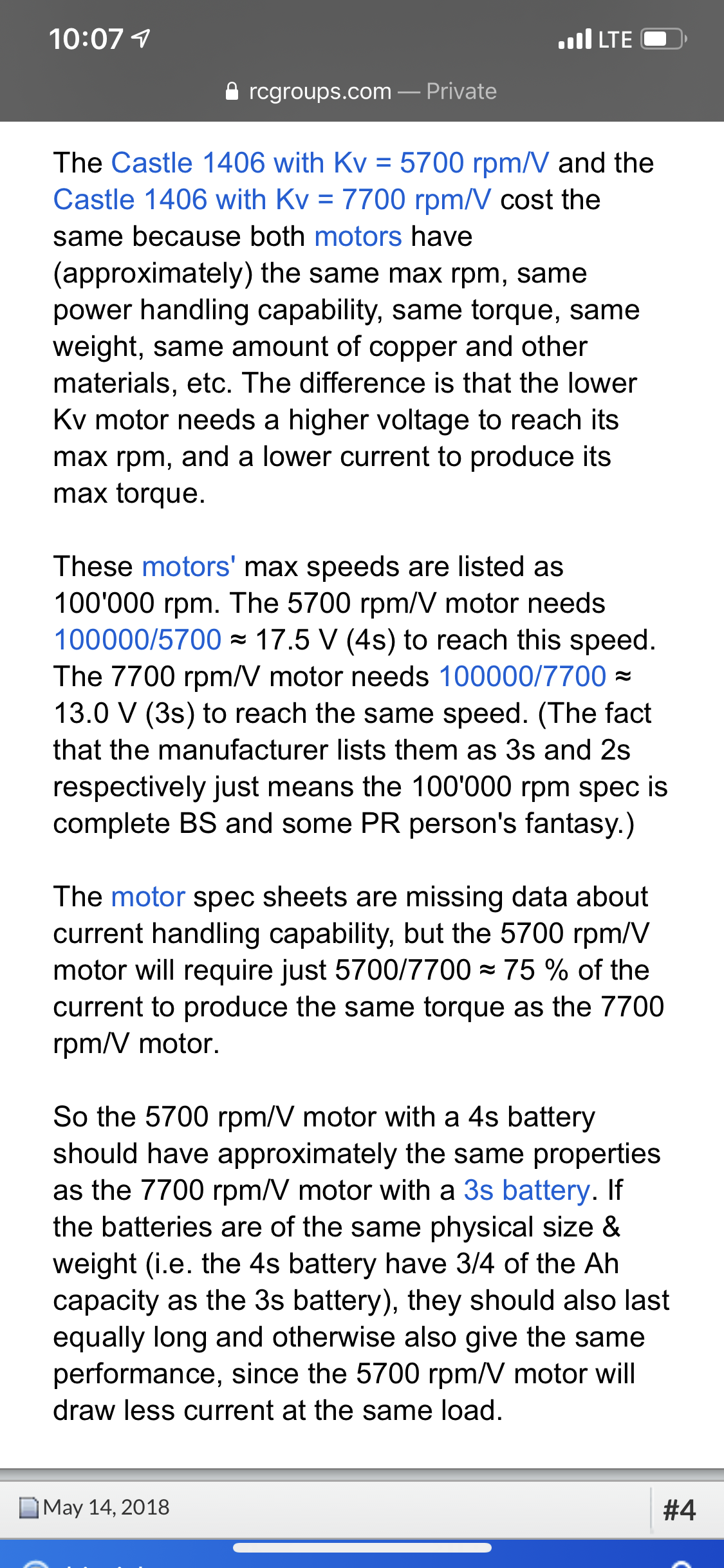

Below is screenshot of post from Rcgroups.com
Let’s say I have a 170 Kv motor and 800 Kv motor on identical setups (gear ratio, wheels, battery, ESC). Could I make the two setups perform the same (acceleration/top speed) by adjusting the voltage and current sent to motors? Like higher voltage on the low Kv motor to match top end speed of high Kv motor and higher current on high Kv motor to match the torque on the low Kv motor (for sake of discussion let’s say the battery and ESC aren’t limited in any way to allow for adjustments).
@b264 @MoeStooge @hummieee @annihil8ted
Yes but the overlap would be very small if not already out of the range of the motors. We also need to define that acceleration and top speed are 2 separate (and often inversely related things).
Focusing on speed/topspeed first, the math is quite easy:
If it’s speed we talking about, the voltage ratio will be 170:800 or 17:80. So for whatever cell count/voltage you choose for the 170KV, the 800KV will need to be paired with 17/80 of it. The opposite would be whatever cell count/voltage you choose for the 800KV, the 170KV battery will need to be a factor of 80/17 of it.
This however is kind of unlikely. Let’s say for the 170KV, I choose 10S, that would mean the 800KV would need 10S * 17/80 or roughtly 2S. Conversely, if you choose 6S for the 800KV, you would need 6S * 80/17 or roughly 28S. You can see how difficult this would be to achieve with batteries. A much more economical and arguable safer way to achieve same speed would be through gearing. This is assuming that the motors don’t just choke on torque and are able to attain max KV (ie mythical perfect motors. Will never be the case). This is also assuming that all other motor characteristics are equivalent or very similar.
Acceleration is a little more complicated. What you’re really asking is the torque of the motors. Even different motors of the same KV can have different torque. This is dependent on many things like motor poles, number of windings/winding thicknes, phase termination, can length. In general, a outrunner will have more torque than in an inrunner for the same amount of space and length. This is because an outrunner has a bigger magnetic moment arm.
But yes, you could dump current into the 800KV to get similar torque output to the 170KV. Good luck not frying all of your electrical components. This is highly dangerous as even at 10S voltage levels, 10A can cause some severe damage.
In the RC post, they take into account that the motors are of similar length and probably similar phase termination, etc. The only difference is probably number of windings/winding thickness. In the case where you fix all other variables, yes, you can compensate a high KV motor for more torque with more current, and you can compensate a low KV motor for more speed with more voltage.
Not an expert in this field though. Just a guy who’s gone through a decent amount of physics and EE classes. Plus some anecdotal experience :sweat_smile:
For a 1000kv vs 100kv motor if u 10x increase the voltage and have an esc that can put out the 10x amps u will have the same exact performance if the motor km is the same and also they magnetically saturate at the same torque. It will be more inefficient in the esc only with the lower voltage set up (assuming same copper in motor n therefore same km)
Kv (the speed constant) and it’s inverse kt (the torque constant) encompass a lot. U can have a tiny 100kv motor or a giant 100kv and they will produce the same “torque per amp” regardless of size, poles, termination, this, or that. The only other variables are the motor km (the size constant) which relates to the resistance of the windings and torque produced and with a small motor there will be higher electrical resistance and a subsequent voltage drop that will effect performance a hair and it will also produce more heat. the only other variable between the two motors (same kv, big vs small) is the amount of iron in the stator and can only make steel into a magnet of 1.7 tesla before starts to not be linear relationship n goes south so bigger motor is more iron and greater maximum torque

In theory yes, in an ideal world where winding resistance and magnetic saturation aren’t a thing.
In practice, no. To get good performance out of a high-KV inrunner you have to let it spin faster, which means higher gear ratio.
