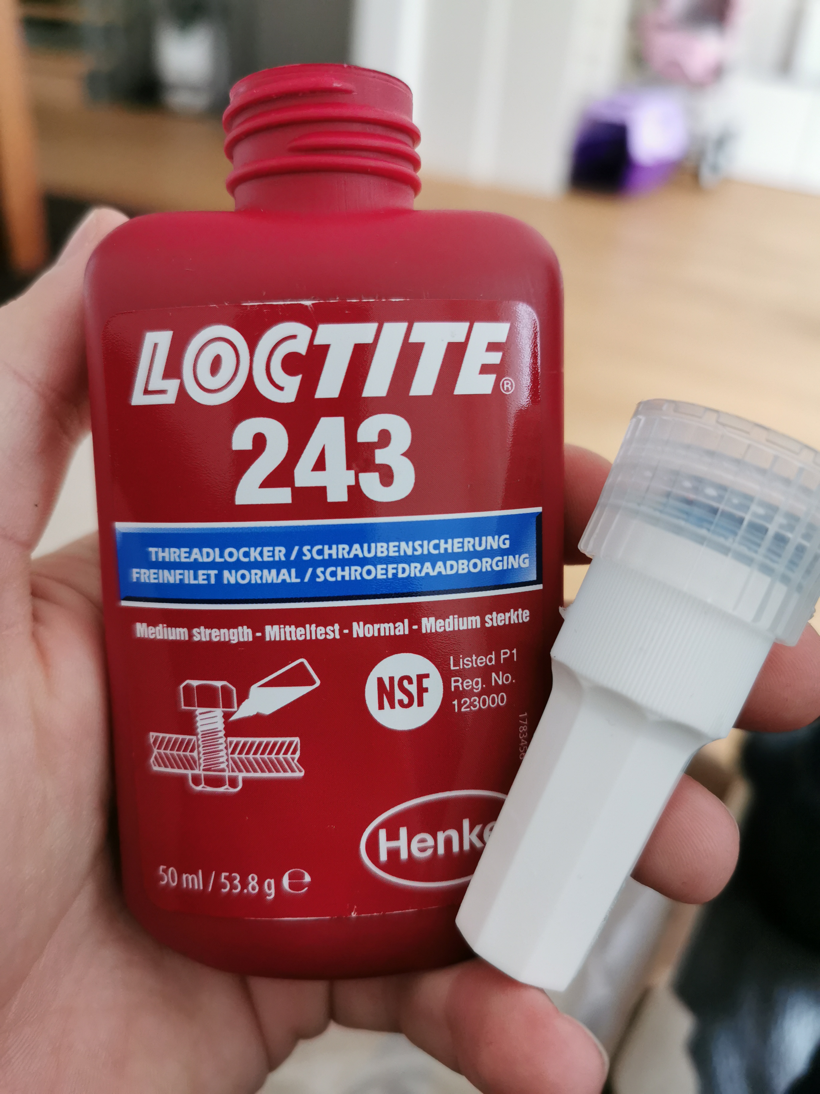

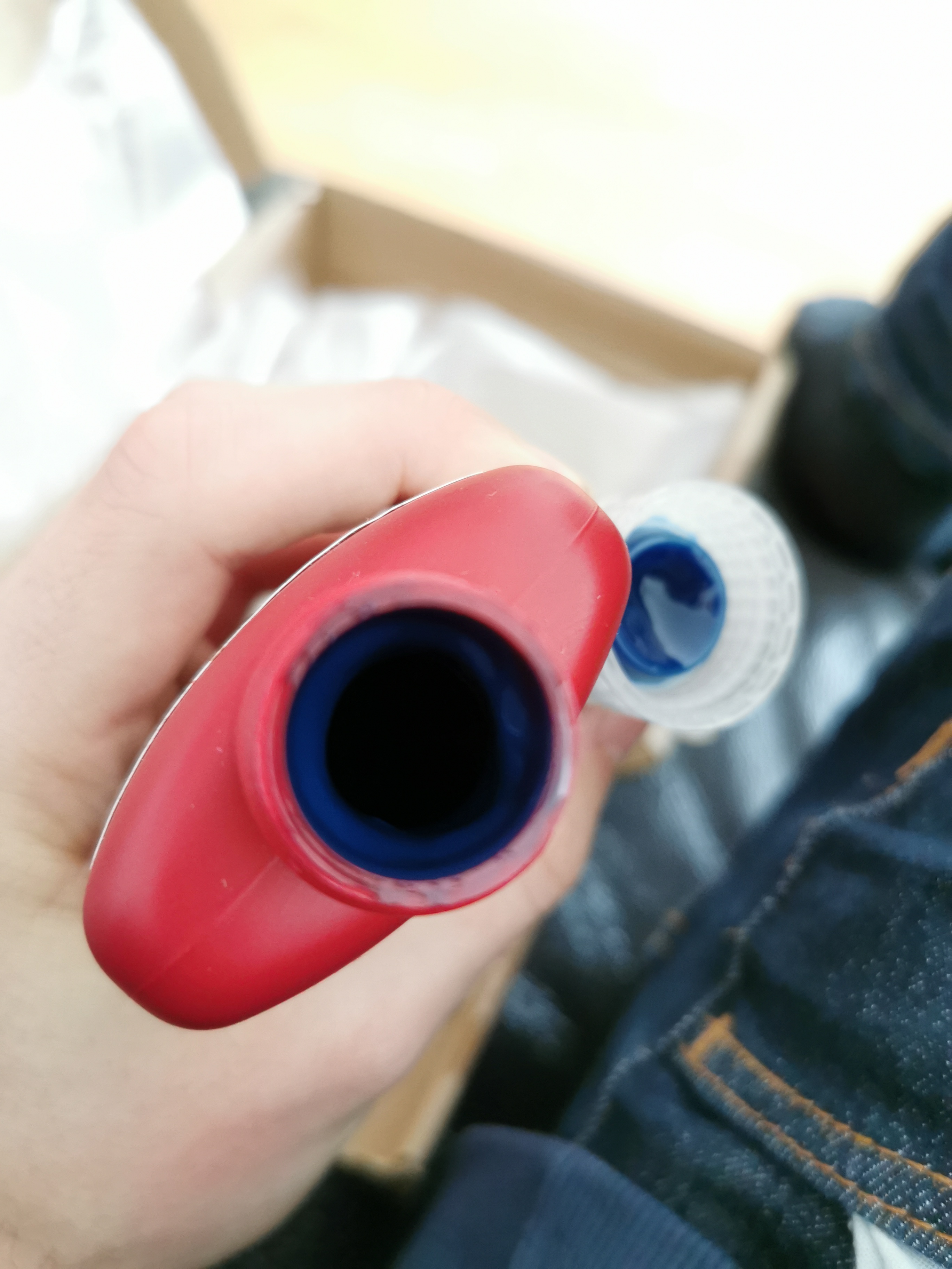

Are the 50ml loctite bottles always this empty?
Its only filled to where it says Medien strength^^
Seems like loctite needs to have air in the bottle so it doesnā€™t harden.
Yes mine is like that too.
3 reasons I can think of.
Itā€™s a 100ml bottle with only 50ml sold
its to trick the customer into thinking he gets a full bottle
Your idea
