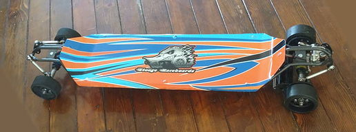

@MoeStooge runs high kV motors (800 kV) with a 8S lipos setup. Why? What are the advantages and disadvantages compared to usual builds I see that have 170 to 200 kV motors paired with 10s or 12s batteries.
I noticed he runs gear drives too. Could I mimic his setup but with belt drive?

For example, I typically optimize for reliability and nimbleness above all else, which yields things that look very different from what Moe does, which appears to optimize for speed:

Everyone here uses lower kV motors (compared to Moe) and 10s or 12s batteries (higher volts).
In general, Moe has high kV motors and 8s batteries (lower volts) on his raceboards which have both speed and acceleration. So why doesnā€™t everyone go with his setup?
Sorry if Iā€™m asking too many questions and ā€œnot getting itā€. I donā€™t have EE background and google and search function hasnā€™t helped much.
One limit is when using HTD5M belts, which are cheap, work great, easy to work on, reliable, et cetera, the minimum pulley size is recommended to be 15 teeth. At such high Kvs youā€™d need ratios like 15/188 and 188 tooth pulley wonā€™t fit on a wheel, so youā€™d need a ratio like 3/40 and a 3 tooth pulley wonā€™t function.
Moe uses steel gears at a very steep reduction (tiny motor gear, huge wheel gear), which is great if youā€™re using high Kv motors AND have a machine shop AND donā€™t rely on your skates to get to work or anything. It works well for his circumstances.

Here is a clip from our last race at the start. SRB team rider Mario on 8s 800kv 67/11 gear 155mm tire with esc set at 80% power to limit the tall gearing the 155mm tire gave us.
