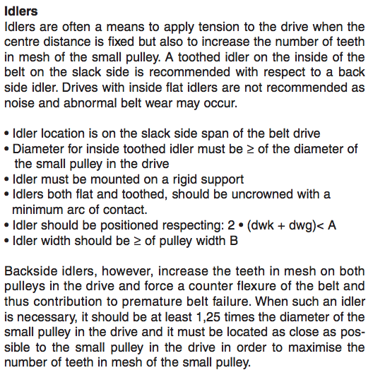

i probably will soon have to use dareno’s idler hack,
in theory - is it prefered for idlers to be small or large in diameter ?
leaving this here incase anyone is looking for the info:
tldr: idler should be atleast 1,25 times the diameter of motor pulley
