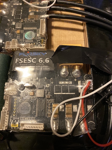

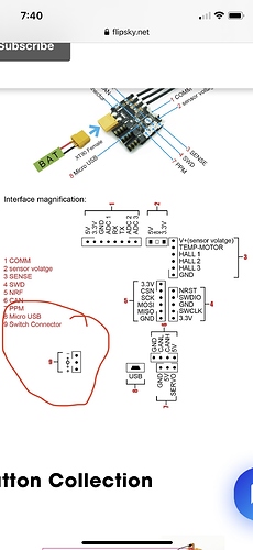

Can I remove the momentary switch from fsesc 6.6?
(will replace with loop key)
Can I just unplug it? Or do I need to short the wires so that it is permanently on?
@Gamer43 seems to have the solution to this.
Anyone got experience with a simpler way?
