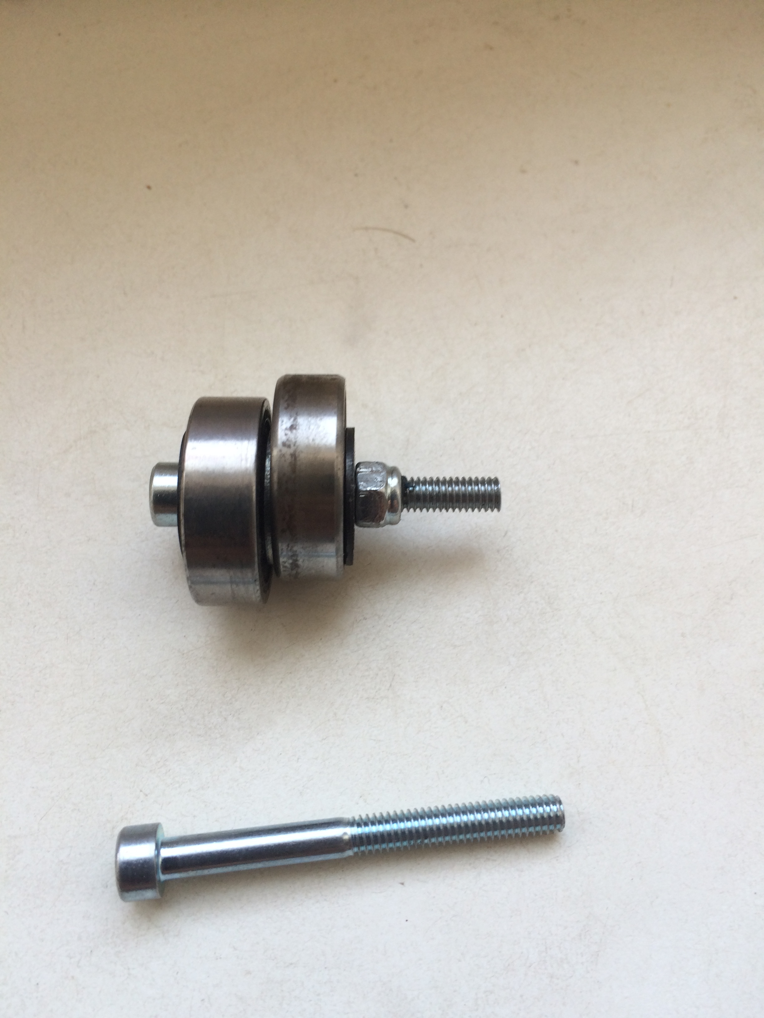

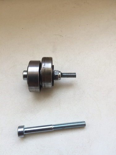

idler hack ?

its probably not the best idea, and only possible with small motor pulley (this one is 13t), but to my defense it is running completely true and no grinding on the bearings - and i guess bonus points for moving along with the motor when you tighten the belts :joy:

So let me get this straight. You have used an extended m3 motor mount bolt to utilise 608 idler bearings? Without a reducing bush? And then when I look closer you have extended the motor plate fixings with hex sockets.
You sir are a master Mcgyver.
Looks like an extended M4 motor mount bolt to me :man_shrugging:
Could be Brian but that is really not the point when the bearing ID is 8mm lol
That extension may be the greatest engineering feat I’ve seen in modern day times
They’re your mounts aren’t they?
this still stays flexible alltough the nut is cranked down, the washers keep the bearings aligned…
they can still move “up and down”, the belt pushes them into position… i hope that explanation makes sense
and the washers are small enough that in whatever position the bearings are, they cant rub on the outer ring
but like i said this only has enough room to work with a 13t pulley or smaller, would need modifications otherwise
im not sure, maybe im just an idiot - time will tell :sweat_smile:
