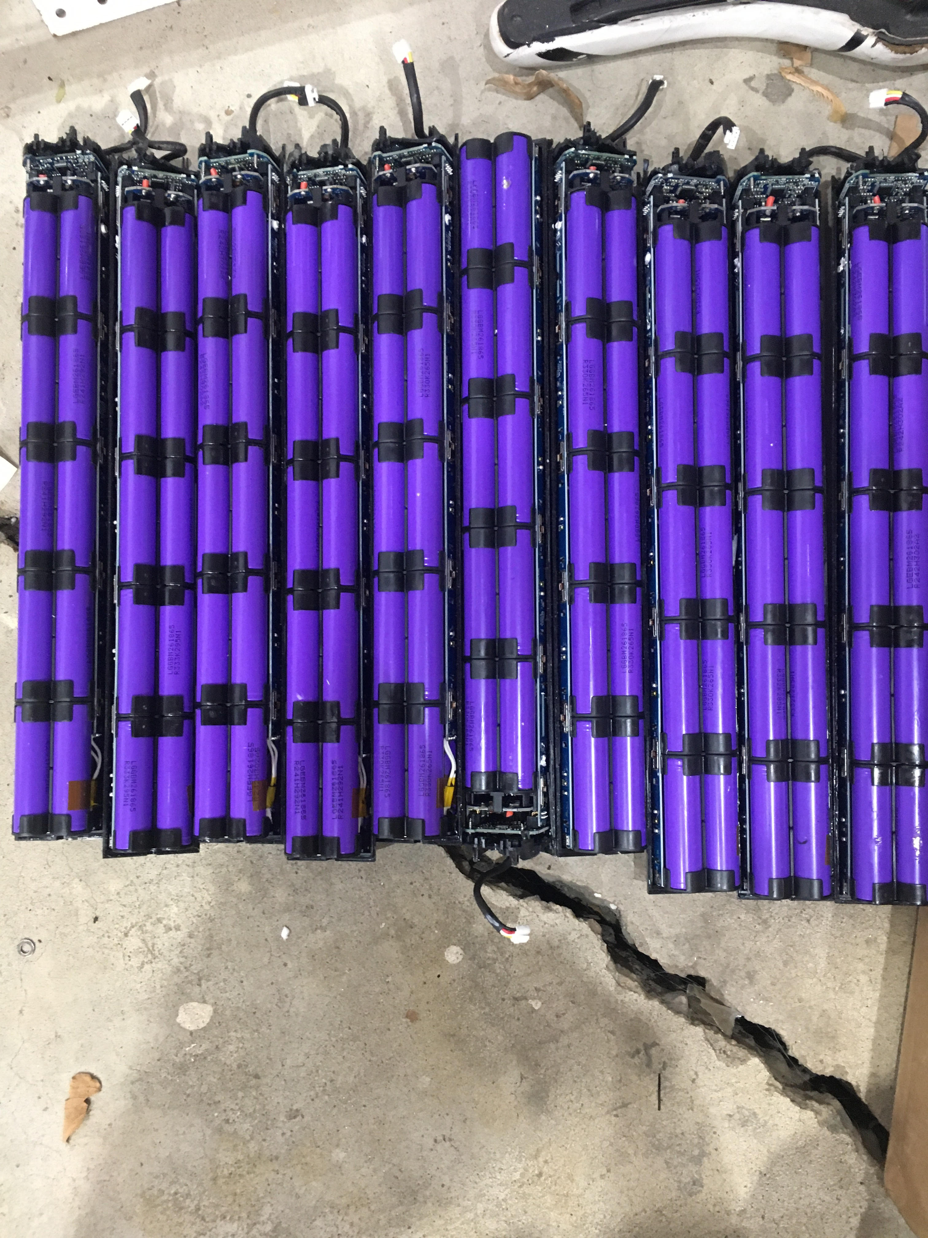

would 2 10s2p packs in series be a 10s4p? what about 2 in parallel? How would you wire these 2 10s2p packs differently for the 2 different scenarios? Assuming they are already built and put together 10s2p packs

series would make a 20s2p. parallel would make a 10s4p. Parallel means + and - wires on both batt connects together. Series means the - of one pack connects to the + of the other pack and your two remaining + and - has the combined voltage of both packs.
No offense but do not try this until you understand the concept of why that is. Can get zappy real fast…
Paralleling packs is generally okay as long as both packs are of same voltage (s count) as long as wiring etc are reasonable… Combining series is only recommended if both packs are of same type of cells and same age, otherwise there will be balancing problems. Ideally both packs should have similar build architecture too for identical resistance etc.

Got these old scooter packs real cheap, they have thier own little BMS each. Was considering keeping them together in 10s2p packs as they’re all nicely put together already because taking them apart and measuring the capacity of every cell to build from the ground up would be a big task…
