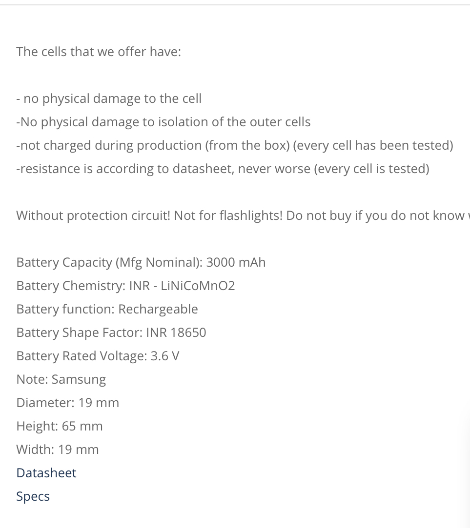

Hi wondering about the problems of using refurbished Samsung 30q nkon cells
https://eu.nkon.nl/samsung-inr18650-30q-3000mah-15a-refurbished.html
Are they ok to use in a pack?
For spot-welding yeah
And I think fogstar is about the same price new…
For nese modules are they ok to use?
I am interested in those and a few one types of refurbished cells on Nkon
They should be ok ?
I think they’ll cause issues
Oh why?
You need to have roughly the same internal resistance for things to evenly discharge and you don’t want any one cell to end up far over discharged in a p group or else when you go to recharge that one bad/worse cell will bring down the average and so you may end up overdischarging or overcharing a given cell depending on how you divide up the more or less worn cells between P groups. Actually vid here talks about issues with cooling causing similar problems because of varying the effective internal resistance of some cells in a battery TIM thermal paste
They say the internal resistance is the same
I mean every cell has some variance from the published numbers and of course they would say that but it is a roll of the dice really, maybe it’s “worth it” if getting a good enough deal but lots of time and effort to make a good battery DIY so would think start with higher quality cells but if they are really all the same IR and roughly same life I don’t see a major issue but again don’t know if one cell had 200 cycles and the other had 100 so maybe losing a lot of cycles on the overall battery. (It’s a crapshoot)
Nese modules rely on perfect physical contact with the electrodes. The nickel on the refurb cells prevent perfect contact
K thanks for the help probably will do fogstar
