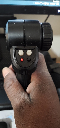

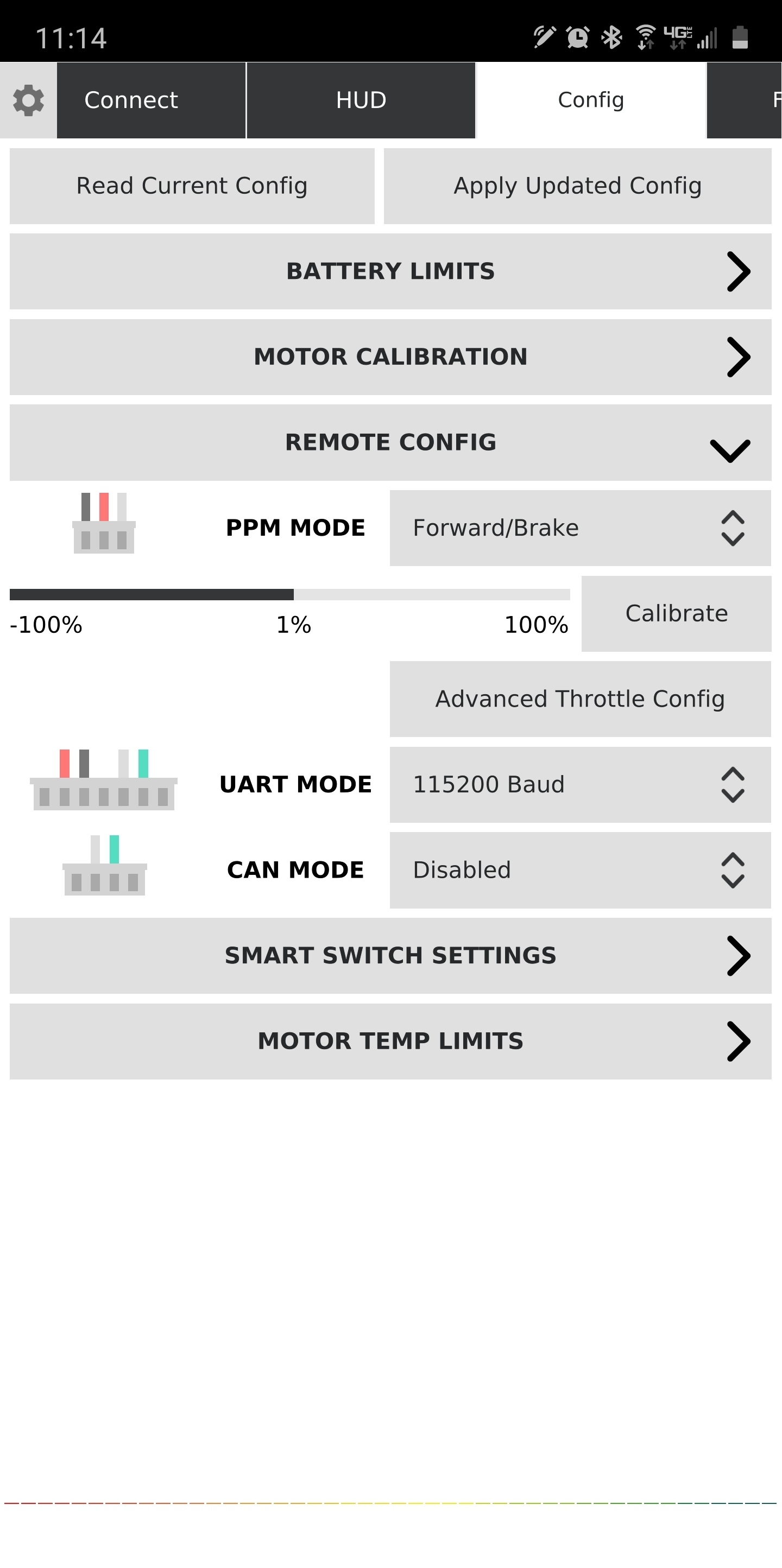

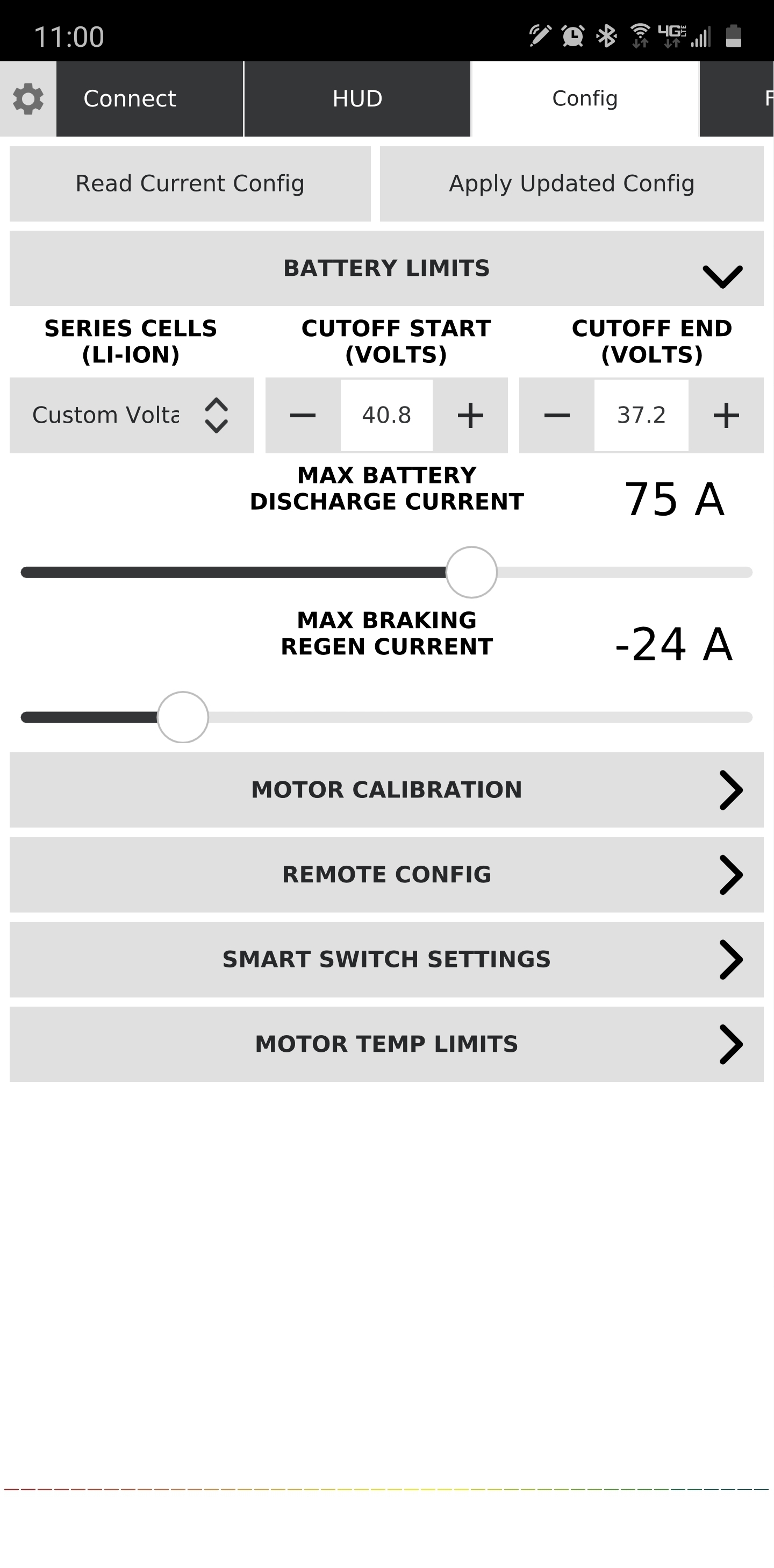

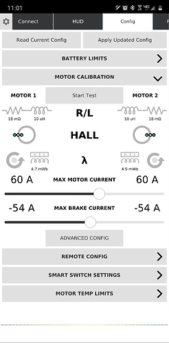

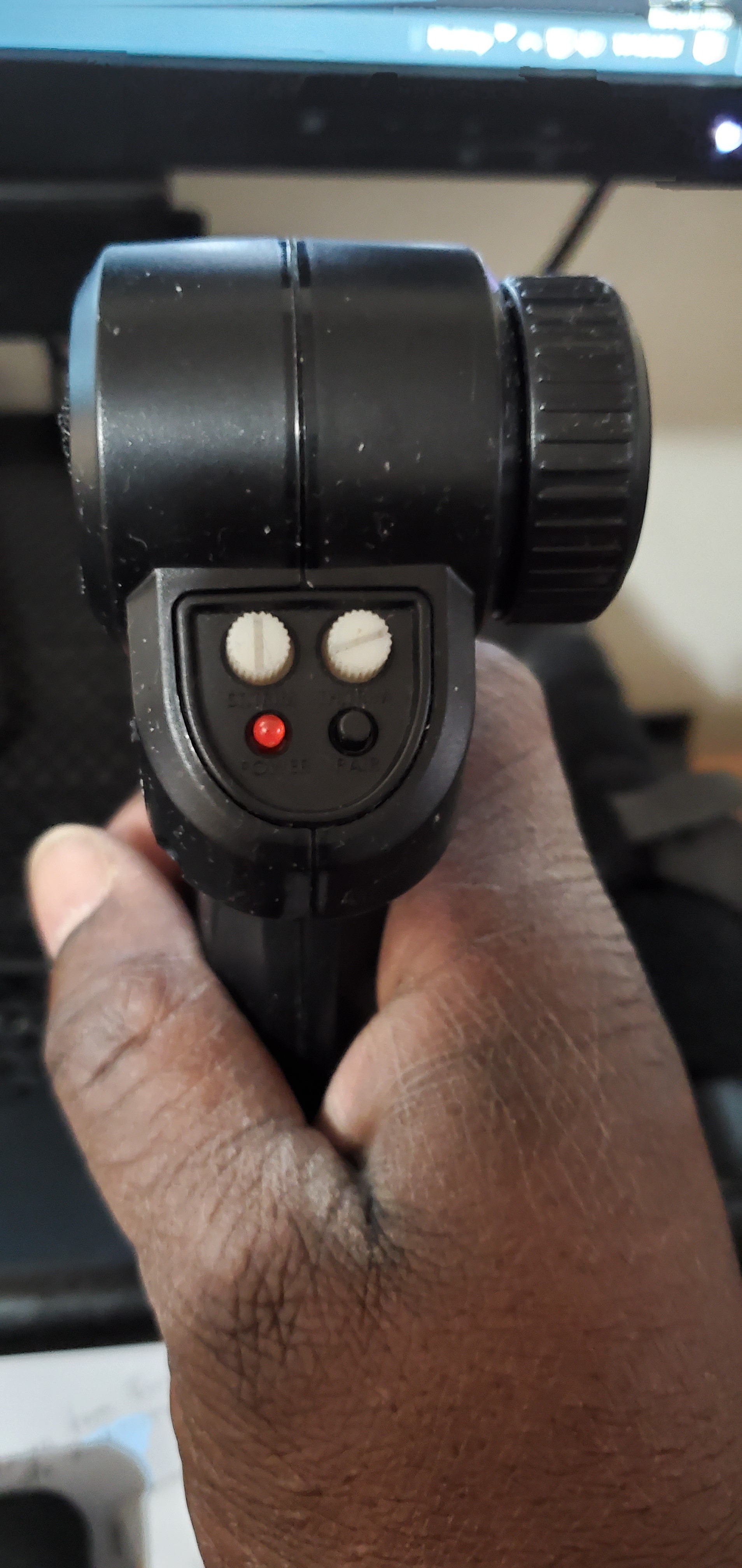

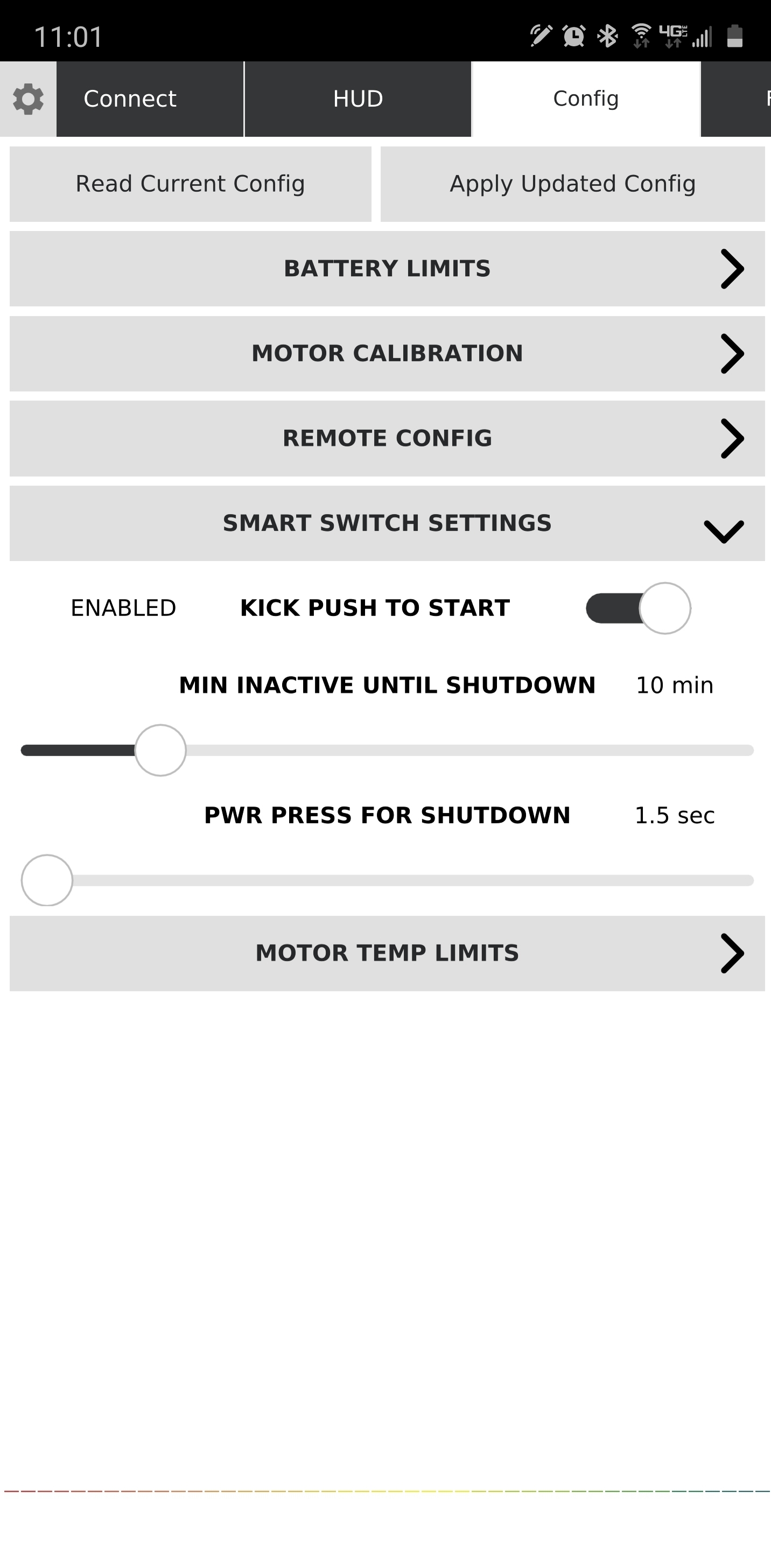

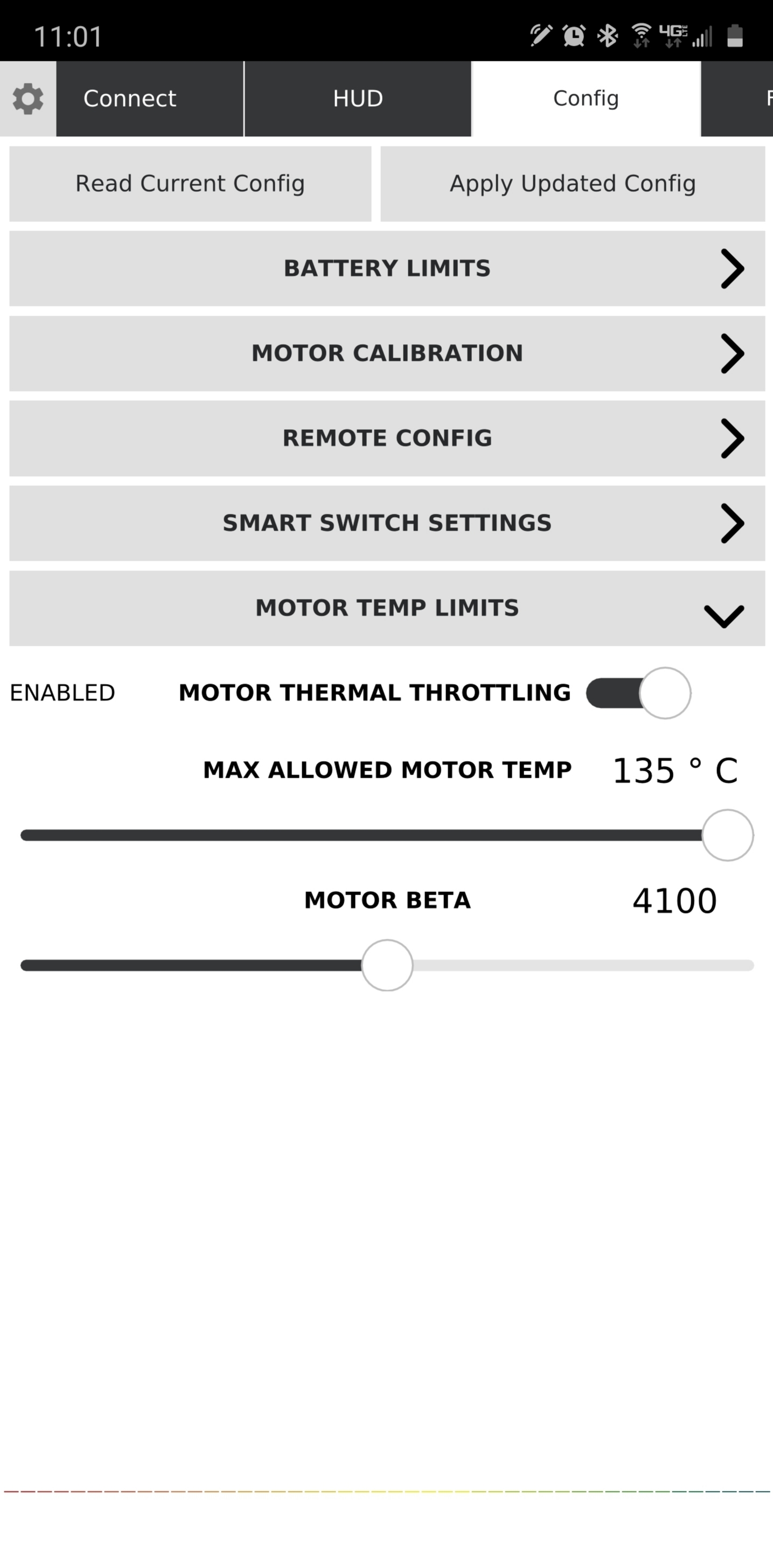

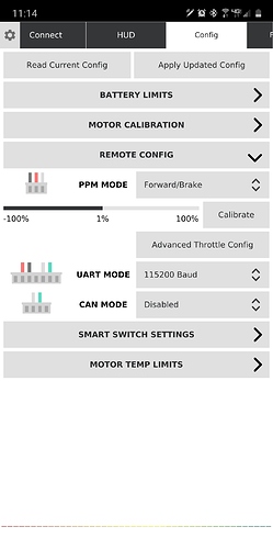

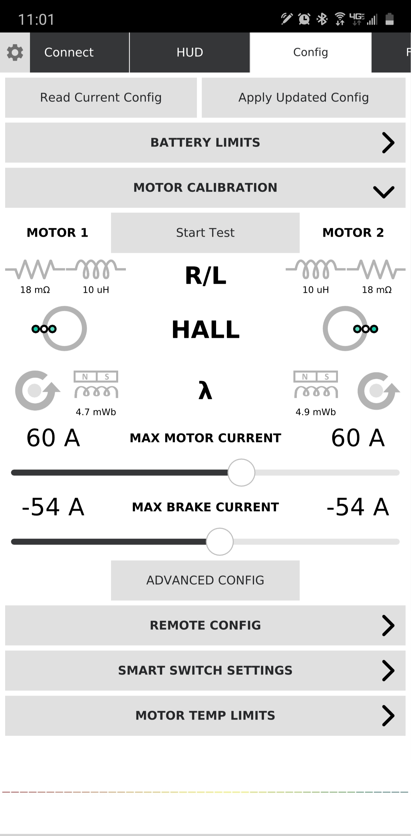

I’m getting a weird jerk when accelerating and breaking…it only happens once, more when long braking. feels like a car engine with a bad spark plug (missing) not real strong just feels weird. I notice it more after changing settings on my ESC (Unity). I always calibrate remote. any suggestion I would like more punch (torque) during take off as well.
Gearing 16/60t
Battery 12s6p
Motor MTO6374-HA-C Maytech, tb6380 170kv not installed yet.
motor 60A
max brake current -54A
batter 75A
braking regen -24A
remote PPM forward/brake
kick to start enabled
Remote 2.4GHz mini new but I kept same receiver.
Pics in case I missed sonething… …
