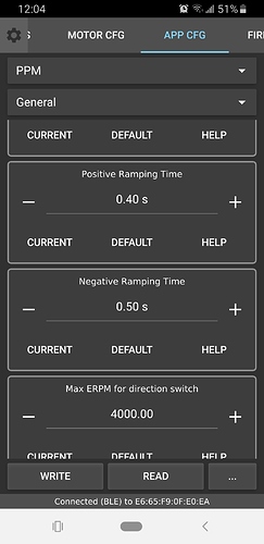

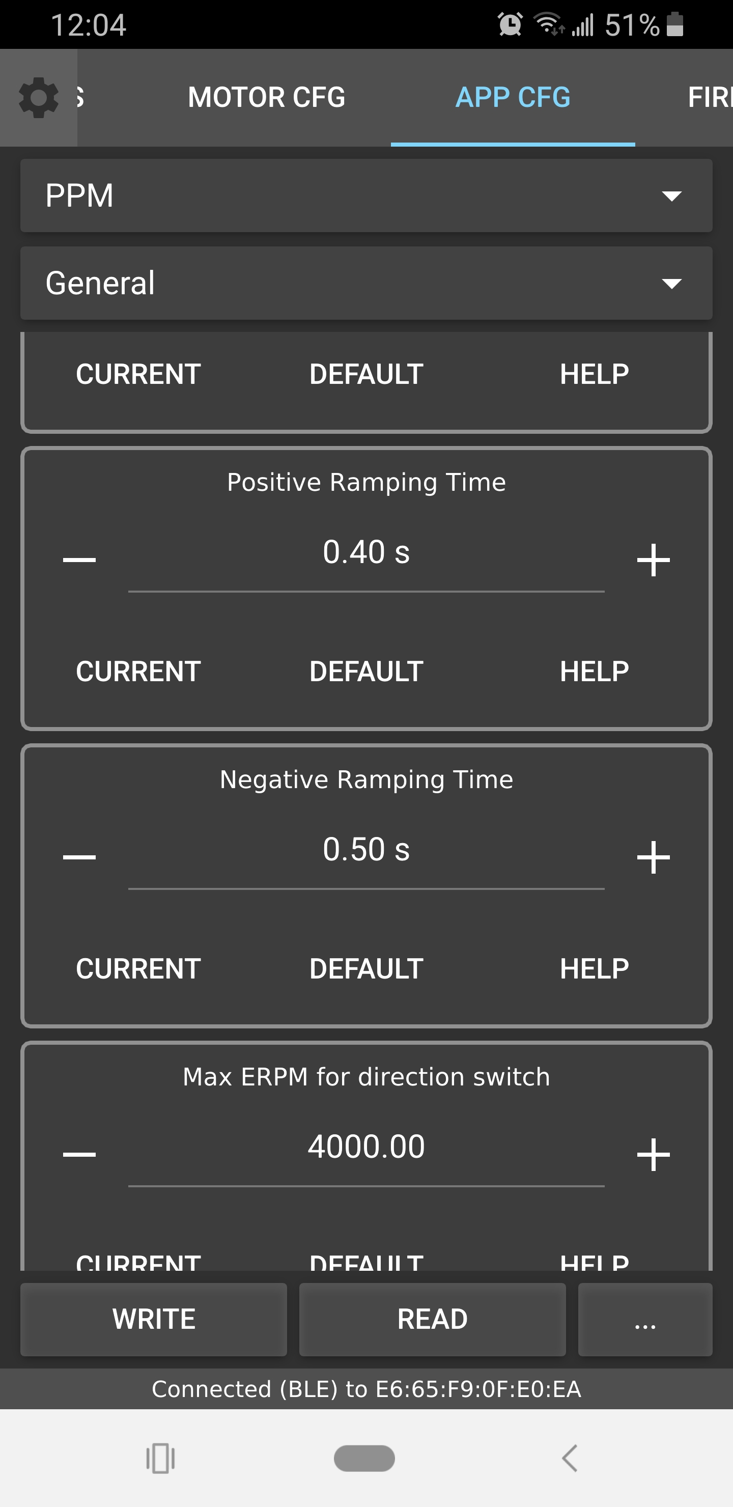

On a recent set up I did the I have a slight issue with the controller. Using the mini Rc remote. I am accidentally pushing on the break… When I mean to be in a neutral position. Is the negative ramping time the correct parameter to adjust in the vesc cool to make the break less touchy?
I would increase the PWM (ā€œPPMā€) deadband instead, or just slightly adjust the white knob on the right, on the remote
I use 7% deadband and keep the trims set if they drift off, just adjust it real quick on the hand controller
Changing the ramping time will change how it brakes when you hit the brakes, not when it engages
Thanks dude. Appreciate it. I ran the ppm wizard again. The deadnzone seemed to default to 15,%. I bumped it to 20%. Control was good with no surprise breaking.
