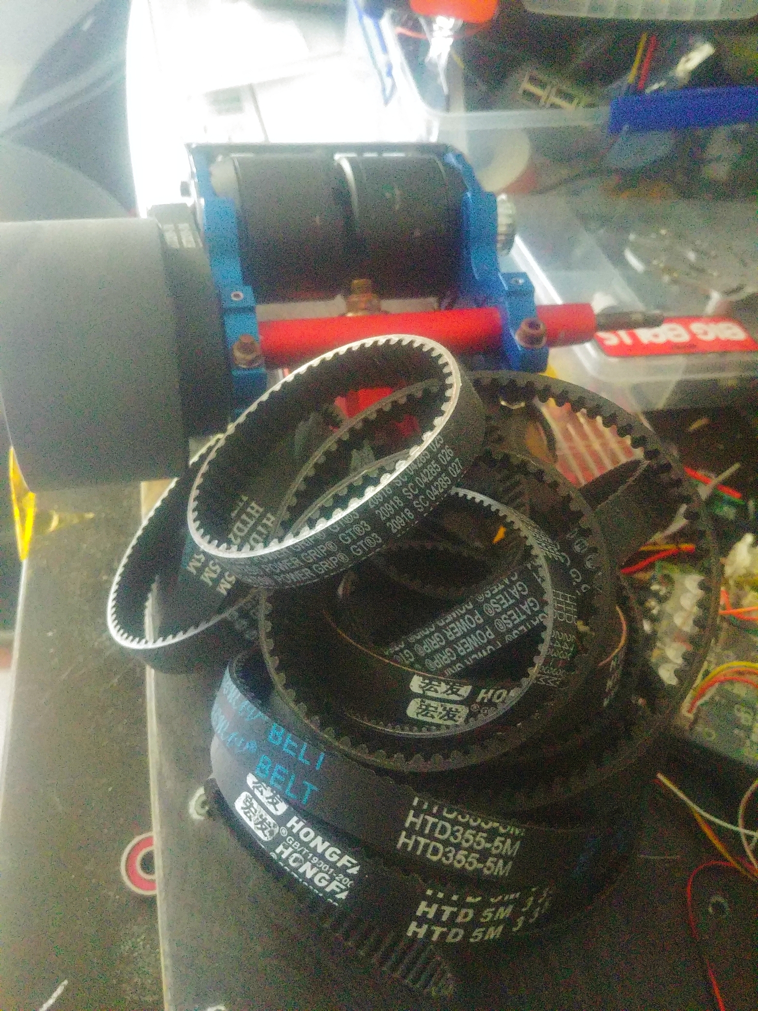

Current gen Flipsky 6355 are good but not perfect, i have 8 of them in total and only issues with one. And that could because I dropped it on concrete. They are cheap and easy to fix. My next build I will use maytech I need more power and had too many problems witg flipsky 6374 these are the bad apple in my opinion. The 55 can be a tight on caliber Ii see my short build in progess the is about 2mm between the motors.

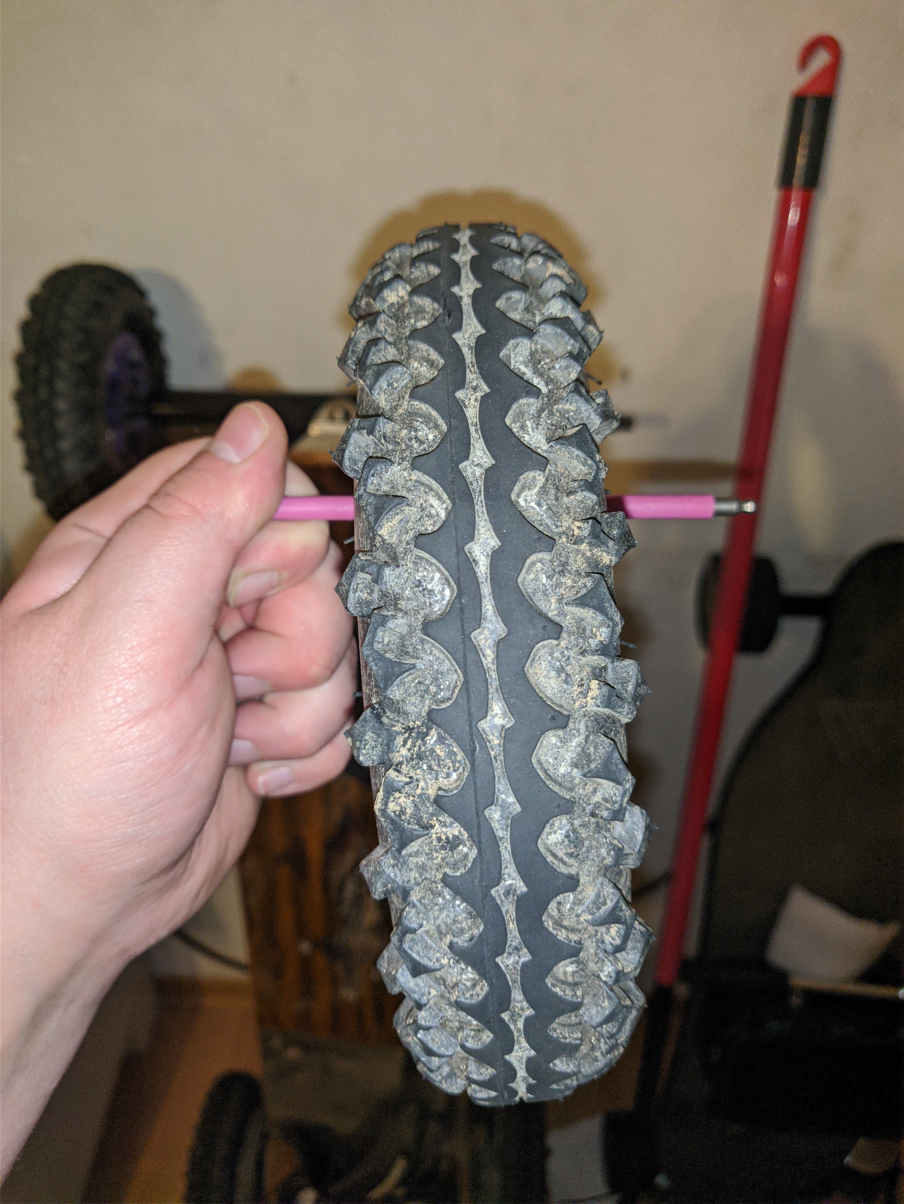

Might have found one of the reasons. The wheels i got seem to be crooked. They have the right bead, but the bead is higher on one side than the other. If i put the tire on a allen key, you can clearly see that it hangs slanted
Edit : And sure enough, the hubs itself wobble…
Just sent another mail to mbs with the new Infos. Last one was 3 ago, haven’t heard back yet.
thanks for the feedback. so you reckon a Maytech verison of the same Flipsky 6355 is likley to more powerful? interesting, i thought they would be more or less the same. also, what width belts are you using with that build?

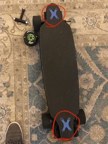

Another noob question:
What are those X things I see on a lot of builds?
X things :rofl: that is what they are called. A few people make them but the ones that stand out the most a @akhlut ones that can be found here
Stuff Akhlut makes

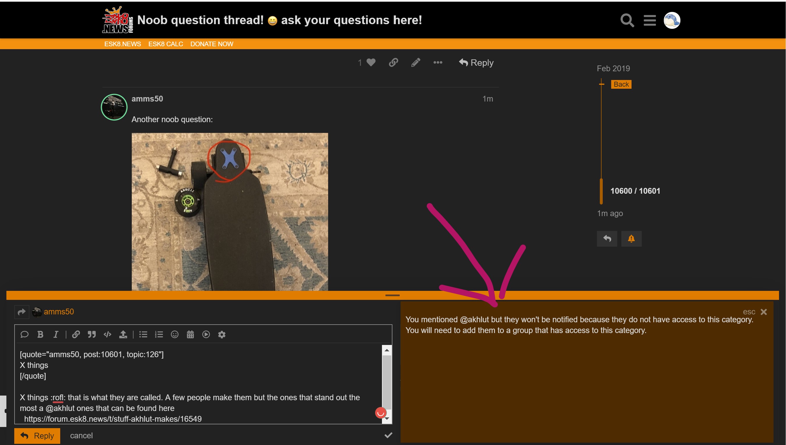

@Zach /mods there seems to be a problem ( unrelated to noob question thread so will delete this post once sorted)
When i mentioned @akhlut above this message comes up
That is not quite normal is it?
Yea but what’s their function?
to avoid the srews digging into/damaging the deck. and to add style :sunglasses:
Luckily I’ve got a drop through deck so no worries :sunglasses:
Then you need them even more. I wouldn’t have a dropthrough without a top plate or X protectors.
Don’t worry I have a drop through deck with evolve supercarve trucks
gotcha
I CANT STOP LAUGHING HAHAHAHA
Yea man they were the only option cuz any other truck on the switchblade will wheel bite unless you drill new holes and I don’t wanna hurt my switchbaby :pleading_face:
