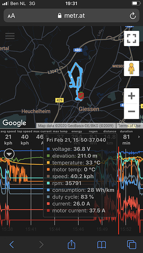

Does it feel like you are bouncing off of a certain max speed? My guess is still max erpm if thatā€™s the case.

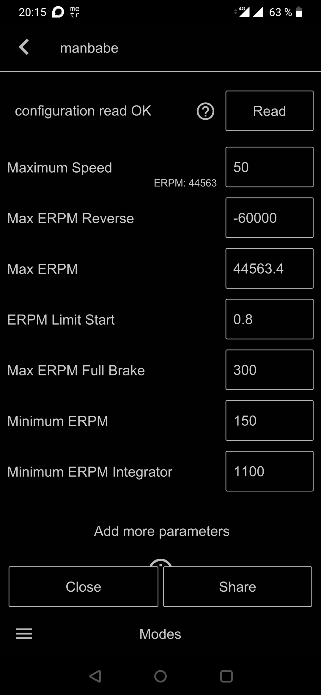

Here are my settings. Can you send me yours?
I notice youā€™re hitting a max speed of 40 it seems and your erpm is not going any higher than 357xx.

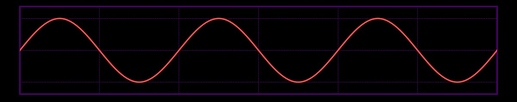

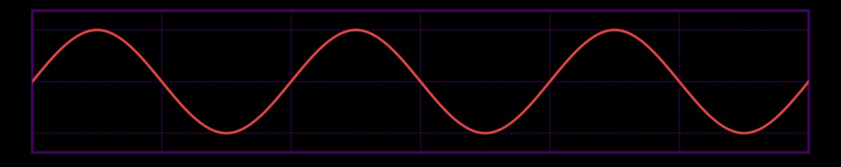

Or the feeling of riding on a slope or sine wave. Just a bit quicket and not that extreme.
The max 40.2 is just where i stopped because i didnā€™t know what it was, i could probably squeeze some more out of it.

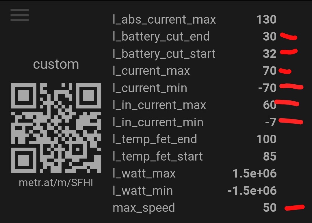

Here are my current settings i use in metr. Everything with red is what i work with, the rest came with creating a new mode. Rest of the board ist stock from Motor detection.

What youā€™re describing is the exact effect of hitting a set erpm limit.

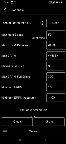

In the mode, add the erpm table and check the value.
This is everything related to erpm i think.

Yeah doesnā€™t look like erpm limit. Any chance itā€™s only applying these settings to one esc?
