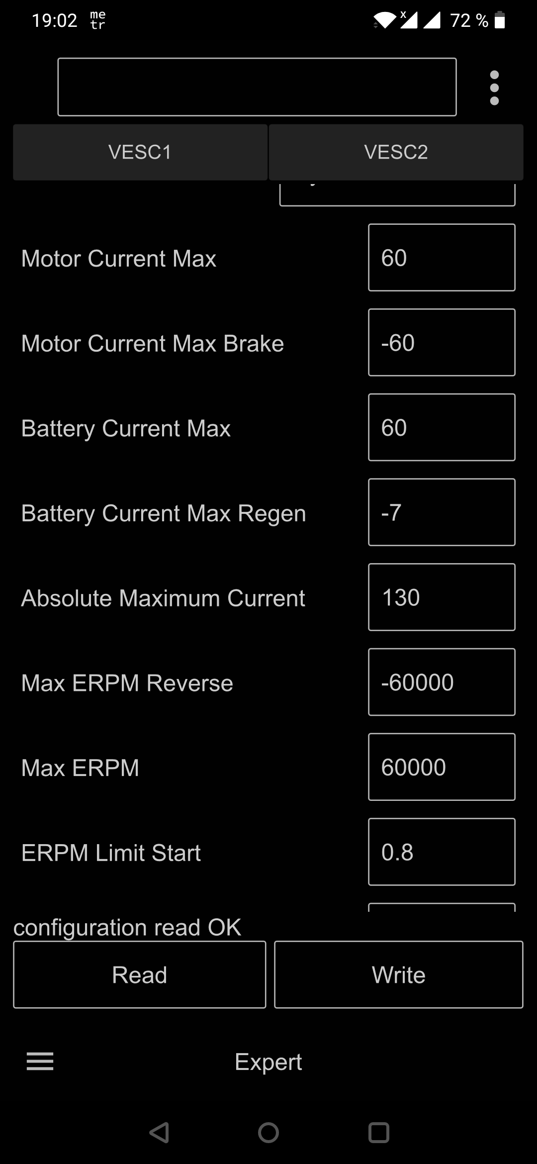

I don’t remember where I heard this and I think some more experience builders/riders can speak to this but I remember hearing that the vesc inherently has poor braking at low speeds but better braking at high speeds however it seems like our experience is the exact opposite lol
What vesc are you using? I’m using a dual vesc from esk8supplies

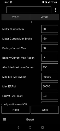

Was this your max speed full throttle?
Check your erpm limit. You might be hitting it and should increase it.
You can increase braking by decreasing motor min from -60 to eg -80.
Batt min will effect high speed braking. Motor min will affect low speed braking.
Also if you are riding direct drive I’d recommend current app settings instead of current with reverse since it will improve braking.

Never went that far while riding.
ERPM is 44563 (max speed is set at 50km/h) but i’m 10-15km/h below that.
Motor current max is 70a
Battery max 60a
Drive system is Belt 15/72
banding happened roughly between15:50 and 15:51 o’clock

Your throttle curve and ramping has nothing to do with it. High speed braking is more affected by adjusting regen, low speed by motor brake current. For a smoother transition either increase regen if possible, or lower motor brake current.
Let me check but brake regen is just -7
