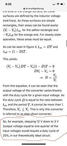

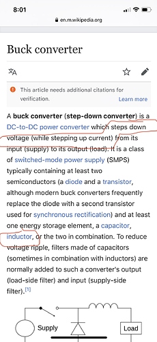

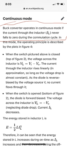

@drone001 the motor is the inductor that stores the energy as a magnetic field which allows the motor current to flow during the times the battery is disconnected from the circuit:
^you can see in the above diagram that since the current is flowing through the motor all the time, and from the battery only sometimes, the average current through the motor is higher than what is drawn from the battery (but at a lower voltage than the battery voltage depending on the % of time or duty cycle % that current is drawn from the battery ā€” %50 duty means 50% battery voltage)
by varying the duty cycle, the motor current is controlled. the duty cycle required for a given motor current also depends on the speed of the rotor because the spinning magnets also produce a back emf voltage that works against the effective voltage, which is why constant motor current requires higher and higher duty cycle at higher and higher speeds. eventually you get to 100% duty (or 95% with vesc) which is full battery voltage and the rotor is turning its no load speed which means the back emf voltage nearly equals the battery voltage, so the motor canā€™t turn any faster and almost no current is flowing through the motor (only enough to overcome the bearing resistance). the motor canā€™t technically turn no load speed on its own because youā€™d have to spin it just a little bit faster with outside energy (to overcome the bearing resistance) to bring the motor current completely down to 0 which is true no load speed.
