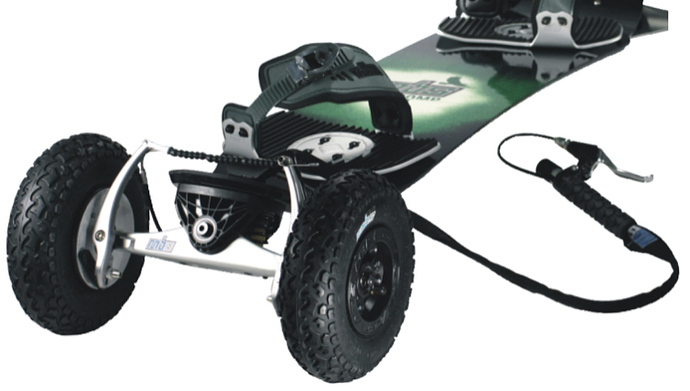

Ok, I was just thinking … and please tell me your thoughts about this.
I’m always a bit worried my brakes will fail on me when I need them the most. Like when you need to brake really really hard … so I thought
WHY NOT INSTALL A SECOND BRAKE, A HARDWARE BRAKE LIKE MOUNTAINBOARDS HAVE?!
please tell me why not? Like MBS V5 BRAKES
