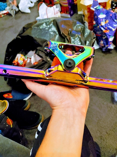

@Trampa Can you tell me how your Barrels compare to the MBS Shockblocks (Red) in terms of hardness and ability to turn?
Also What Damper is equivalent or a bit harder than the RED shockblock?

As much as i love the looks on the mbs (note i have never tried either) but trampa wins in aesthetics for me especially with all the different colours. And the important thing for me is that i can use etoxx elsatomere dampeners that really make the whole ride nicer.
Of course this becomes expensive for not a whole lot of difference so mbs might win on an overall basis
Even my cool neochrome ones?
Nah they look awesome but they don’t fit every style :wink:
