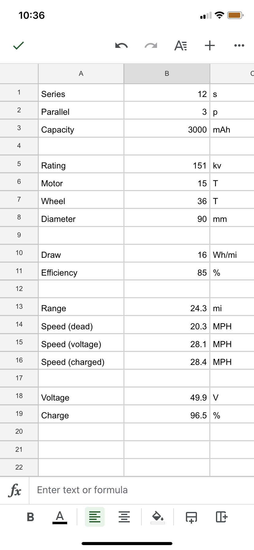

Always FOC, since I only run FOC on my boards wouldn’t it be more relevant than a ‘real kv’ still? Like if the motors clock in at 151kv when benched, they’d behave like 151kv motors on the road?
@ZachTetra FOC is limited to a sinusoidal waveform, so the motor only sees the full battery voltage at the peak of the waveform, which means in FOC the max RMS voltage the motor sees is significantly less than the battery voltage…
in BLDC, the motor can receive 95% of the battery voltage because the vesc maxes out at 95% duty… so even in BLDC mode on a vesc, the no load speed would measure at least 5% lower than the true KV value.
FOC will measure significantly below the true KV value.
The best way to measure is use a controller that can do 100% duty cycle in BLDC mode, and then spin the motor faster than it will turn on its own at no load, and when the motor current reads 0 amps, that is the no load speed. it is the speed at which the back emf voltage generated by the motor equals the applied voltage from the battery.
@Dareno
no because the torque per amp depends entirely on the actual KV. so if you are estimating your torque per amp based on an under-inflated KV value, you will predict that you have more available torque per amp than you actually have.
If I just want to know the speed, is it correct? This is the personal calculator I use for all my boards
