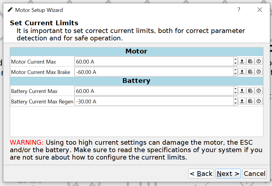

Does this regen seem ok, is there any risk that it would be able to overcharge the battery if I’m going down hill and breaking alot?
I ask as I checked voltage after a ride and before the ride it was 38v and after it’s 41v surprised at how much it recharged
The regen current ā€œsafe limitā€ is dependent on the battery pack you have. With those 5Ah Turnigy packs you’re using, the maximum allowable charge rate is 5C, which is five times the capacity. 5 times 5Ah is 25A, so that’s what I’d set your max. regen to.
When going down a long hill with a mostly full battery, if the battery reaches ā€œfullā€ due to regen, the vesc will stop putting more current into the battery to protect it. This has the unfortunate side effect of the board losing all brakes, as the braking energy has nowhere to go.
Moral of the story is, don’t go down hills with a full battery.
Thanks man will change that, very scary to lose brakes on the hills I am going down!
Agree there. I live on a hill, so I learned that the hard and scary way.
