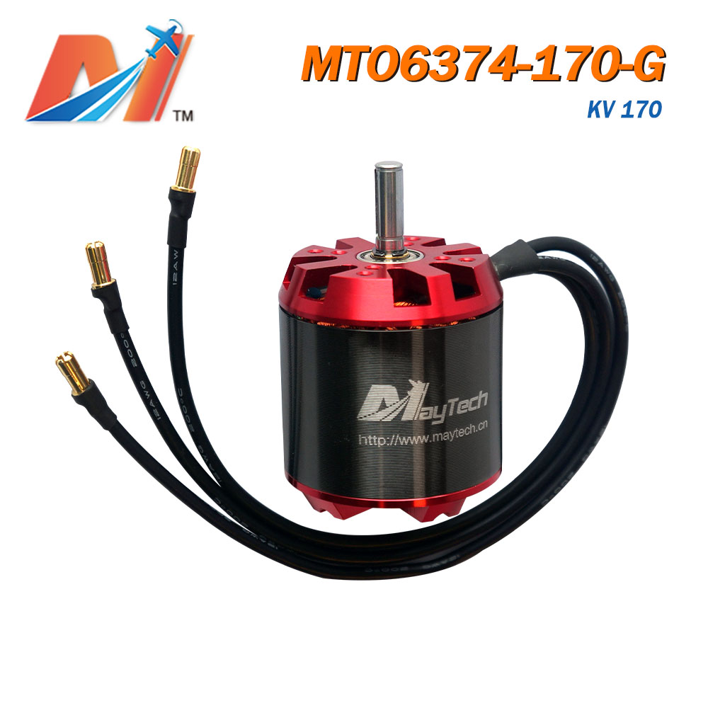

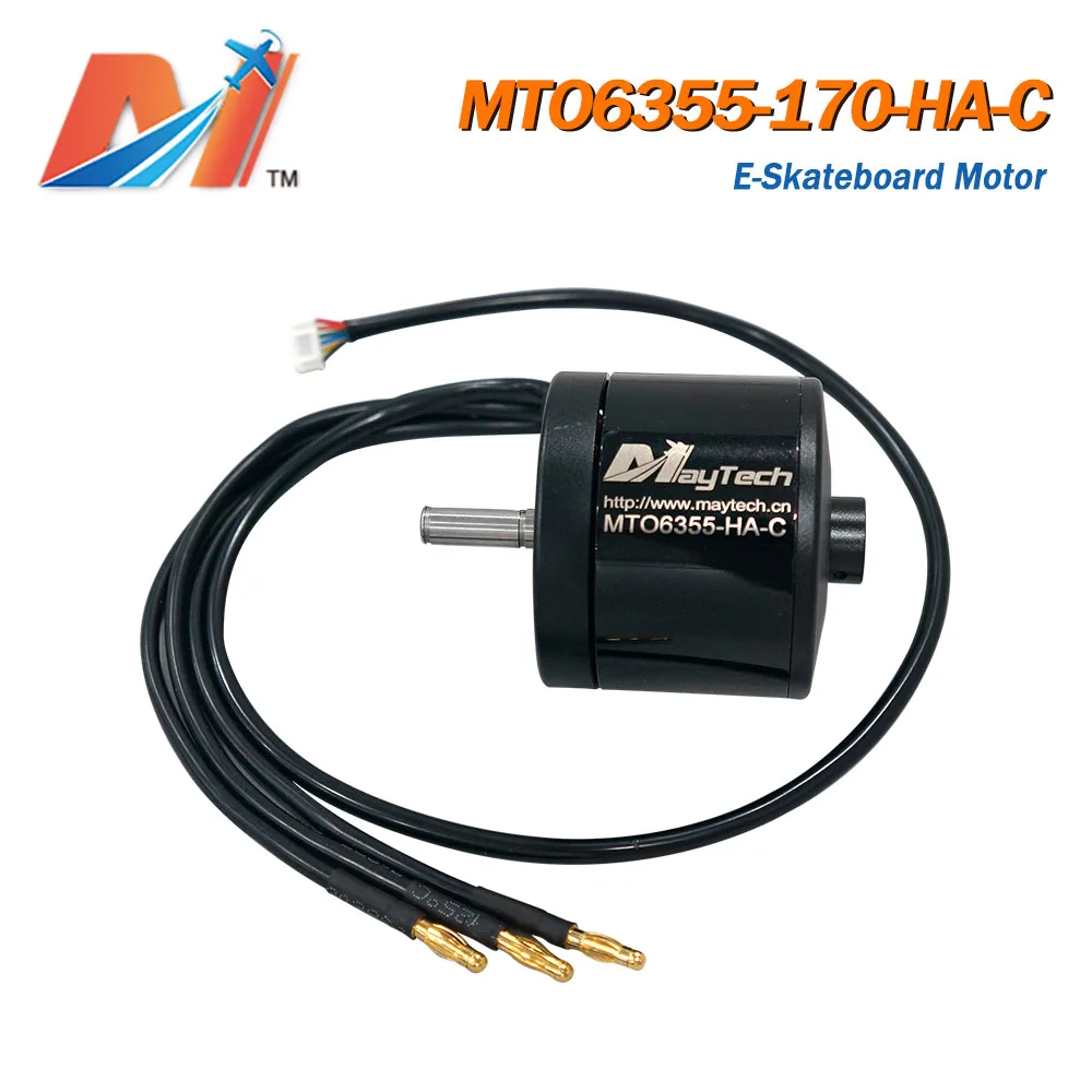

in a constellation like this, my motor right now is 170kv 6355,
how does it come into play if i change it for a 170kv 6369 motor ?
obviously it will be more torquey, but would someone mind enlightening me what exactly is happening ?
yep because it will have more wire coil and also more W possibly. It will also in theory have better heat dissipation. other than the above and the size difference then nothing much :smiley:

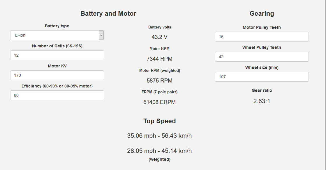

so its not going to change top speed or anything like that ?
that surprises me and shows i have no clue :joy:
edit: i was thinking it would have something to do with the “motor efficiency” option in the calculator, but if its not that either, im baffled ^^

okay, so currently feel that with slight resistance (wind) or inclines i dont reach as much topspeed as i would on flat, this is where the bigger motor with same kv would help reaching my calculated topspeed more easily , is this what it means ?
In theory yes, but the important things to look at is motor W

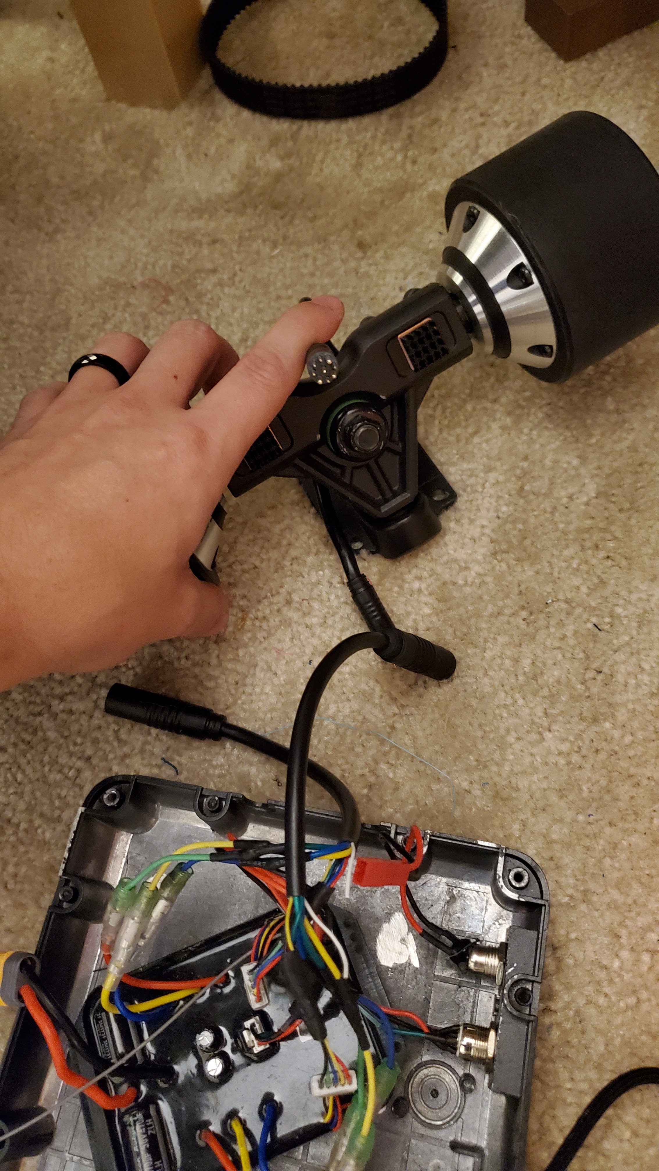

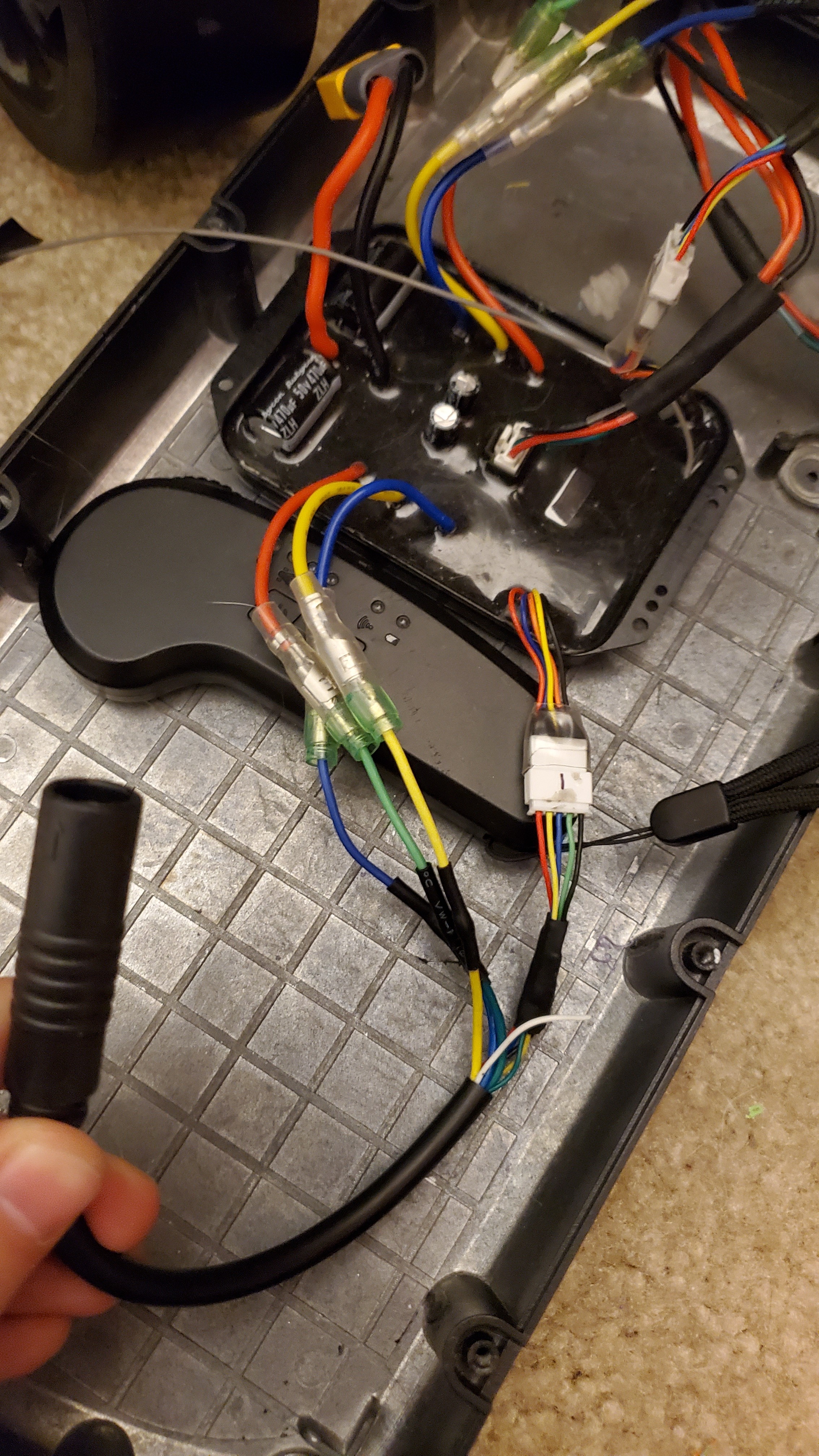

I have some spare hubs laying around that have a 9 pin higo connector on them
Looks like 3 phase wires and unsensored 5 pin with an unused white temp wire but I’ve never used hubs before and am technically a noob at them.
Can I just snip, crimp, apply the correct terminals and throw a better esc(s) in there if this one doesn’t meet my standards?

ok so i just figured the bigger motors im talkin about are actually 6374 and not 6369, and sport 500w less peak performance than my (same brand) 6355… not worth the exchange on my current setup i would assume
edit: atleast asking stupid questions leads to more knowledge :joy:
Careful with watt ratings on motors. They’re more of a safety limit than power level.
Motors are very dumb devices. They will take whatever you throw at them until they melt. You can even over or under volt your motors and have lots of fun until they melt (over bolting).
The larger motor cans dissipate heat faster so they can handle larger amp draws before getting into a danger zone.
Remember,
Power = Current x Volts
You don’t “get” more power by having a larger motor rated for the same kvs. You can just handle it better and therefore throw more current at them before they overheat.
Would it still be possible to do some decent trail riding/light offroad on 170kv motors on 1:3 gear ratio on 175mm pneimatics, or is the ratio/kv too small?
these are the 2 motors in question @Venom121212 @PixelatedPolyeurthan
do you see an advantage of the 6374 over the 6355 ?
i would assume that if your calculated topspeed is around 45km/h with those motors and 12s, there should be some torque / braking performance left, but im just talking out of my ass here
if thats still desirable in efficiency and if that kind of reduction is even possible - no idea
