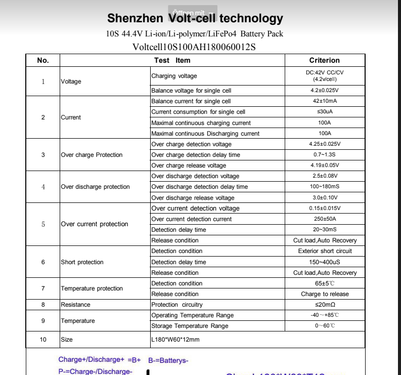

I would say that drift doesn’t look great, but it’s also not indicative of something like a cell failure.
You’re using an active balance charger already? Do they balance okay at full charge?
I swapped it for a new bms, that Baja sended to a friend of mine, before I picked it up four weeks ago. Now it runs on the new bms. The battery had a huge drift then.
The fact that this is a fairly new battery + you’re using an active balance charger is somewhat concerning.
Is the drift there every single time you discharge? And doing full discharge/charge cycles doesn’t lower the delta?

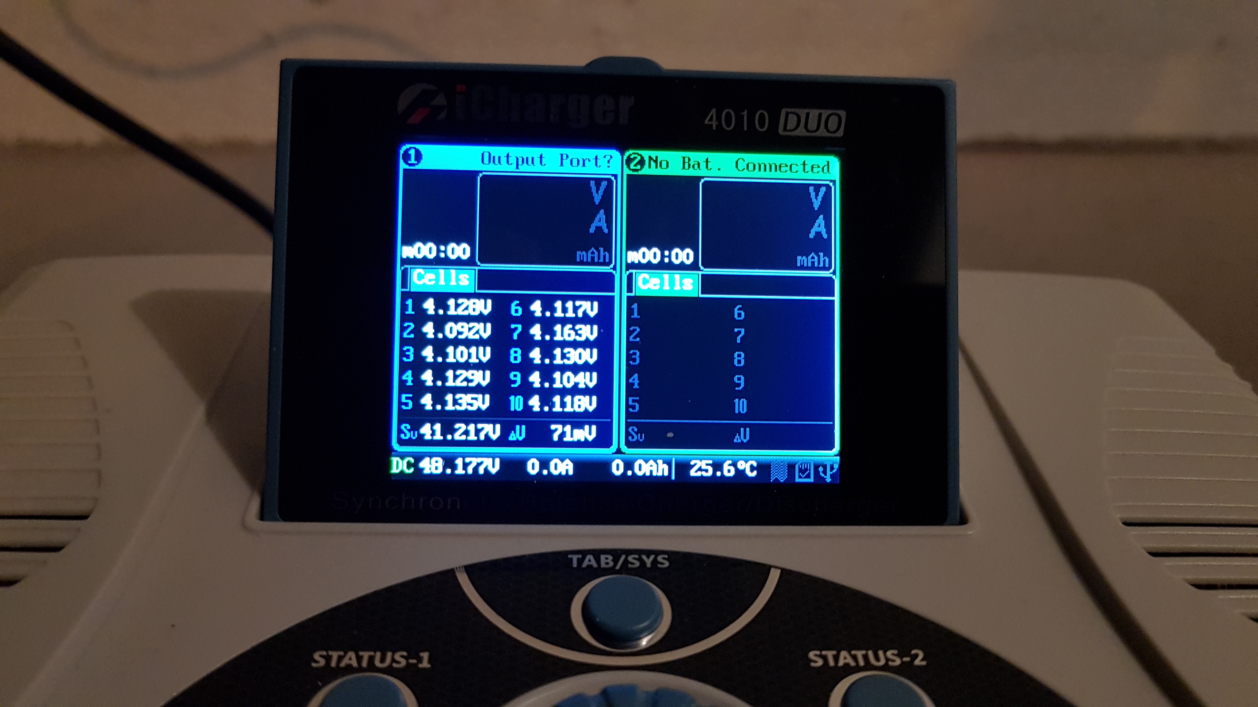

That is the result after charging it up.
Does it go into a balance mode if you leave it plugged in at full?
I’m not familiar with the charger you’re using. It looks like it’s not doing a great job at the top off balance though.
I have it charged up with the normal charger, because I want to see the behavior from bms balancer. This charger in the pic is beefy. It does a great balance job.

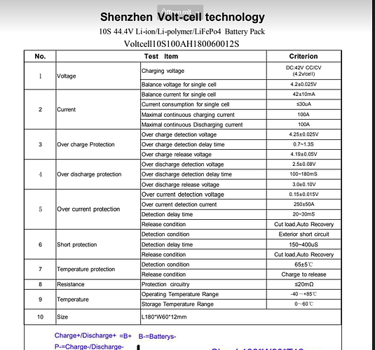

Here the datasheet.(I charged it not with the hobby charger.)
43mA balancing current from the bms vs. the 1.2A from the hobby charger.
The iCharger has a balance only function and it can shot 40 amps in asynchronous and 70 synchronous mode.
