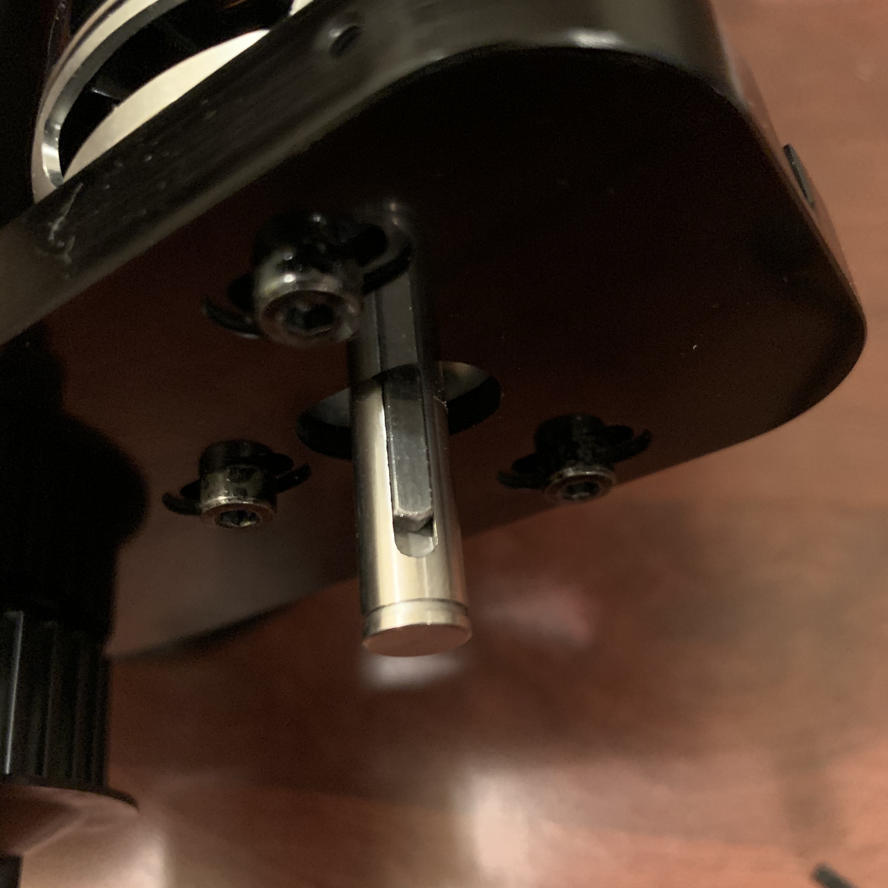

I have one keyway that fits snug and one thats a lil short ( cut too short) would this affect it in anyway?
No, other maybe a bit of noise if you don’t glue, no issue. It’s only purpose is to lock the pulley to the shaft.
Im just joking. I like Trampa wheels, for what they are they are useful.
Use a drop of super glue on both the key slot and key, you’ll likely never have an issue.

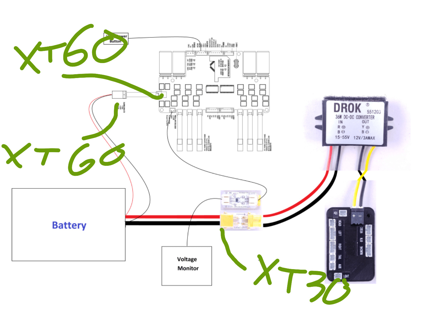

Advice requested:
Need a good way to make an xt60 to xt60 & xt30 parallel connector.
Battery out is xt60, unity in is xt60, lighting controller in is xt30.
Someone please draw me the easiest way to do this.
