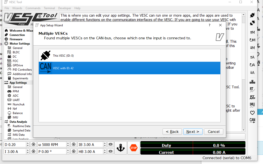

Ok when i pull the loop key out after binding it the blue light turns off forever?
Then on other vesc I try it and the blue light does what its supposed to do but motor doesn’t move at all?
Ill try that now… ya even though that says " * Hold the “bind button” on the transmitter.
THEN Turn the transmitter on" which is different from video, still same. one transmitter light shuts off other looks like its connected but nothing happens when trigger is pulled

This is the exact behaviour of a receiver that is broken.
If it only works when the loop is inserted, I don’t know why but I’ve had a couple like that before. I ended up just using different ones. Never figured it out.
well that stinks…
Ok so the one that stays light up wont move the motor, but i moved to to the other vesc which had the other reciever and that motor spins perfect.
So why does it work on one but not the other … and the can bus is connected so how come both motors wont spin anyways?
Have you done the setup to allow the master to send data/signals to the slave?
I think i just need to start over on vesc, i dont remember that part

Now its showing me this bs even though usb is connecting.
still only one motor will spin with remote. I can get the other to spin while testing in vesc but i can’t get them to even recognize the vesc now wtf

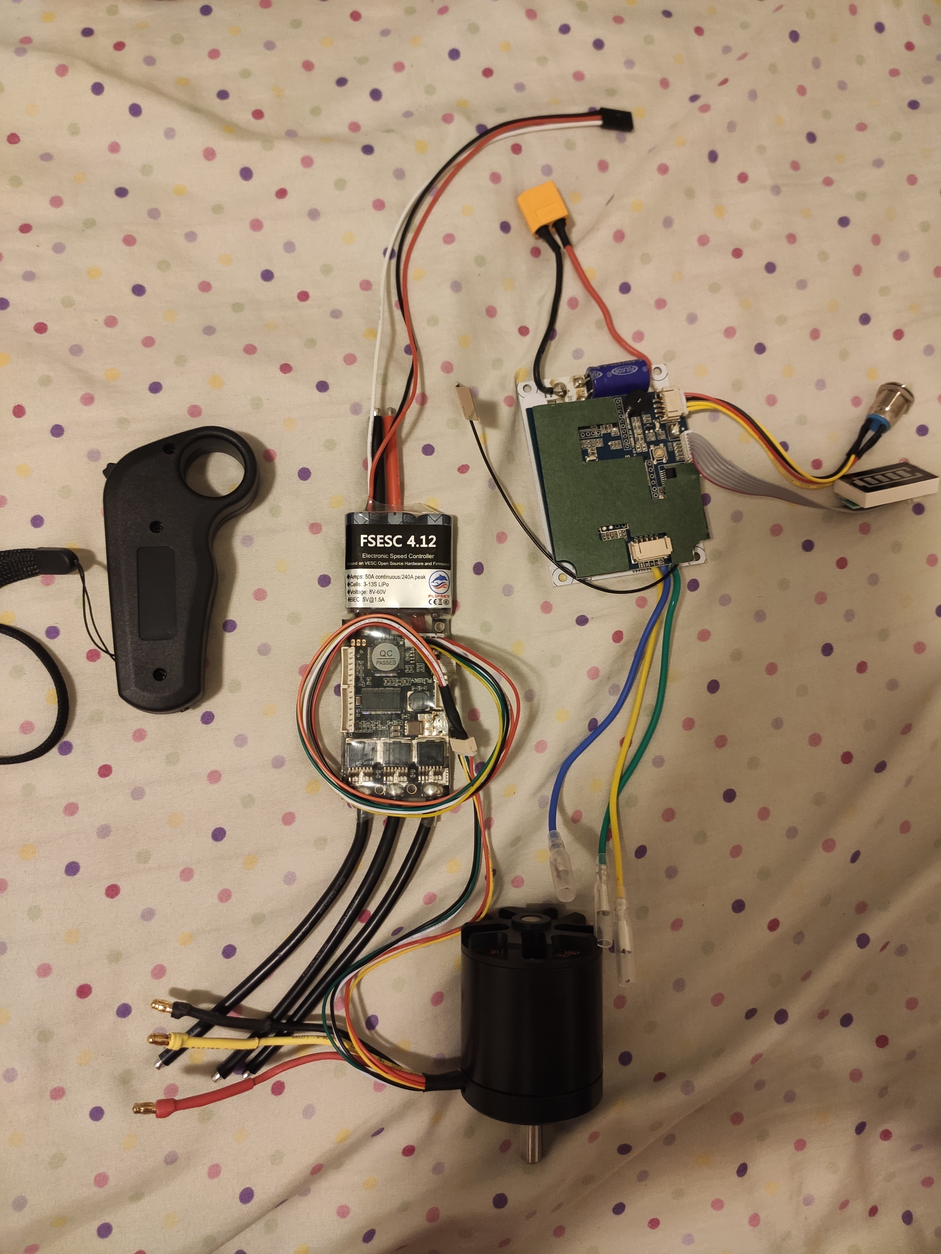

Someone can help me to connect fsesc and motor wifi a controller board?
Your request is super vague, care to elaborate?
We need more info here. What exactly are you trying to accomplish? You’re gonna need to solder some connectors on that fsesc4.12 so you can power it on first of all…
I have a fsesc to connect in a motor, and bought a board wifi controller to control a skate, but I dobto know where do a connection
It seems you may need to do some more reading. what controller?
I bought on this page in aliexpress
Electric Skateboard Controller Skateboard Driver Board Single-Drive External Sensing Hub Motor Board
https://s.click.aliexpress.com/e/qlwYQR0U
Yeah, like Ryansintra said, you need to read more.
Tell you what: take separate pictures of each item and I’ll give you a quick connector lowdown on each photo/item. Two of your items have the same purpose, BTW.
But first, do you know how to solder fairly well?
You will have to be much more specific about what you want/need.
