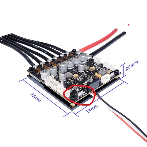

I changed between 4 different cables and tried the different coms thing. Is this is the correct port im supposed to connect to on the flipsky dual 6.6 plus right?
its sowing up in the devices area

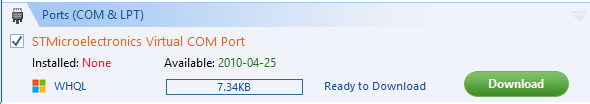

http://www.driverscape.com/download/stmicroelectronics-virtual-com-port
This was suggested to me before. It didn’t work on Win7, but I never tried it on Win10 because my issues were solved by then.
3423423
seems like im missing something but I have to pay/register to download this thing?
