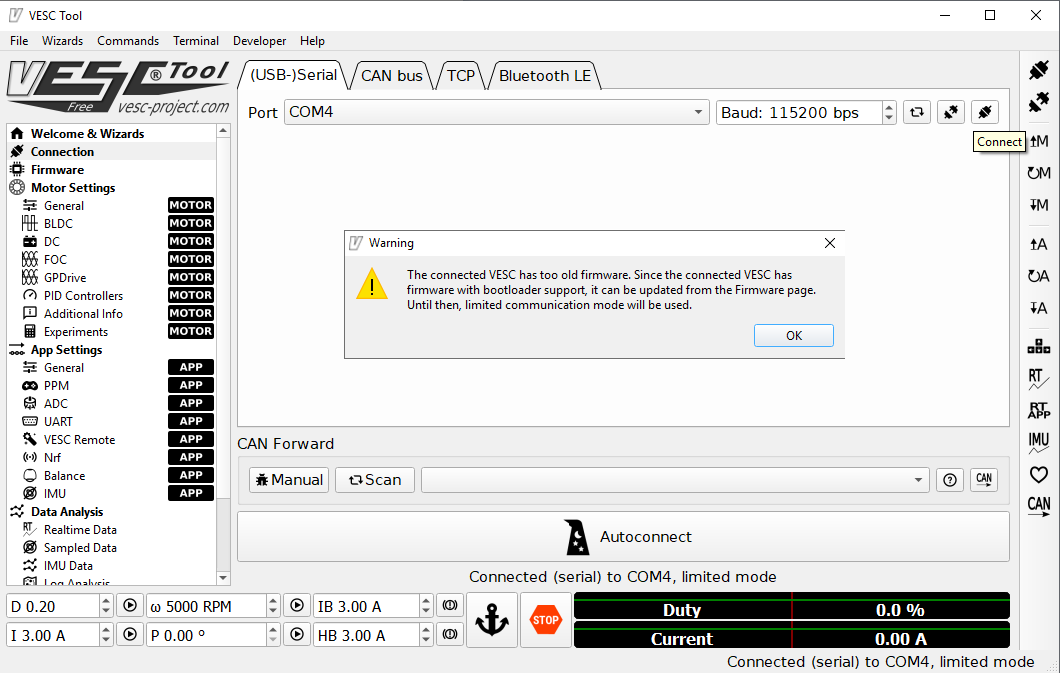

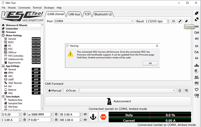

So I tried once again. Auto connect wouldn’t work but When I put to com 4 and clicked connect in the top right this happend.
That’s good, actually.
Click that away and go to Firmware.
Im following you
Because it’s reading the vesc now.

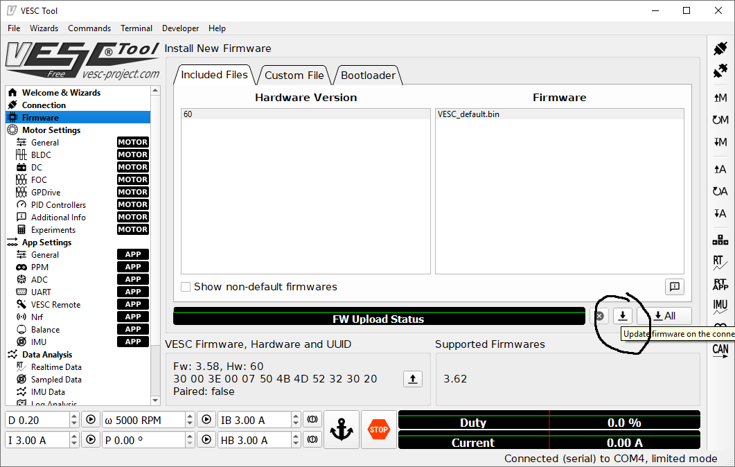

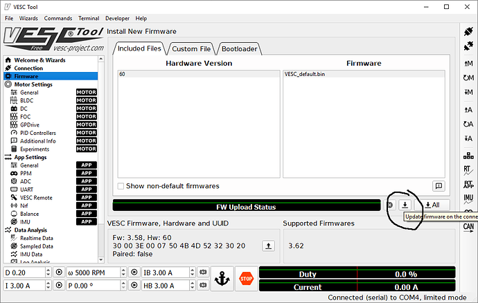

Do I then click this on firmware page?
Yes. 10chars.
Really important that once the green bar finishes, you don’t unplug or do anything for 10-15 seconds while it writes and reboots.
Yep ive clicked it and it was done like 30secounds ago should be all good now?
Do I just turn off esc and then disconnect the usb cable and turn on esc then connect cable or?
No, should be good to go after reboot.
