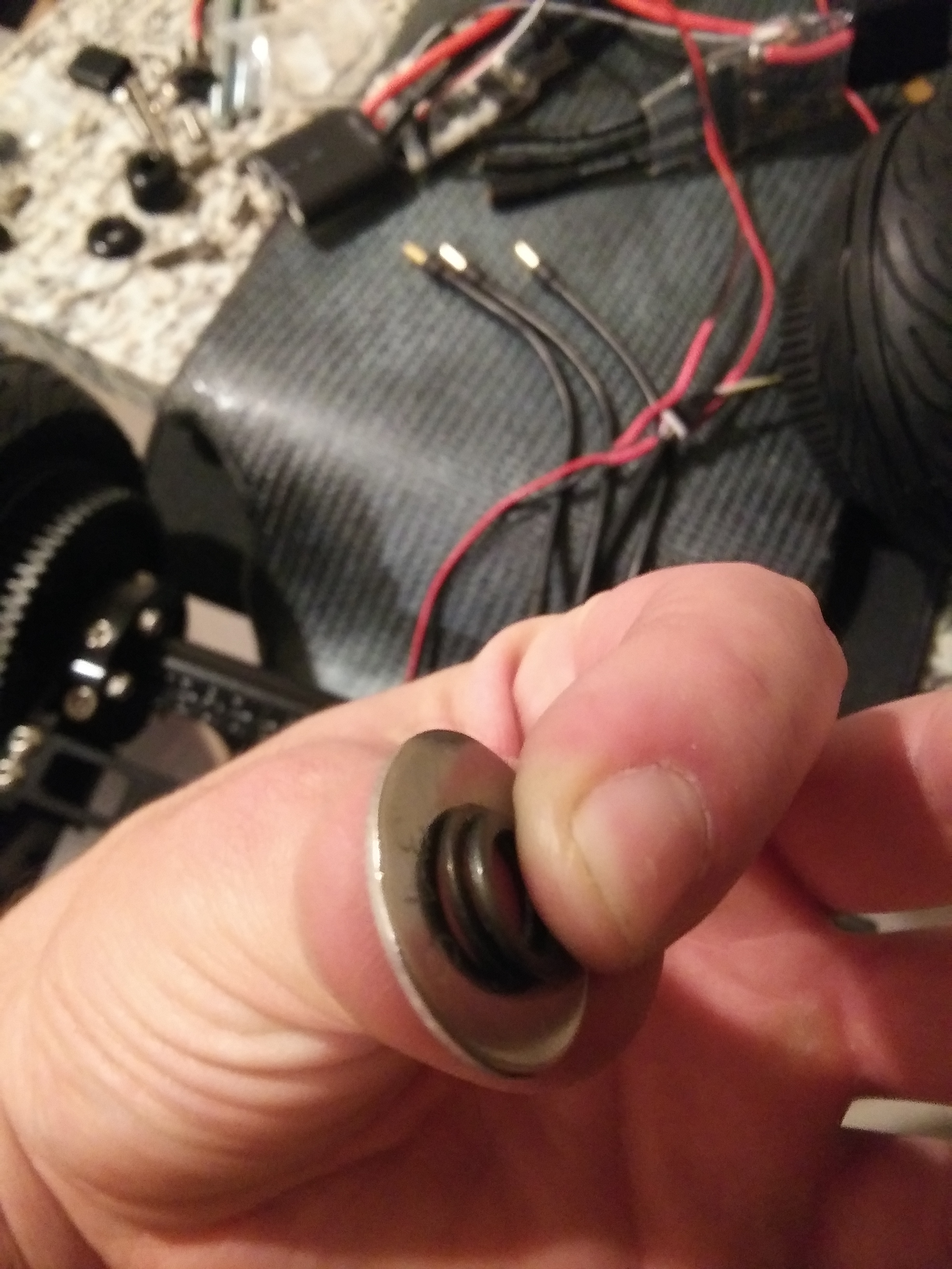

Can I use this big of a washer as a spacer ? The ones included are to wide and with no spacer its to close also I have a center support bracket so I cant move mount
Also found the other set screws they were in the first box not the truck box
So I’m guessing that wont work they included some nice ones but they are to big. I’ll wizzerwheel them in half tomorrow that should do the trick

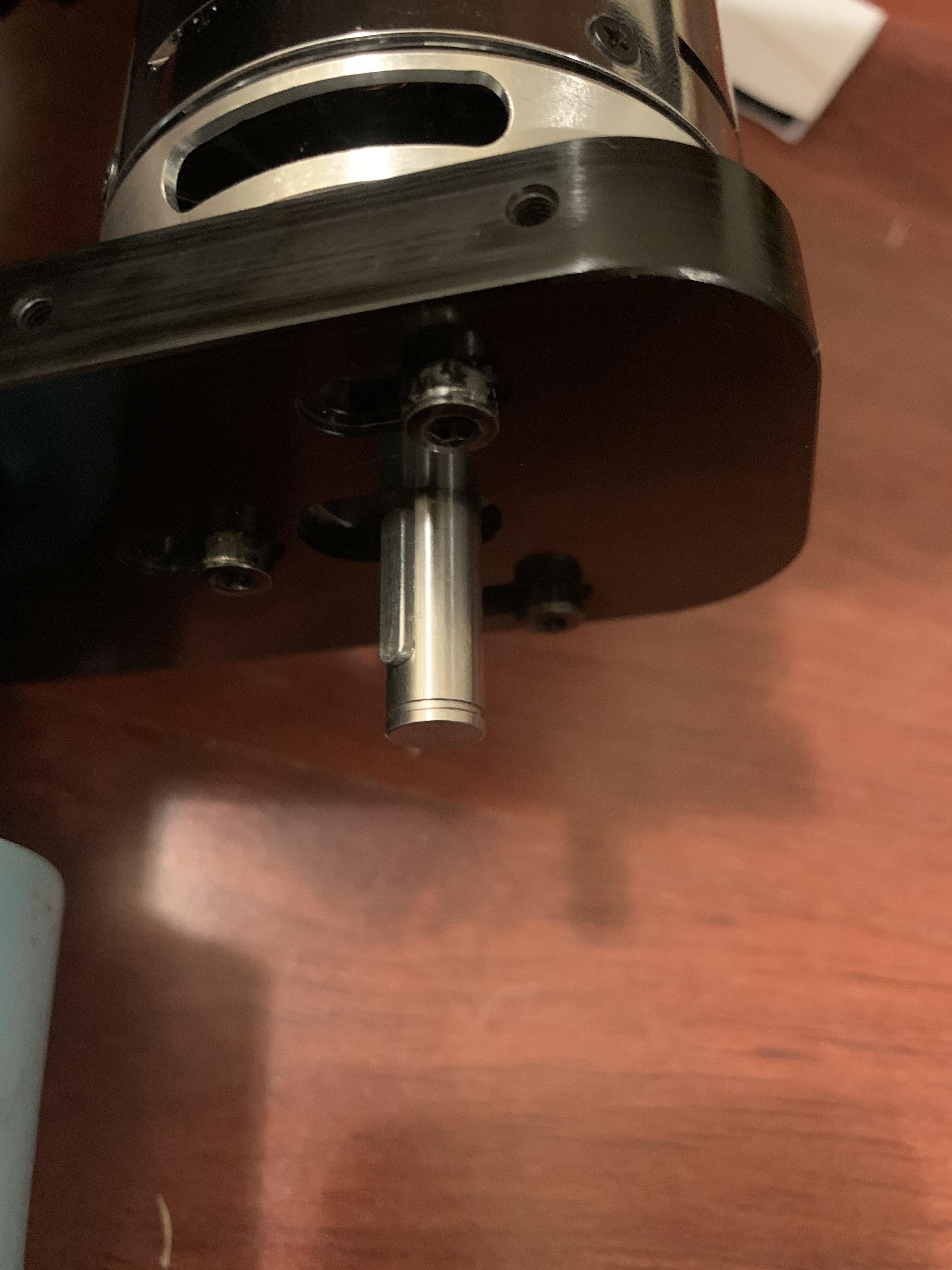

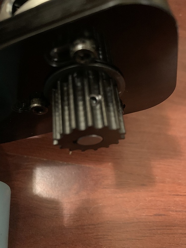

Wondering on how to place motor pulley onto motor shaft with key way and if I have to file down anything or just put some loctie onto the screws?
Loks good so far. When you are ready to secure the pulley put a drop of blue loctite on each of the grub screws and tighten down. I would suggest waiting until you have your belt aligned.
Thank you. Was unsure if I was doing it right.
Will align the belt now :slight_smile:
I typically over-tighten grub screws to my detriment, tighten them enough to get a secure hold but not too much, the loctite will do the job for you. Also, I typically don’t apply loctite until I’m sure everything is correct, short test ride included.
I’m not saying you should do this, it’s just what I do.
