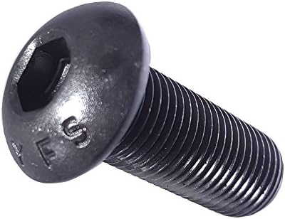

damn it just got my trucks but they didn’t come with bolts, anyone know the exact size I need to order?
What would be best to use to keep the motor cables down and in place? Silicon or some hot glue?
No sure either would hold them but hotglue would be my choice.
10-32
Size depends on what thickness.
Either M5, or 10-32 if you’re going with FUB. Length depends on your board, and whether you’re using X things. Head style also depends on your exact setup too.
I recommend high-strength (Grade 5 or 8 if FUB, class 10.9 or 12.9 if metric), and hex/torx drive instead of phillips.

#10-32
either in 2"
or 2.5" (get this if unsure)

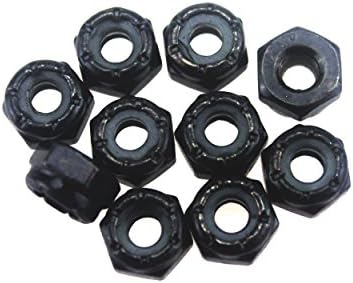

and you need some nuts, nyloc only
and I recommend having these on-hand
