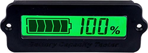

I have this battery meter. When I turn on my board it shows voltage counting up and then it shows 0% and the backlight turns off and the battery icon flashes. Its set to the battery I have. Any ideas?
Some battery meters have settings for that where you can set how long it displays, swap between Voltage and Percent for example. Mine shows a battery Icon with different parts filled depending on what setting i choose.
I took a quick video of what happens. https://ufile.io/h73f4x72 That might make my issue a little more clear. I double checked and the tester is set to the correct battery type
That looks broken or something. I would contact the seller
