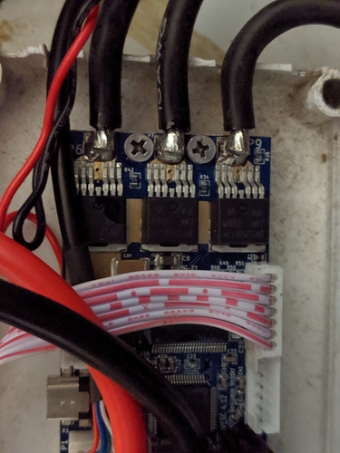

@wafflejock dont have any black lights but cool to know that it allows to see
Edit: oh wait you meant the actual baby…nah that’s just my hand
You can put it in direct sunlight if you don’t have a blacklight.
It’s enough when water can’t touch anything except coating.
Im not trying to waterproof it. Just dont want a random cable to touch the esc, heat up to a point of opening and making contact
@Flasher If you’re using silicone wires, then if it gets hot enough to break down the insulation your board is already on fire.
If not, you should just heatshrink everything or take other steps. The conformal coating is not especially mechanically robust - it’s designed to protect against moisture, not wires.
Cool. Then I’ll leave it as is. Everything is sleeved or heatshrinked or fish papered :slight_smile:

Ah gotcha stuff I have says “contains UV tracer” just tried here and it glows white where I coated it I tried taking pics but a bit hard to see can sort of see a blob on the leftmost mosfet but for the most part I left those uncovered just coating the pins I might give it a full coat though I don’t run into thermal limits anyway (if it’s an issue imagine I can just scrape it off)
