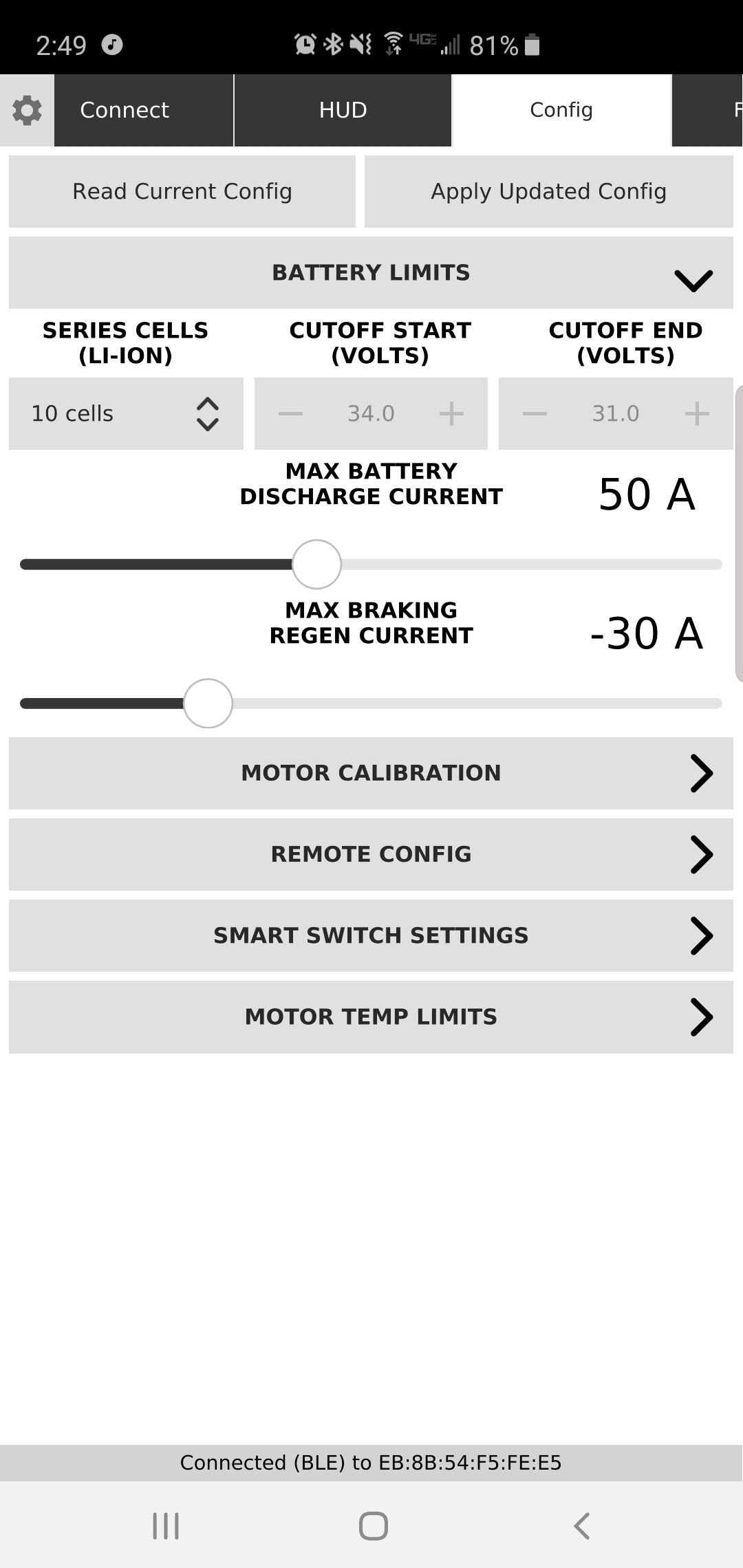

Here’s the basics of the settings
Can give you better numbers after noms
cutoff start 34V
cutoff end 31V
motor max 70A
motor min -45A
battery max 50A
battery min -20A (increase to -15A if high-speed brakes are too strong)

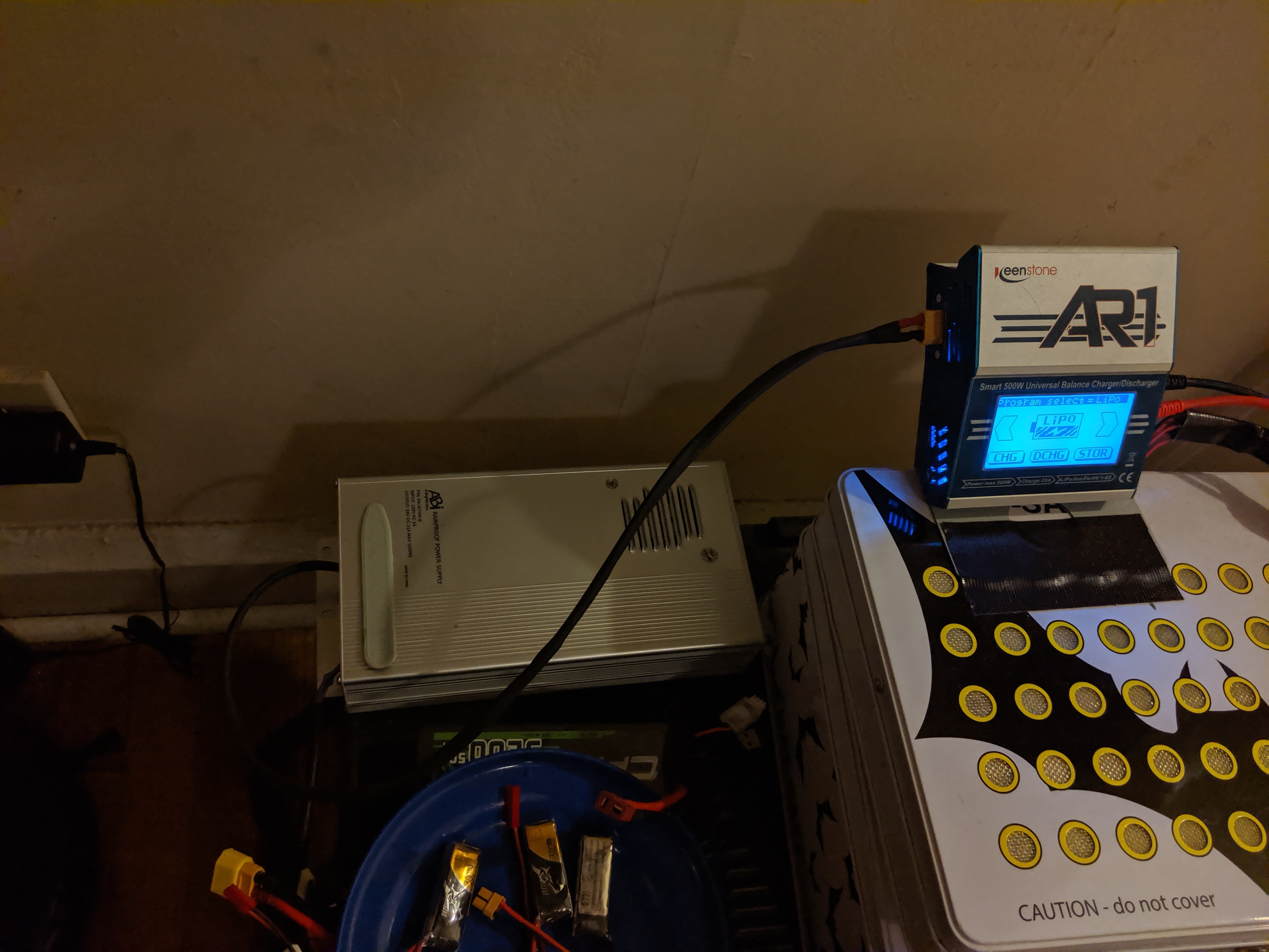

No, there are adjustable voltage and amperage chargers that will let you change how fast your battery charges or to a specific level. A popular option is to mod a Meanwell LED driver which can supply something like 42-53 volts adjustable (you change a pot) and depending on the driver itself anywhere from 1-12 amps max.
Luna E Bikes have something similar, but not for a 12s (https://lunacycle.com/luna-charger-48v-advanced-300w-ebike-charger/)
The idea is to have a single charger that you can limit the amperage of so that you can use it at a low amperage when you are at home to prolong the life of the battery, or crank it up on a group ride to charge your battery faster. I don’t care about voltage adjustments or want to splice a connector which is why I don’t want to use the Meanwell drivers

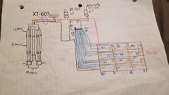

Note:
I forgot to add a 10A fuse before the charge port (on positive side, guess it doesn’t matter though) for the XT-60 6A charger.
All other wires that are black and red will be 10 AWG, that haven’t been marked with 8/12 AWG besides the wires for the volt meter, and BMS leads.
  1. Is this a correct wiring diagram, for a bypassed discharge only Bestech D140 BMS?
  2. Should I put an XT-60 or an XT-90 in the blue spot? (More so asking if an XT-60 will be fine in the blue spot since I don’t think I will be using more than 60A as a battery max setting.)

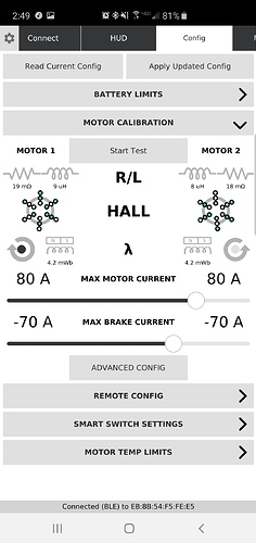

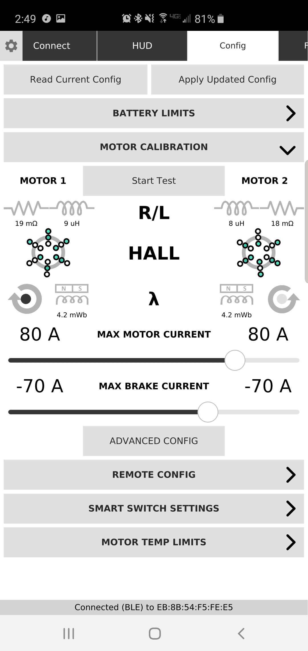

  3. What ESC settings should I use? Hardware: FLIPSKY Dual FSESC6.6 Plus, Dual TB 6380 170kv, 12s6p Samsung 30Q.
  4. Is there any way to improve this circuit, or is there anything I am missing?
Thanks!
This is okay. 8AWG is overkill for the motor phase wires. If you keep ā€œbattery maxā€ at 60A or under, or 30A + 30A for dual, then XT60 is fine.
Really? I always assumed more negative meant stronger brakes. I’ve only set between -15 & - 30 though and didn’t notice much difference.
Right so one of those power supplies you are just hooking directly to the battery positive and negative main but not hooking up the p groups or cells with balance wires? I use a ā€œLED driverā€ power supply as well but have it just for the AC->DC then use a balance charger between that and the actual battery (so it can balance charge and can control current flow etc with the balance charger).

Am extending the phase wires about ~1.5 ft, thought thicker wires would help over the long distance. 10 awg is fine for ~1.5ft? Wouldn’t 8awg perform better than 10awg?
Also would an XT-90S work in the blue spot for more amps? or are those only good for loopkeys?
more negative is stronger brakes, you are correct
